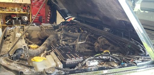

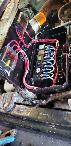

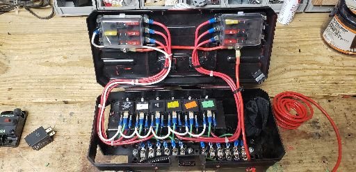

This is my weekend project. I built the relay box last weekend and started installing today. So far the install is going well. Not bad for an old tool box. It fit perfectly behind the washer reservoir on my JK. Just need to wire in one more circuit and clean up the wiring tomorrow.
DennyD
509
Windsor, WI, USA
Dennis
Dobson
22907

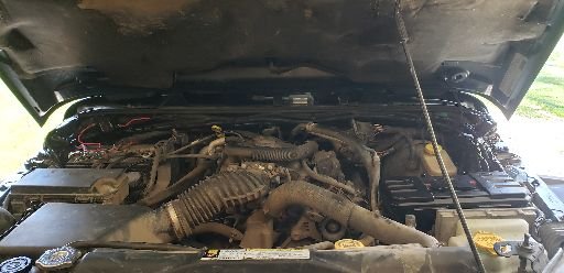

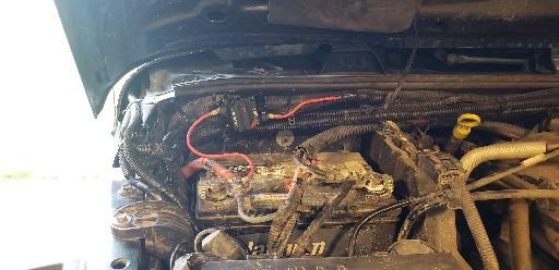

Finished product turned out pretty good. 7 accessories total. 5 are on relays and 2 on fuses. Everything going into the cab of my Jeep is a dead/grounded wire except the CB (the rear E locker is fused as well). I removed several feet of Hot wires from the cab and engine bay by "negative switching" the relays. All accessory lighting is on relays. (Pods, rock lights, amber trail lights, scene lights and KC driving lights) Still not completely happy with the amount of wires on the drivers side of the engine bay, but atleast they are seperated from my Jeep's electrical system by a 100amp breaker.
