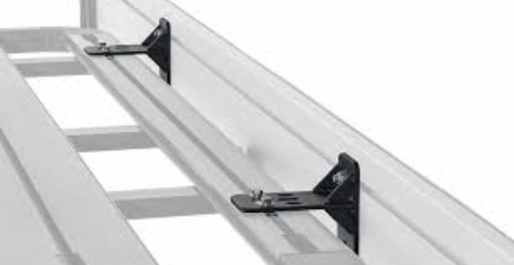

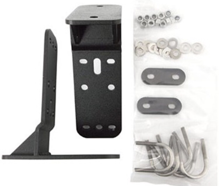

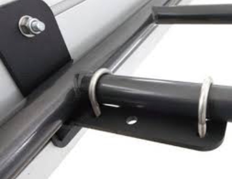

So the ones I was thinking about (I'd need these to fit an awning to my round bar rack) would look like this.
If it's a flat bar rack I guess you could use the same design but with two bolts and a piece of flat bar with a hole it each end to bridge the two (in place of the u bolts) or something like this?
Not really sure what your rack looks like so maybe someone with exact setup you have would have a better idea.
