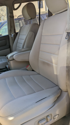

I have order seat covers from Wet Okole, and I added the seat heaters. Unfortunately they have those stupid cigarette lighter plugs on the end of each seat heater.
I have a fuse/relay block I could wire these things into and avoid the stupid cigarette plugs. Is there any reason I should not just snip the wires and run my own switches and fuses to them?

Without a doubt I would cut the 12v socket off and hardwire the seat heaters. It would be more electrically efficient hardwired than going through the 12v socket. The only caveat is you will have to remember to turn them off if the additional fuse panel is always on.

If they were mine, you bet I would hard wire them. I would also make sure the power source turned off with the ignition. Kinda suck to have a dead battery after you came back from a couple hour hike.
