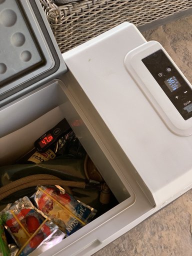

Back at home I let it sit for a few days before trying again. It gets filled with assorted bottles and cans from the beer fridge, turn it on battery mode and set temp at 36 degrees. A few hours later the screen still shows 36 degrees and only one bar of the battery has dropped (out of four), things are looking up! I decide to have a celebratory Coors and to my surprise it’s definitely not a frosty 36* beer. Instant read thermometer placed inside shows 47 degrees.
I bumped the temp setting down 10 to 26 degrees to try and bring the inside temp down accordingly but all I got for my efforts was the F5 error. Damn.
