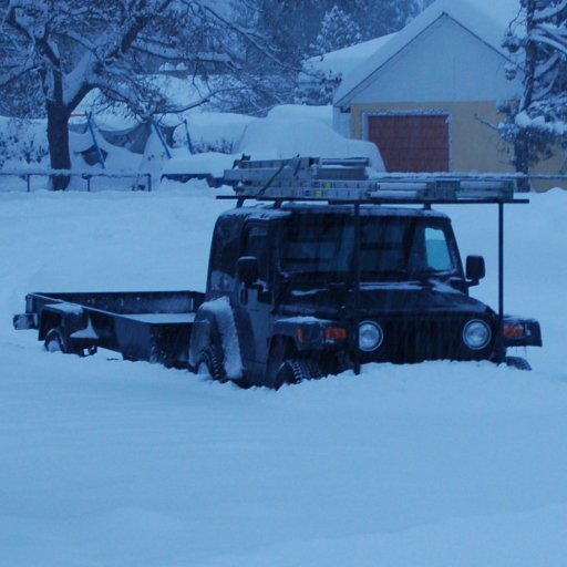

as we roll into winter, if you live in the snowbelt, nothing works as well as a dedicated snow tire.
not stuck here, I got out, took the picture, backed up 5' and kept going. Nothing works in deep snow like a winter tire.
but if you live where snow is not a factor, nothing wrong with ATs, MTs....
Unless hard rain is an issue.... the MTs are not the best choice.
ATs are good all around, if you never want to change tires as seasons change.
