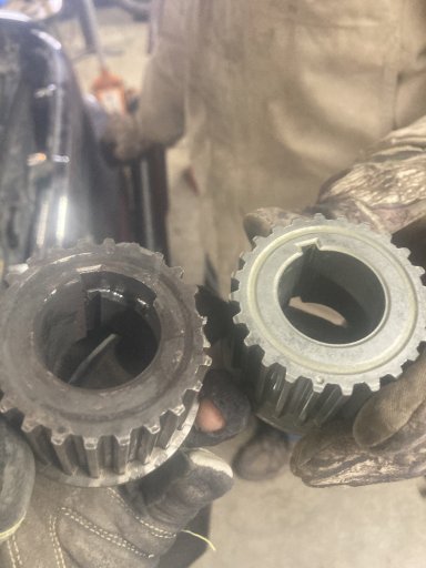

Hey everybody, thanks for the help. I got it running. It turned out to be crankshaft timing year. Kind of a crazy problem, the key that sits between the gear and main timing belt pulley had worn the groove in the keyway of the gear until it was about 40 degrees off.
No mechanic needed. Just a socket set, and a $50 part.
