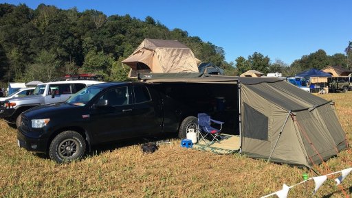

I got a killer black friday deal on a smittybilt rtt, but its definitely a 2 person tent max. Our two kids sleep in the rtt (or "the fort" as they call it) and the wife and I sleep in a foxwing awning/tagalong tent. We really enjoy this setup.
Reactions: Anders0nic
