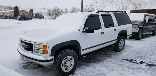

This is the Suburban I picked up this week. I had planned to start my build using a 97 Tahoe but since I plan to swap a Cummins 12v into it this summer we decided a 1500 was a no go so I went hunting for a 2500 Suburban, which took less then 12 hrs to find this one in great condition and everything works!!!! Except the tranny. Apparently the converter went out and he had it replaced but the yoyo that said he could do it had never heard that when you replace a converter you replace the front pump as well... the front pump went out within 2 hours of the converter being replaced. So in the next two weeks I will rebuild the tranny much stronger then original since it will be mated to a diesel.
I do have a question for you guys, I have done plenty of off roaring but not any overloading. I am considering an SAS on Subzilla (yes I christened her Subzilla) is an SAS necessary? Or is a lifted IFS good enough?

I would think the lifted IFS would be fine for off-roading, overlanding, trail riding, etc. The main benefit I see for going to a SAS is to better handle the weight of the 5.9 cummins. That said, I would compare the weight of the 5.9 to the 6.5 diesel that GM used in the 90s. If the weight is similar, I would think IFS would be okay. Great looking Burb!

It is a 2500 so I'm not sure the SAS would help with weight or not. Yes the 12v weighs more then the 454 in it now but its not a huge weight difference.
As I see it the only benefit I get from an SAS is articulation and maybe a better differential.

With the SAS I'd say you could put more heavy duty coils or leaf springs in the front to handle the 12v. I'm basing this on what I've seen when people have swapped in a 7.3L powerstroke into a bronco, usually has required taking the dana 60 and leafs to handle the added weight (don't know how the 7.3 and 5.9s compare in that regard). That said, one thing I would consider if you're thinking of sticking with the IFS, is to talk to one of the suburban guys on here that have done the coilover conversion to their trucks. Look forward to seeing what direction you go in! Love the old 2500 suburbans with the fender flares. Does yours have the barn doors or the rear hatch?

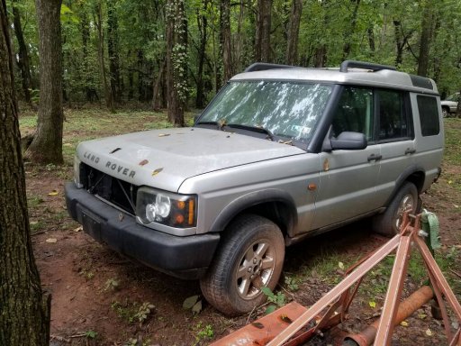

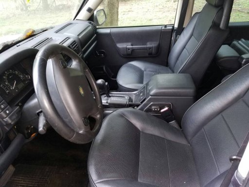

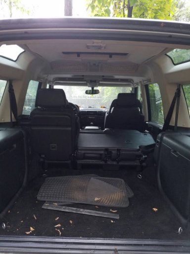

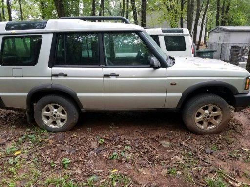

Well this project came to a screeching hault and went a different direction. After looking over the Suburban I decided it is just too big for what I want and want to do with it, so I went looking for something a bit smaller something more off road capable and something I didn't have to have a good deal of the parts fabricated. What did I decide on? Well I grew up watching The Rat Patrol as a kid and dreamed of one day driving a Land Rover. With Defenders out of my wallet size I decided on an 04 Discovery 2. Yes I know the potential problems, I've read so much on Disco2's over the last couple weeks its not funny! So I got an 04 in Zambezi Silver the interior is the "S" interior which I like due to it being easy to clean! The engine and transmission are out of it and will be replaced new in the next few months. Here are some pics.20171005_123813.jpg20171005_123850.jpg20171005_123836.jpg20171005_123911.jpg
