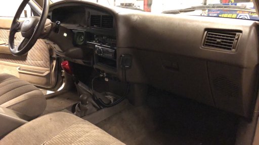

-CB Radio (antenna, cable, radio, mounts)

And the good part, pictures!

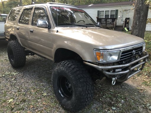

And getting started on the front bumper with some more custom pieces. Machinist didn't have any 0.500" mild to cut these out of so we cut 4 pieces of 0.250" and welded them together.
And here we go, bending and mocking up along the way!
And a roughly "finished" product.
And we got some new shoes! Cooper Discoverer STT PRO's in 35X12.50R15!
