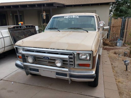

Just brought home my first ford, 1985 Bronco, recently rebuilt 351 Windsor v8 engine. Been waiting for 4WD for forever and this fit the bill with a big family. First up is necessary maintenance then on to lift and tires!View attachment 41868

Thank you! Been usin my old liberty for a while now, but the 2nd and size wasn't cutting it. The bronco is in overall good health, needs a bathere and a brake master to start, will let yu know if I run into any gremlins, thanks!
