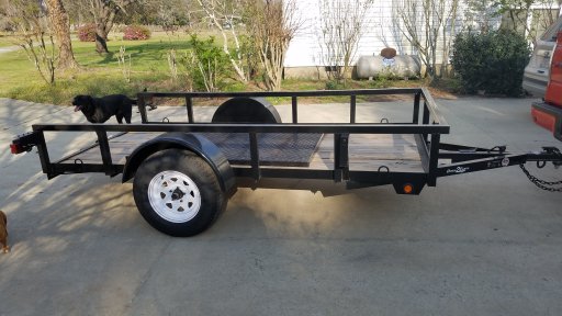

My wife and I have just purchased this brand new 5x10 Down 2 Earth utility trailer. It has a 3500 lbs under sprung axle and weighs 700 lbs dry :fearscream:. Our plans are to build a basic teardrop style trailer while still incorporating some of the side rails. I know this isn't the best look but it will allow us to mount some accessories down the road. Tomorrow we go to the lumber store to buy some walls and insulation to get started.
This build will be set up mainly for state parks right now, so I'll have power and water hook ups. We will have AC and a sink included. As of right now that's all we have figured out.
Any pointers or advice is much appreciated.

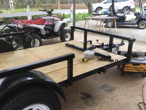

So far we put 3/4 pressure treated plywood on the base deck and cut out a portion of the side rails for the doors. IMG_4781.jpg
I still need to figure out how to attach the walls. I'm thinking I can use the side rails a bit and then use pocket screws on the exterior walls into the deck. Either way it will have to be on top of the floor.

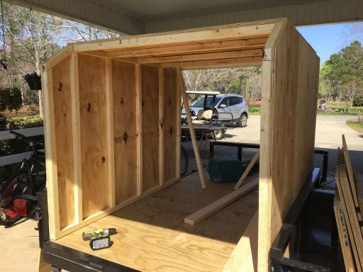

My wife has been chugging away on the project while I've been at the fire station and my second job. This is what it looks like now. Back walls are stood up and roof installed. Right now it's all temporary until we get our doors in.
The divider wall for the galley will be right about where that shadow is. That's gives us a good 24" of space.

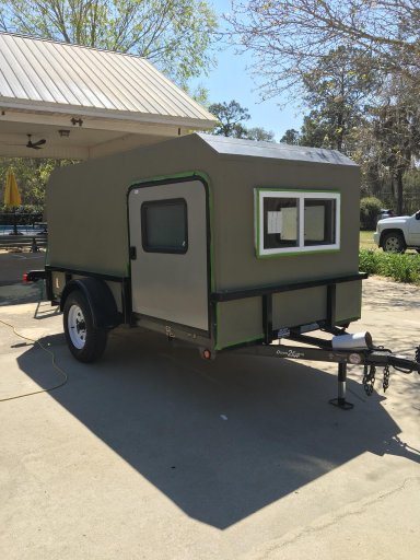

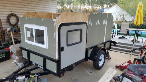

We've been able to make some pretty big leeps the last couple days.
This is it now with the front, sides and part of the roof installed. The window was a $40 house window we found at Lowe's and the doors were an Ebay find. They both hinge on the right side, but that's OK. A 43"x43" door should be plenty big for anything we can dream up. Lol it took some cutting and grinding to make the doors clear what was left of the side rail and tie-down point.
Tomorrow I will take some pictures of the inside. I snapped this one this morning on my way out the door.

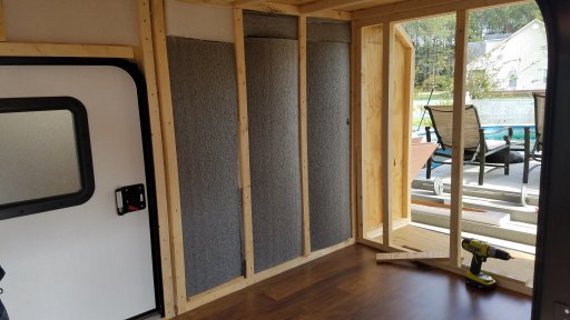

Worked a little today, but didn't get too strung out. It is Sunday after all.
The doors we ordered came shipped with some 1" foam (think pool noodle) that we decided to use as insulation. As far as I can tell the only difference between this and $20/sheet store bought is the radiant barrier.
Two packs of laminate flooring, pretty thin stuff, ran us $40 and looks awesome. Our interior space measures 8' inside so our bed won't cover it all, might as well have a nice floor to look at just inside the door.

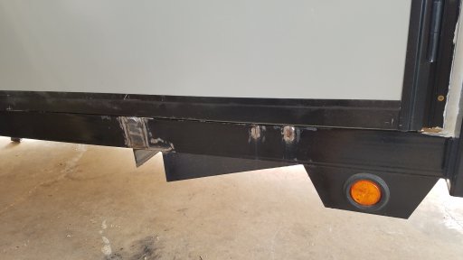

This is where we chopped the side rail and I ground it down for the bottom of the door to clear.
