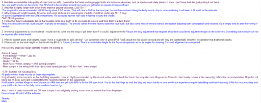

I'll start with the medium springs and replace with heavy once I add any more weight to the vehicle as needed. I appreciate the help Ben, definitely helps me to have a place to bounce ideas and get some feedback on this stuff.

For those interested in any further reasoning behind the decision on the BP-51's - see this screenshot of my discussion with the team I'm working with @ Mule Expedition.
