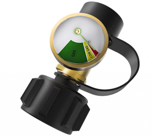

Recommend you pick up a gauge as well for the tank. It's helpful to know when it's almost time to refill.

Those gauges work great, I have them on all my tanks. 5 pound tanks go a long ways but when your out your out, always a good idea to carry a spare on longer trips even if it is a few Colman 1 pounders with a adaptor.
