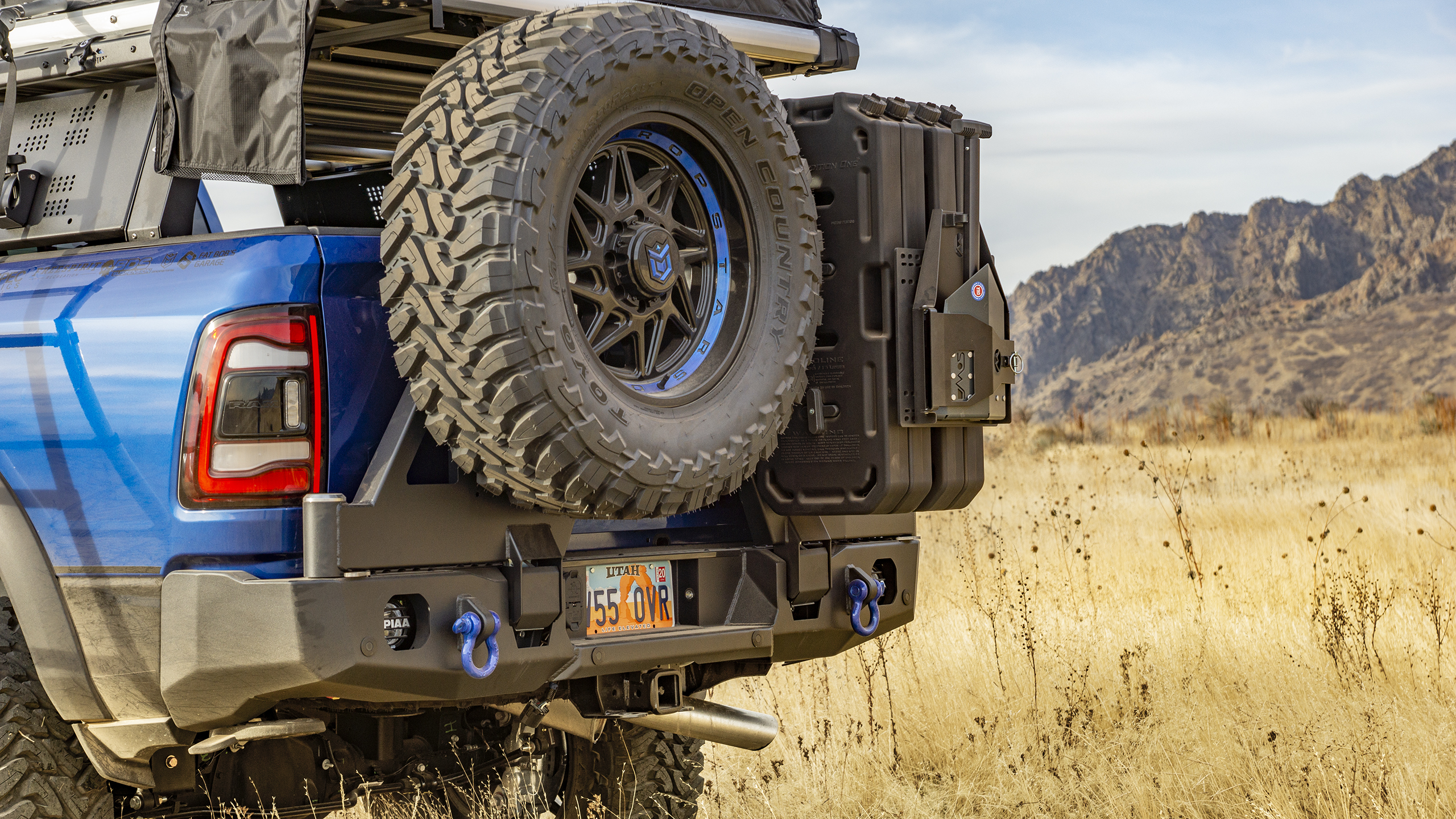

Otherwise I rock Expedition One bumper with tire mount.
You mounting location are a bit limited, maybe look at the AEV tire mount, they make good stuff:
rock on!
Edit: here's a picture with the Expedition One
Tire carrier
