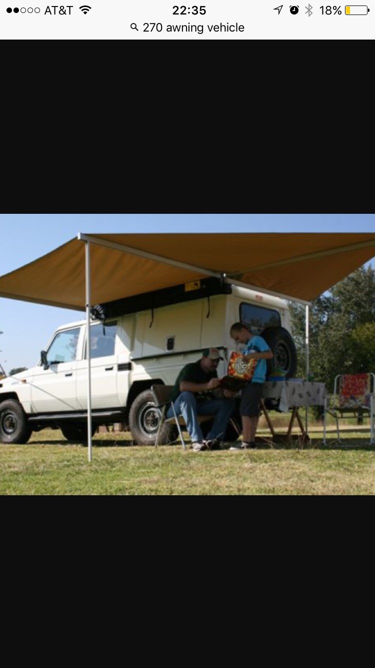

bambamthexj
So I'm not sure if this was built or produced but the design seems simple. The only change I would like is to have two square sections and one triangular in the middle. This would only require 3 sections instead of 4-5 like a ARB or others; while still giving lots of area coverage. My hang up is how to create a strong enough arm system to not need ground pole supports
Brandon Harvey
1,728
Oregon
7371
I like that design, possibly for support you could use aluminum beams that slide into some kind of a sleeve that was rigged to the vehicle. The rear extension would be the length of the roof rack and the side extension would be the width of the roof rack maybe a bit longer to create a kind of eve?
bambamthexj
You could make that work I think. It would be ideal if you could create a strong enough mount point/hinge that it can support the full weight when extended. But if you encounter any sort of wind or inclement weather it could compromise the structure, so support might be a necessity. Another idea based off the design above is to have hinged poles that fold down off the horizontal supports. Possibly even adjustable poles for uneven terrain. That way the support is there if needed but its also super easy and fast to deploy, if that makes sense. Or even some sort of a hybrid between the two ideas. I have visions in my head, maybe I'll try to get them down on paper.
