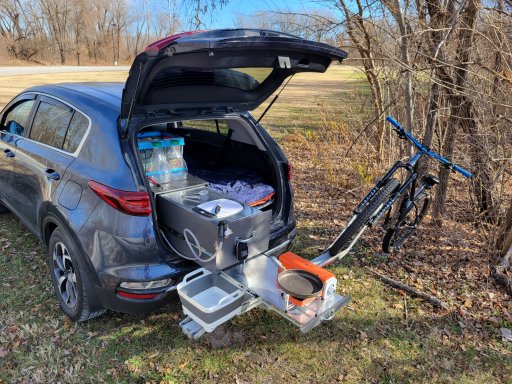

This blue 2021 Sportage is my gateway to adventure. As my daily driver and with the need to haul 2 kids, wife and 2 dogs around home quite often I needed simple but effective build out for weekend Moutain biking and camping trips with my idiot friends. The buld needed to be able to utilize a campground or boondock with ease. My build plan centered around the goal of a sub 5 minute camp setup and breakdown.
Kitchen (the hart of it)
  • Double pull out Kitchen box system that I built and is attached using simple synch straps to cargo tie downs or child safety restraint tie downs already in your vehicle. The kitchen box can fit in the back with both back seats up and usable for the kids if needed. The fully stocked box is less than 50lbs and takes less than 1 minute to install or remove. I store on a basement shelf when not in use and can walk it up or down the stairs without issues.
  • Stove Gas one Spyder (GS-8500) folding single burner Butane.
  • Water boiler Camp chef stryker
  • Pots/pans GSA pinnacle camper cook set
  • Kitchen Knives farberware ceramic knifes. Sharp easy to clan and no worries about rust.
  • Everything else is a mix of GSA and Walmart/thrift store or home kitchen castoffs.

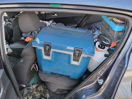

Water
  • Running wash water for kitchen and shower use is with a pump sprayer conversion (if hot water is needed simply boil some on the stove and add to the reservoir. Also use a collapsible sink basin for dishes and water catching
  • Drinking water is in gallon jugs bring as many as you need for the trip (I like to reuse simply juice gallon jugs as they are awesome and have a nice handle). Used the blue cubes in the past but I like this better
Cold food storage
  • Ozark trail 35qt premium cooler. With Ice and some frozen ice packs in the bottom. I also use a small 6pack size cooler to keep those campfire refreshments happy without needing to open the big cooler over and over again and refill the small cooler as needed. As most of my adventures are in the 2-4day range the expense of a refrigerator and power for it is not justifiable….yet.

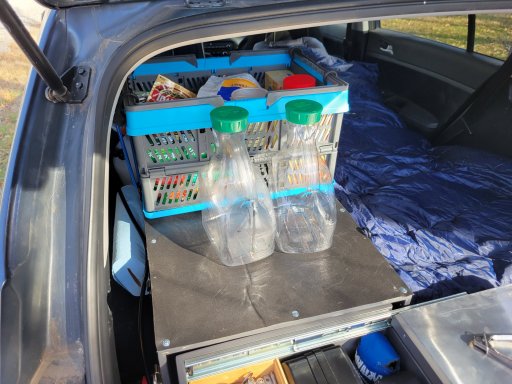

Dry food storage
  • I use a collapsible shopping basket
Bed
With a small SUV mixed with a BIG guy 6’5” it works surprisingly well but there is no extra length. Requires passenger seat slid fully forward to fit me.
  • Back seat seatback extension using 1/8” hard-board and adjustable straps around the front seat headrest
  • Softness provided by 2 inflatable camping matts
  • Warmth Sleeping bag and down quilt as needed
  • Crazy cold electric blanket and engine heat as needed
Power
  • Jackery 500 handles my CPAP like a champ have done 5, 8 hour nights without recharging. In rear driver side foot-well
Closet
  • Ospray Trail-kit duffle in rear passenger side foot-well
