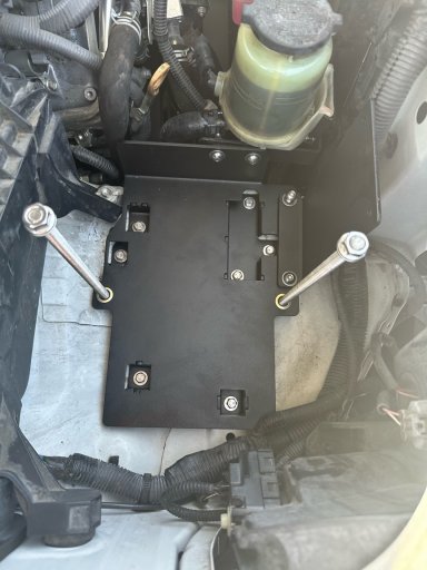

That plate is made by SDHQ its part of this kit,
here is the plate by itself

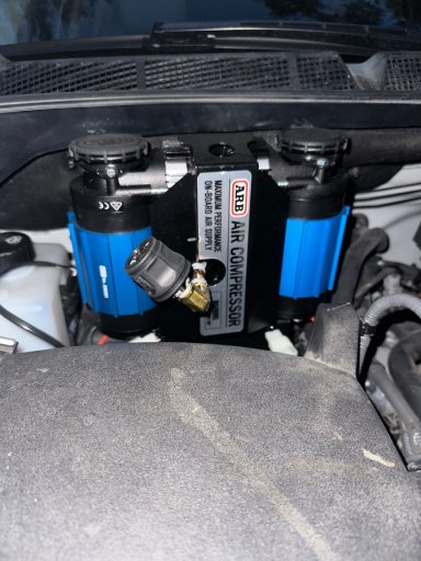

If the underhood mount HAS to be mounted in front of the battery, that won't work in my application as I have a Genesis OffRoad dual battery set up in the stock battery location and there is NO extra room there..
The SDHQ portion of the kit was the mount for what is pictured above, and the switch panel. The rest is all Switch Pros.
Does not have to be mounted there, just the mount I chose. There maybe other panels available and/or mounting elsewhere wont be hard. The only trick I can forsee is having the power cable long enough, but that can easily be rebuilt.
Here is an unboxing of the kit. The kit from Switch Pros does come with another universal mount.

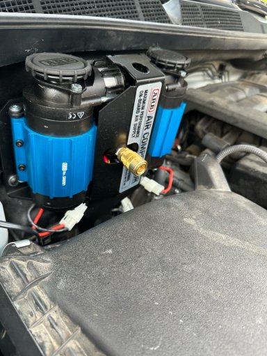

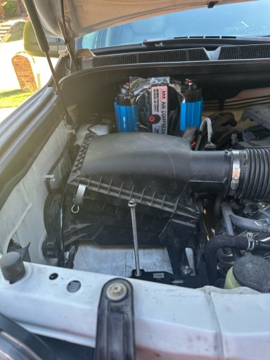

Tried to be cheap and use Milton fittings I had on hand for this project. Turns out it makes the system too long and hits the air box. An arb fitting and a cobbled together 90 degree elbow later.
