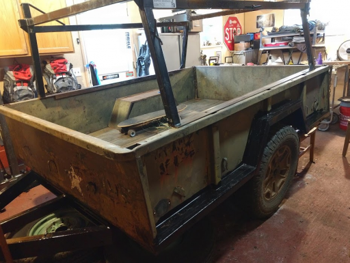

In this is a photo I put the body back on the frame and stared work on removing the axle and springs. The metal rack on top is a ladder rack from a truck. The tire in the photo is just prop to get an idea of what it will look like.

I replaced the solid axle with two independent Timbren axles from eTrailer. eTrailer provided a lot of detailed measurements, so It was easy to get the right combination of components to fit the trailer.
The rubber pad in the hinge of the axle works like a spring and shock all-in-one. The ride is a little different then a leaf spring set up. The rubber is softer over bumps and feels less stiff then a leaf spring.
In order to get the Jeep rims to fit on the trailer hub I had to drill out a small ridge in the center of the rim. The ridge was used to hold the Jeep center cap. I used a standard doorknob drill bit that fit perfectly. I ran the hand drill on low speed and slowly worked through the ridge.
Here is a photo of the trailer with the new axles and rimes (I was very worried about the final stance being to high or to low).
I replaced the side reflectors and painted the trailer desert tan. I added and modified a ladder rack from a truck to fit the trailer and our roof top tent.
We tried this configuration on a few camping trips and decided we did not like the rooftop tent or the color. :(

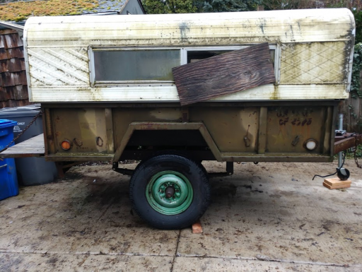

We sold the rooftop tent, removed the the ladder rack and....
... bought a (very yellow) truck camper top :). The plan is to make this into an overland version of a 'teardrop' camper.
The side door will access kitchen area. The other side will be for accessing camping gear.
Unlike the teardrop style campers where the access door is on the side, we will access the inside from the back. To help counter balance, I plan to mount the spare on the back (left side).
