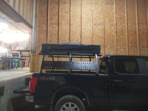

Next I started to work on the bedrack. I have it just about complete (building it out of scrap steel I have around my shop). Currently having the side plates cut out. Once those are done, I can paint it all and install it on the truck. 1 of the things that was of great importance to me was being able to use my tonneau cover with the rack installed. So I had the rack complete a week ago, till I tried to install the cover......I forgot to make accompadations for the 2x2 sq tube, so the cover wouldnt fit, ugh. So, being me i had to figure out a good solution, but the solution had to be quick, easy, and relatively painless. I added some "extensions" to the rack plates (that set on the bed sides). Reinstalled the rack....cover fits!!
I am hoping to have the rack complete and painted by the end of next week.

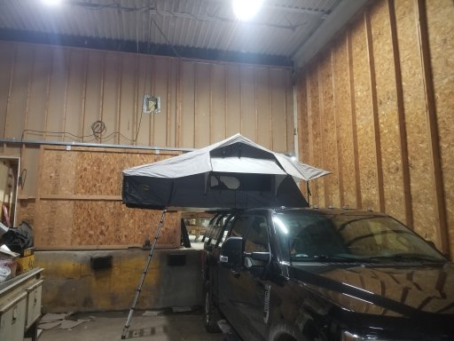

I have already purchased a Smittybilt XL Overlander tent (2nd Gen) and the XL 270 awning.
I am pretty sure I have my design for the bed/kitchen system. The kitchen pullout will be on the driver side (60" locking slides). I also plan on building a bed slide to go over the kitchen box, so I can easily access the 10" or so, of space that I should have between the top of the drawer and the cover. On the passenger side of the bed, I will have my fridge/slide. I am thinking that behind the fridge (between the cab and the fridge) i will have 2 batteries, inverter, charger etc for accessories.

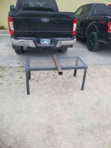

Im thinking of fabricating some type of a "hitchswing arm" that I can carry extra water etc., on a folding table that i made last year.

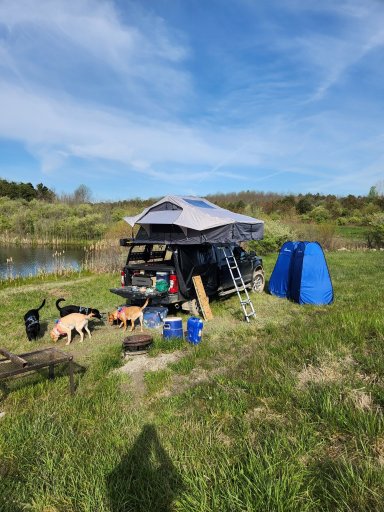

Been away for a lil while, cuz we were out enjoying the wilderness! Been on a few small trips. Hoosier NF, and then up north just south of Traverse City along the Manistee River. Things are well with everything that has been done. Every trip, I find something else to add that will be useful.
Heading to the Ozarks in a couple weeks. I know the trails are tight for a full size rig, but we are visiting family, so not sure how much exploring we will do. Plan on staying a night in the Mark Twain NF, on the way down. Should be a blast
