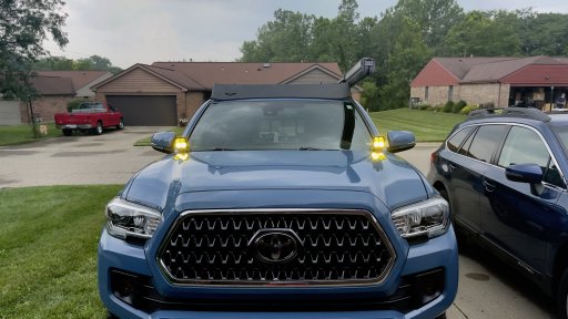

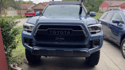

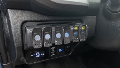

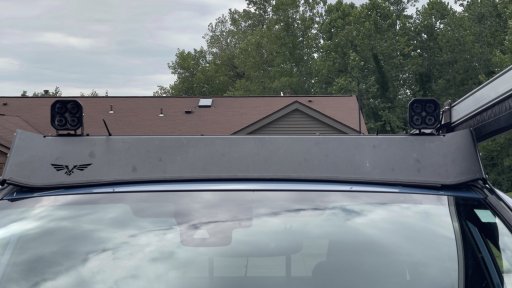

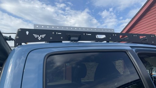

I don't have pictures yet.... Buuuut I've added the Trigger Six Shooter, Two SS3 Sport Amber Combo Lens Ditch lights and 2 SS3 Pro White Spot Lens Pods from Diode Dynamics. I originally planned for 4 spots but to be honest once I get them dialed in I may only need the 2 I currently have. I still have yet to install my rear chase/backup flood lights which are SS2 with amber back light. To use them with the Trigger they need to take up 2 slots (one for back light and one for full on) so I'm still debating on how I want to run the wires for that. I've also changed out the grill for a TRD Pro variant finally deleting that chrome bezel on the stock grill :expressionless:. I'll post pictures in the next Post as I still need to take a bunch of them now that they are complete.
SJ.Overland
Trail Blazer II
6,140
Beavercreek, OH, USA
Shaun
Johannes
15310
KE8TDZ
Camp/Side light:
Ditch Lights: (They have been adjusted outward since this photo)
Spot lights:
New Grille:
Trigger Controller:
