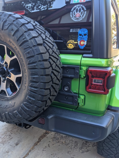

I added a Mopar tailgate reinforcement to support the weight of the 37" tire. I also added the Mopar tire carrier relocation brackets to clear it off the bumper.

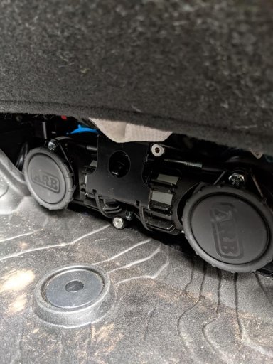

A few new upgrades: I installed a dual ARB compressor under the front passenger seat which runs to an Up Down Air system under the hood. The UDAS runs to all 4 wheel wells, each with it's own air valve. I have 4 short airlines I run from the Air valves to the tires, set my gauge to the desired psi (air up or air down) then flip the switch and it sets all 4 tires to the desired psi in under 3 minutes. The compressor is loud in the cab but I'm not in the cab to hear it.

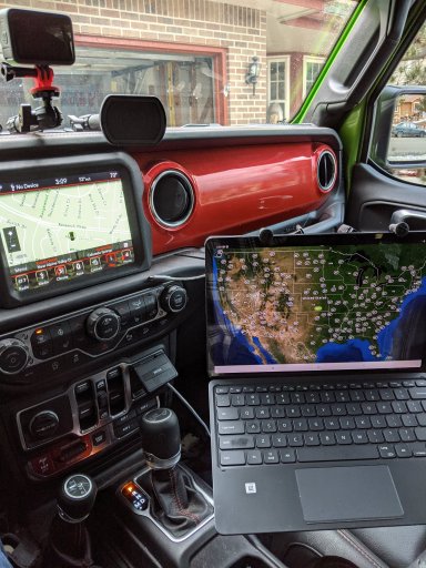

Samsung 7+ Tablet on a RAM Mount connected to my grab handle with a Carolina Masters 1" Ball

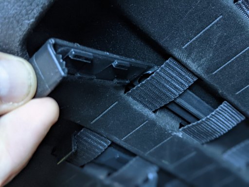

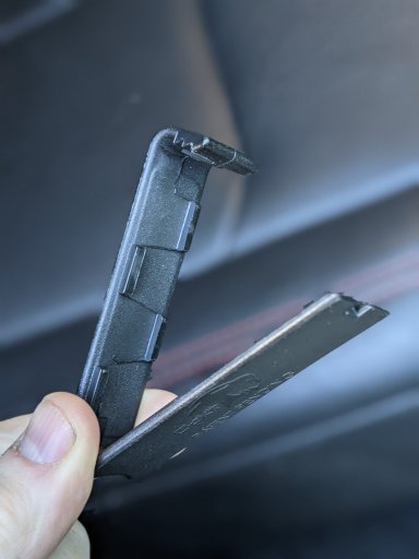

I find the JL Molle to be too stiff to be practical. I found these clips that I can run through the Molle, giving me the ability to use them to hold pouches or kit.
