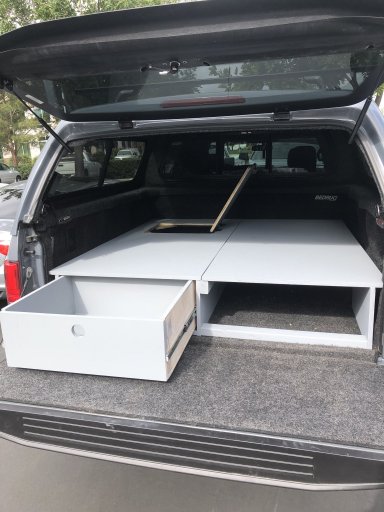

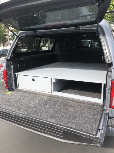

This last weekend we decided to build out the bed of the truck. We opted to go this route instead of a RTT because we wanted to have a little bit more warmth and it will be easy for our dog to get in and out of the bed! We have our mattress being delivered this week. This is just the start so I hope you enjoy!
View attachment 144869View attachment 144870
looks killer! who built the drawer system? where are you getting your custom mattress from?
Thank you! We built everything from scratch, the drawer is just on a ball bearing roll system and build from plywood. We ordered a 4" queen size foam topper which we'll have to cut to fit perfect and then well sew a custom cover for it!
very nice! do you build photos on it? how did you work around the wheel wells? drawers stop at the wheel wells?

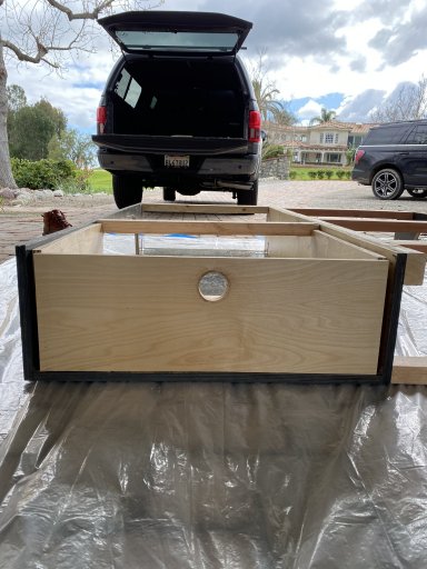

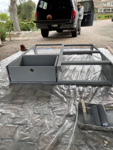

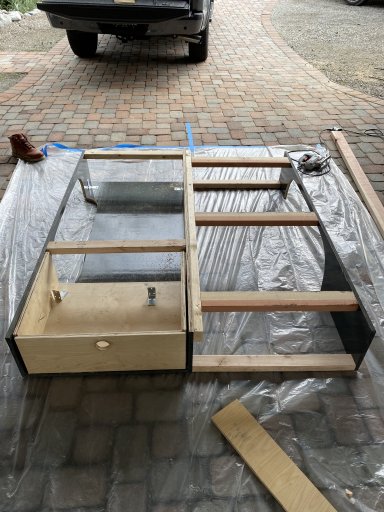

Of Course! We just used a jigsaw to cut the plywood around the wheel well. The drawer does stop at the wheel well which is why we made the hatch in the rear for storage. We left one side open so I can fit my surfboard under the bed.
Here are some photos!
View attachment 144884View attachment 144885View attachment 144886View attachment 144887
