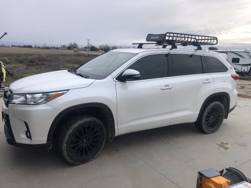

So we have made some progress over the last few weeks.

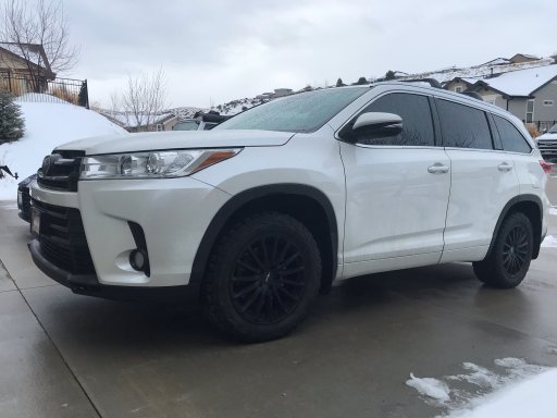

Had a Ready Lift 2 inch lift kit installed last week. Had the alignment done the next day at Commercial tire here in Boise.

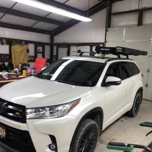

Took most of the Yakima Rack parts off of my LJ and put those on the highlander (canoe mounts, cross bars, awning) plus I added a Yakima skinny basket.
I changed out all the light bulbs in the driving lights, high beam lights and fog lights to Napa Xenon...High beams need to be adjusted down.
I went with a Moose knuckle rear tow clevis and insert for the rear 2" inch hitch.
I ordered the OEM pull hooks for the front. I'm in the process of rattle can painting those red.
What next?
Some blacking out of the badges,
Moving the Ham radio from my truck or jeep to the highlander.
Installing an inverter.
No-Lo designs skid plates, front, rear diff, catalytic converter. they also make the hood mounts for ditch lights.
I am hoping to custom fab a light bar on the grill that attaches behind the OEM tow points.
Then maybe some Baja Designs or KC ditch lights and wide beams.
Down the road when these 255/55/r18s (29 inches tall) are worn out which will likely be this spring I'll be going to 265/60R18 (30.5 inches tall) or 265/65r18 (31.5 inches tall) KO2's or KO3's.
At this point I will likely need to get a swing away spare tire rack. Looking at Wilco or Ridgid armor swing away tire rack.
Next winter I may purchase a set of studded all terrains as I have the original tires and wheels that I run in the summer.
