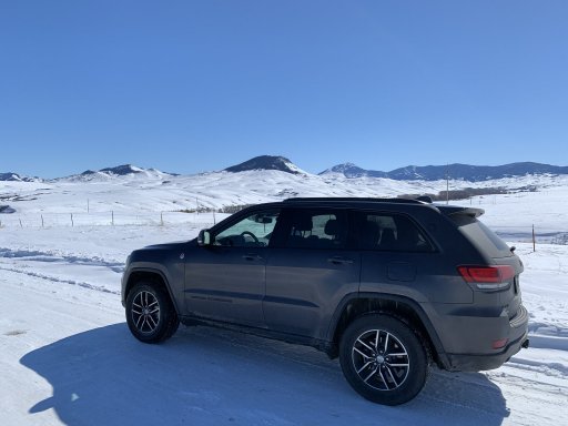

Looking to start building my 2018 JGC Trailhawk this month, but not sure what’s the first thing to upgrade.
Any recommendations on where to start? I have picked out the RRO Tire-2-Tire kicker sliders for the rock rails but haven’t ordered yet. Not sure if that is a good place to start or if I should knock out wheels/tires first...
Any advice on tire size/brand and what type of rims fit?
Thanks for chiming in, I appreciate the help! View attachment 103021

I’d say wheels/tyres and suspension are a good place to start but it all depends what you want to do with the car? Where do you think it needs improving for what you want to do with it? Do you need more grip, more clearance, more protection, more light, comms, camping equipment, fuel range...
It’s your rig.id say to add what fits your needs.
Nice shot btw.

Thanks for the input. I’m in mid-Montana and get into the mountains for daily drives almost every weekend (where there isn’t snow). Most trails/roads are rocky and muddy I love the ride and want to keep from doing too much damage, if possible.
I’m worried about going after the suspension since it has the QuadraII air suspension.
