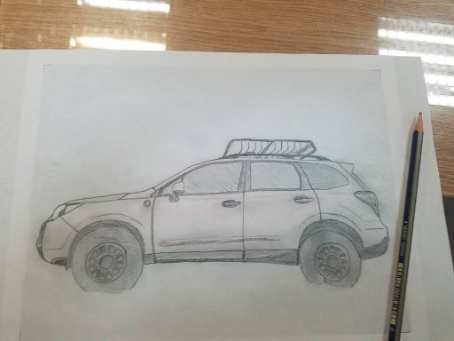

My forester will be set up to:
1. Daily driveView attachment 51999
2. Transport family to adventures
3. Strengthen the vehicle for mild off road abuse View attachment 51998

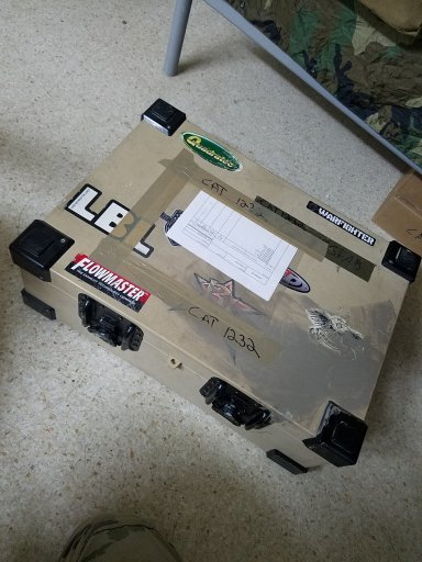

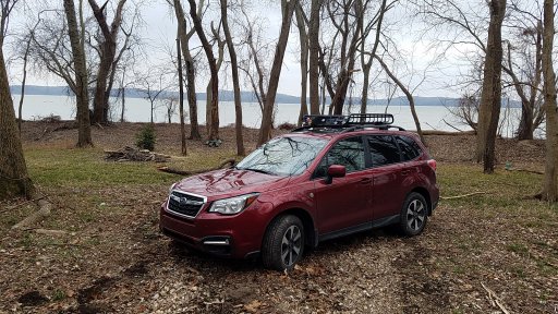

View attachment 52004 View attachment 52005 The first thing we added was the Yakima rack from the dealership. it is not the final product we will keep but it will get us by for now. So far it has held up to three trips across the country fully loaded down. I contemplated adding another crossbar for more support but I was afraid I would load the rack down with more than the actual roof was made to handle. I take the small flex in the cross bars as a sign I have overloaded the rack and back off a bag or two.
The box I have on top will be modified to secure to whatever brand rack I end up with. The box is from the Army and was used as a shipping container for rifle optics. I believe all of the M68 aim points were delivered inside these boxes. they were set up to carry 6 small pelican cases inside. They are fully lined in foam and have some pretty secure locking mechanisms on them. thy are extremely rugged and have made many trips with me to include Afghanistan currently holding some of my personal gear and extra batteries. View attachment 52002

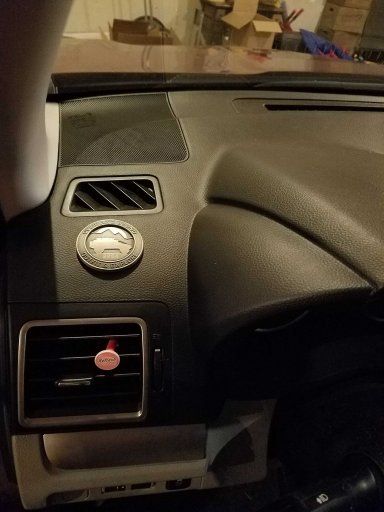

I needed to find a place for my second OB emblem at this point. I initially tried to get them to stay on the front fenders but they had to many curves to lay flat enough anywhere I thought looked good. Last thing I wanted was to come back from a trip and the badge was MIA. I chose the drivers side dash for two reasons. One is it will remind me to Explore. I will see it every time I drive. The second reason is because of something I am guilty of any time I see a cool rig. I look at the whole thing. Sometimes I peer inside to see what kind of cool gadgets they have at risk of being thought of as a potential thief. Just admiring however, it is one more chance for someone whos interested to see the emblem and check out OB. View attachment 52006

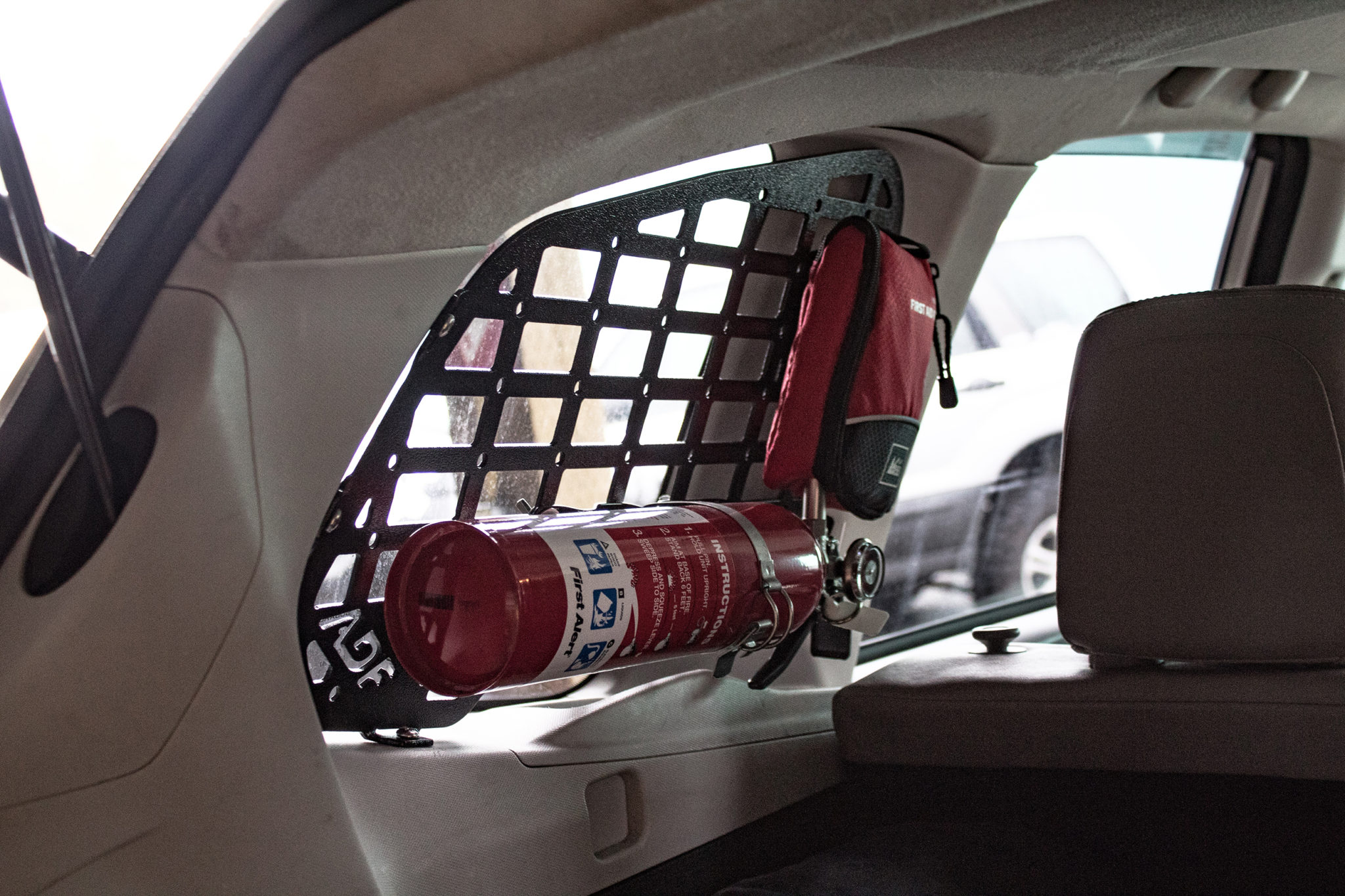

Added a small fire extinguisher before i left. Finally got my wife to take a pic of it for me to post. It was the perfect size for the random little cubby in the back. It's suprisingly easy to get to as well. View attachment 52666
