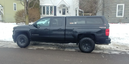

Nice rig! I'm running just about the same setup in a '16. I've never seen limb risers on a Silverado. Do you think the angle from the hood to the roof would be too much? The risers wouldn't have much clearance to be effective like they would on a super-square jeep or defender.
P.S. What size tires are you running? I'm looking to upgrade once my tires wear out. I'm too cheap to replace them before they're bad...
Thanks!
I've never seen limb risers on a Silverado either. I think they would be helpful, assuming you can make them tight enough and aren't flying through the branches. But you're probably right, they won't be as effective as on a vehicle with more of a right angle in front. Put it this way, they probably won't stop scratches from the twigs and stuff that stick out from the branches, but they probably would have stopped whatever thicker branch smacked my windshield. At least, I think so. Since taking that picture, I've added a grille guard, which gives me an attachment point for the font end. It would attach about flush with the top of the hood and just behind the directional lamp. For the roof, I'm *hoping* I can find a roof rack bar (Rhino-Rack or something) that can be shimmed up enough to fit a couple 3" spot/floods underneath it and allow me to attach the limb riser on top. In theory, that would offer protection for the lights while keeping branches off the windshield. However, this has kind of been put on the back burner as for now, I'll probably just avoid such overgrown paths :)
I "upgraded" from the stock 20" alloy wheels to 17" steel rims with Goodrich TA KO2 32.2x10.8. I wanted a bit more rubber without going too hog wild. With stock suspension I had just a little rubbing in reverse with the wheel cranked to the side. Added some Bilstein 5100 adjustable shocks to get just enough lift to stop the rubbing and give myself about 1" additional clearance all around.

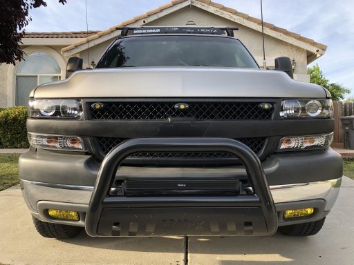

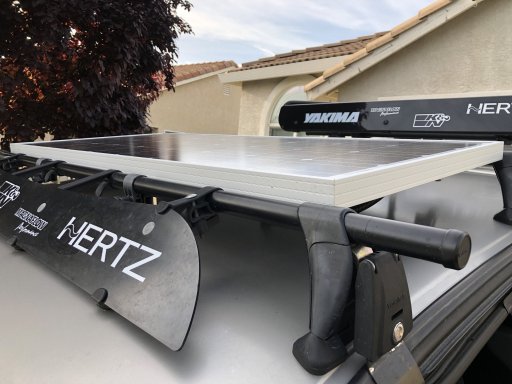

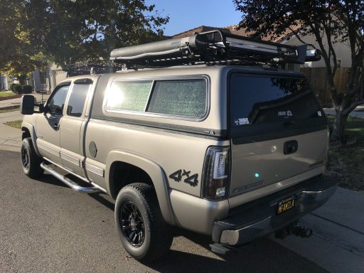

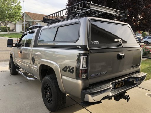

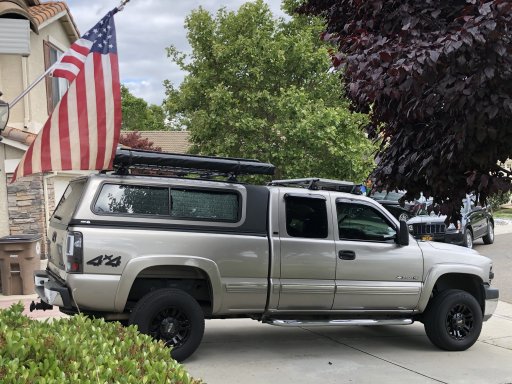

For some ideas here is my 2002 Silverado 2500hd with a Yakima Mega Load Warrior on top of the truck camper. I have cross bars above the cab but have utilized that for my polar panel. The Load Warrior Rack also has the extension to make it as long as the shell. I also have a Yakima awning and Road Shower 4s. I thought about putting lights on the front cross bar but don’t want additional wind noise than I already have.
For the front I only have a bull bar for protection and a 20” LED bar attached.
