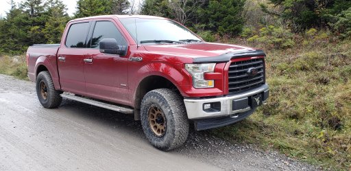

After finally getting the level kit installed with the new wheels and tires, I was itching to get out on a trail. I grabbed my new Purple Lizard map of the Dolly Sods area here in WV and got together a quick day trip with my dogs (see how happy they are lol).
All and all the trip was an approximate 180 miles. Nothing extreme, just a toe in the water, and some great scenery of a fall West Virginia.

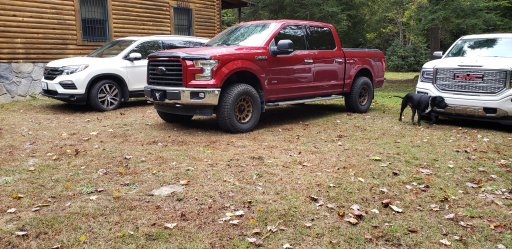

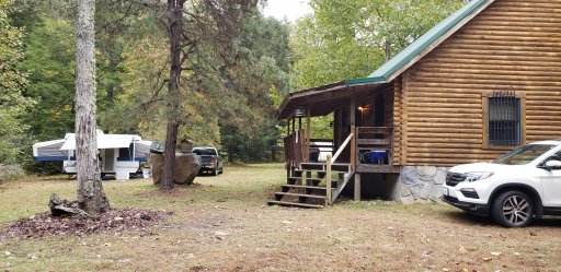

Just a small update of a trip over the last weekend. Loaded up the truck and headed about 2.5 hours south to Mt. Nebo, WV to my families cabin. We have a get together there every year during Bridge Day (https://officialbridgeday.com/). We have about 30 acres, most of it barely passable, but has some great spots for hiking and small camp sites.

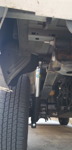

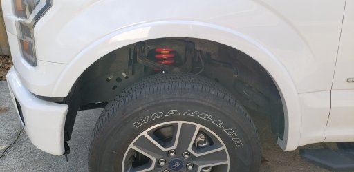

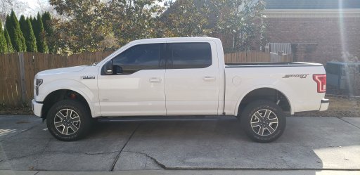

Thanks for the feedback. I ended copying your setup and added a 3" block in the back to a slight rake (thank Stage3 Motorsports for the advice). If I would have done anything different is to have waited a week for Stage3's Black Friday sale (would have saved $50). Regardless, the ride, handling, and the steering are soooo much better. Now I just need figure our my tire and wheel setup. The F150 stock turn radius sucks.
View attachment 78171View attachment 78173 View attachment 78175 View attachment 78176
Looks good! Which rear block did you end up going with? I didn't think the 5100's would accommodate 1.5" lift in the rear. I really do like my wheel and tire setup. However if I were you I would try to stay away from LT or E load tires unless you really need them. My 285 75 17s are E load and I lost a ton of MPGs. I went from roughly 17.5ish down to 14.0 - 14.5 with the extra weight.
Ready lift 3"...got em from Stage 3 for $99. Good advice on the tires...I saw that the factory ones weigh 39lbs and the Nitto Ridge Grapplers I like at 69lbs. 120lbs of unsprung weight is a lot especially for my DD truck.
