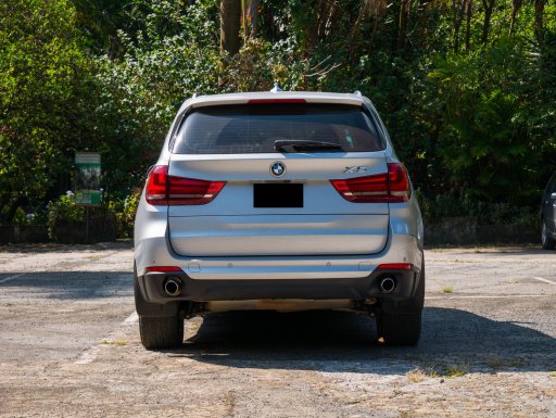

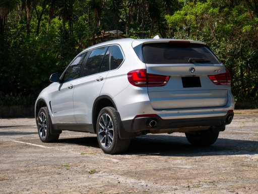

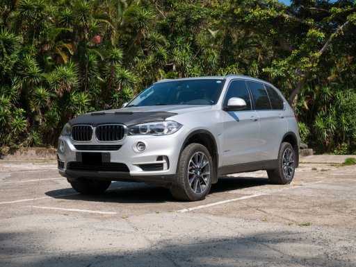

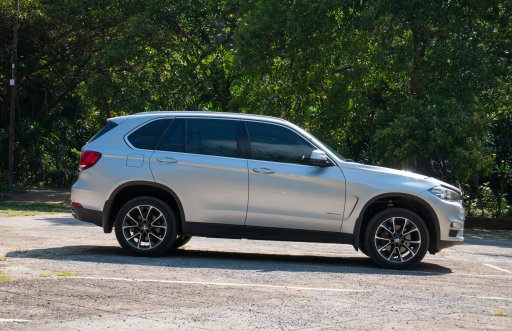

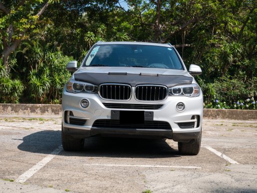

Hello friends, I am posting this since it was very hard to find any info on lifting a BMW X5 F15. The only place where I could find a kit for it (they also make lifting spacers for all makes and models apparently) was Spaccer from Germany (Spaccer.com). They provide up to 60mm in lift solutions. I ordered 3 (out of a maximum of 4) spacers that provide 45mm of lift. But since I am testing the waters, I installed only 2 spacers for a total of 30mm (1.18 inches). I am posting photos of the spacers installed. Note that the ground where I took the pictures was not level, that is why you see the car a little tilted. Next stop will be tires. The OEM size are 29" diameter 255/50R19 on all four corners. I already ordered Cooper Zeon LTZ 255/55R19, that are 30" in diameter. Could not install a higher profile tire because of the suspension arms in the front tires, 30" is the most I can install without having to do some extra modification, which I do not want to do. As soon as I install the tires I will post photos. X5 Front.jpgX5 Rear.jpgX5 Front 3q Left.jpgX5 Rear 3q Left.jpgX5 Right.jpg

Its too bad there aren't a lot of mods for these suv's. It's one of the main reasons i bought an lr4 for my wife over the x5. I think some companies are starting to make "lifts" for the older x5's, so maybe that will start trickling up.

Looks like you've got room for another inch or two of rubber now. You might benefit even more from dropping rim size to the smallest you can fit on the rotors to get some more air in there too. I drove an MDX for the last dozen years and took it a bunch of places it had no business being but I gave up on lifting it because there were not a ton of good options and I knew finding a lift for it would have been the end of the journey rather than the beginning. I switched to a GX last year. I'd be interested to see how a crossover fares with a set of KO2's and a mild lift. I think AWD is more sure footed because of torque vectoring, just not sure how the half shafts would hold up to a bunch of slipping on a more hardcore trail. On the other hand an AWD cross over can do 45MPH around hairpin turns on graveled forrest roads, so... that's fun too : )
