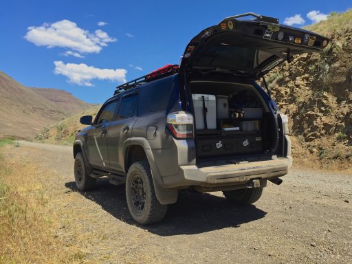

I installed the Icon Stage 2 kit this past spring on my 2015 Trail w/kdss. I have a Gobi rack, awning, cooler slide out, stove and TruckVault that I keep loaded most of the time so needed to beef up the springs in the rear at least. The truck was feeling a little mushy when loaded for the weekend with the stock stuff. I ended up with Icon's progressive "expedition" springs, rear track bar and UCAs in the front in addition to the rear shocks and front coil overs... When I first picked it up from the shop (I had some old racing friends do the install) it was a tad taller than I expected, but seems to have settled in at about 2 3/4 -3 inches taller from where I started. Getting the caster where it needed to be was iffy without the UCAs and the runner was a little flighty on the highway at speed. Nothing I couldn't handle, but bought the UCAs anyway. The line up is perfect and the truck handles great now. The more I carry the better it rides off road.
If you plan on carrying a bunch of stuff, the expedition springs are great, but if you travel off the beaten path empty they are a little stiff. I know a lot of people like the Swayaway springs or OME, but I wanted to stay with a setup designed to work together. My research pointed me to Icon. They seem to have it figured out...
On another note... I blew a front shock this summer ( bad O ring and a killer pot hole) and the guys at Icon turned it around in a day and overnighted it back. Great customer service. Stuff happens, deal with it. I used the need for a fresh line up to add the UCAs.

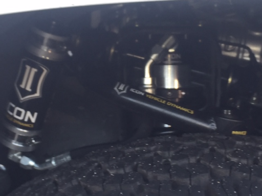

Update: After all of your input and my own research, I went with the Icon Stage 7 with the overland rear springs. So far so good. I am very happy with the quality of product, customer service, ease of install and alignment adjustability.

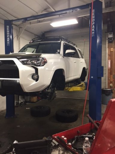

mase001
2,517
85018
2783
Great lifts mentioned! Cool pics too. I went with the Toytec Ultimate Lift with Bilsteins and I did the Camburg UCA's! Hard to go wrong with any lifts mentioned in this thread!
