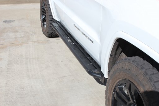

One of the most vulnerable parts of the WK2 out on the trail, unless you got the Trailhawk, are the side skirts. Since I could not source a set of Mopar rails, I went with sliders from Uneek4x4. They weren't the easiest to install. But that was my fault for having dull drill bits. But I love them and they have paid for themselves!

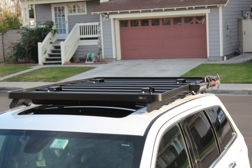

Our trip was to be a dads and kids trip. And the other 2 dads both had RTT's. Once my daughter caught wind of that, I had to bite the bullet. Front Runner Slimline II rack and Tepui Kukenam Sky tent...

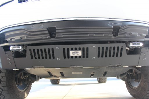

Before my most recent trip, I got to install a couple of new things. First was the lower front protection from Chiefs. In the last photo, you can see where the sump plate took a big rock hit from that first trip.

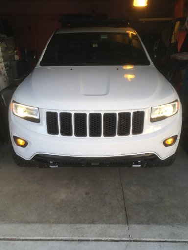

So here are the yellow fogs. They're not LED. They're just direct replacements that I bought off of Amazon for relatively cheap. They're Hella H11 Xenon Yellow bulbs. And since the lower valence was already off, it was only a 5 minute swap without moving wheel liners or anything else.
These cellphone pics don't do them justice. But I like how they break up all of the black and white.

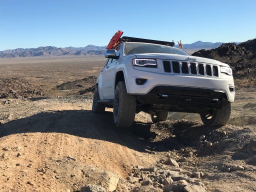

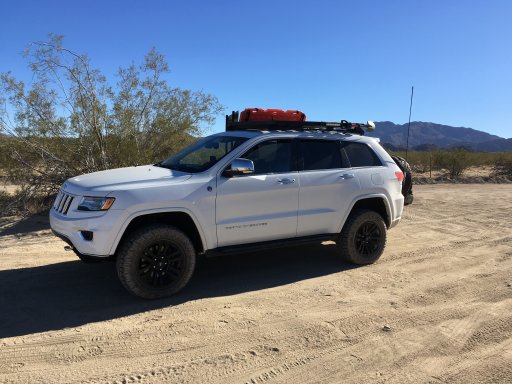

The new tires also went on over the weekend. 275/65R18 General Grabber A/T X. They are about 1.5" taller than stock size. The front tires just barely nick the front edge of the flares when turning in park mode. Not a concern for me though, as I only plan to run these on off road trips and I can disable auto park mode. My initial impression of them compared to the Duratracs is that they are HEAVY. Don't think I'd want to run these on a DD. But handling feels comparable and they are MUCH quieter. Hopefully I'll be able to get these out on the dirt in the near future.

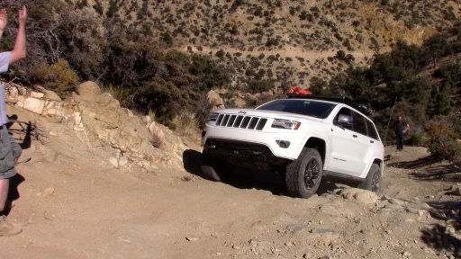

Thanks! I don't have any experience with the AT2's. But the ATX's are supposed to be their successor. Same inner tread pattern. More aggressive outer tread. And sidewall strength of the X3. Just broke them in on the the Mojave Trail where they performed great.
