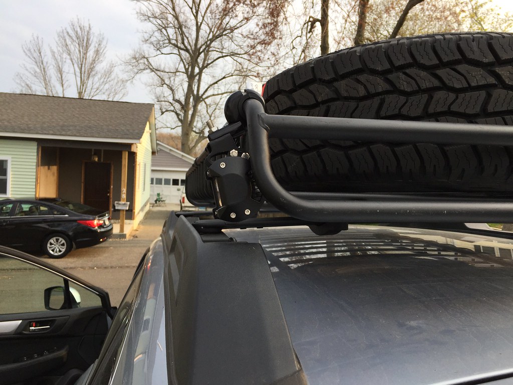

2 of WARN 85340 0.875" - 1.125" Universal Swivel Light Mounts - 26.49 x2 - Amazon

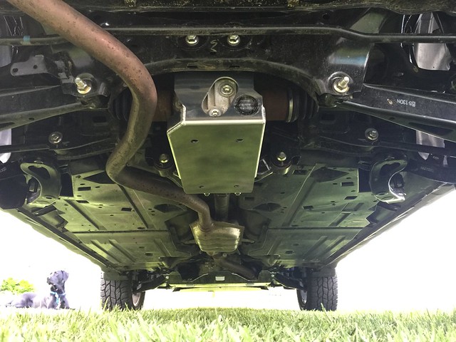

Front Skid Plate 2013+ Outback
Add Oil Holes Extra $20, Thickness : 3/16" - $288.00 primitive
Add Fumoto Valve $29.00
3/16" Rear Differential Cover - $110.00 primitive
14mm Camber Bolts - 1 $19.00 primitve
2015+ Outback/Legacy 3/16" Mid-Armor - 1 $135.00 primitive

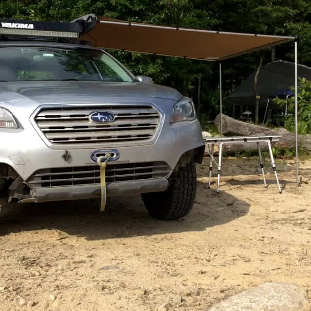

ARB 2000 awning $258.30
FourTrex Mount $93.10
Awning Room $156.60

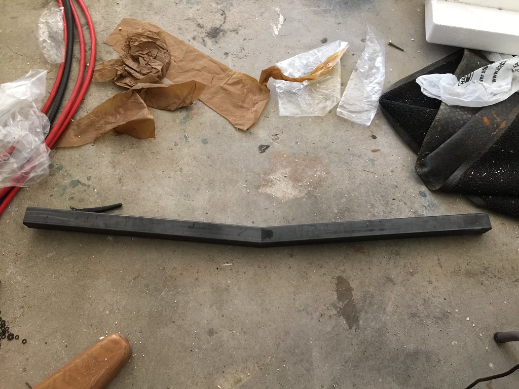

Steel for winch mount and other items - as of 5/12/15 $118.00

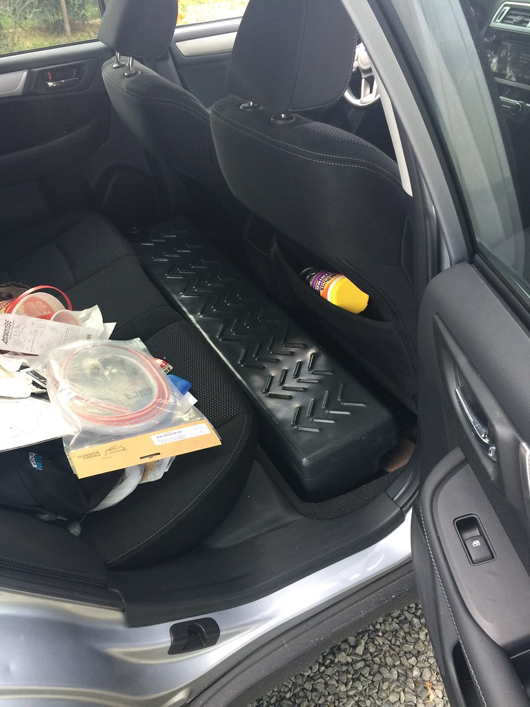

frontrunner floorboard water tank and hose kit - 200.00 - frontrunner

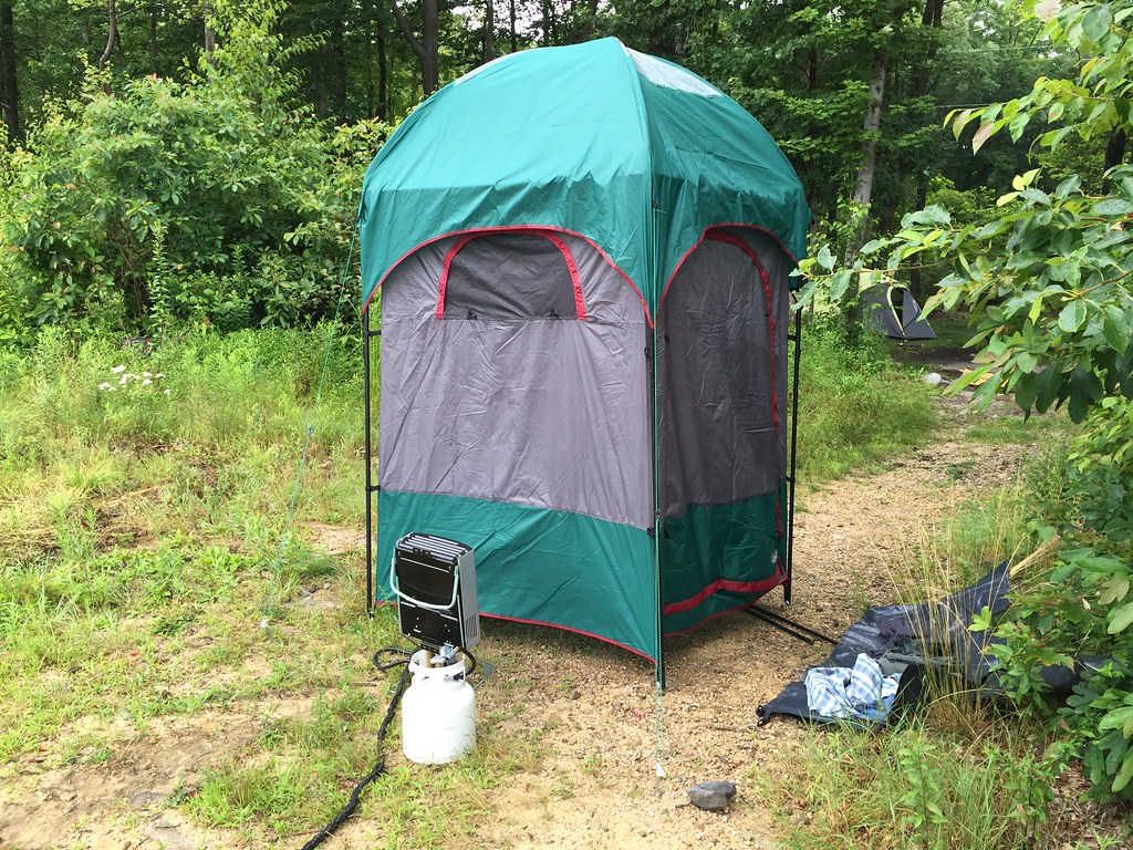

camp chef triton shower - 126 - amazon
water filter - 8.00 - amazon
water pump - 58.00 - amazon
Edgestar Fridge/freezer - 300.00
parts to build the slider for freezer - 68.00
shower tent - 89.99 amazon

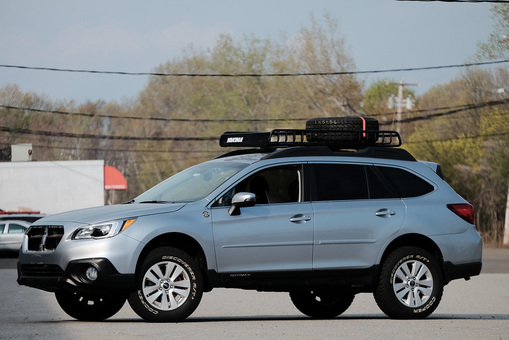

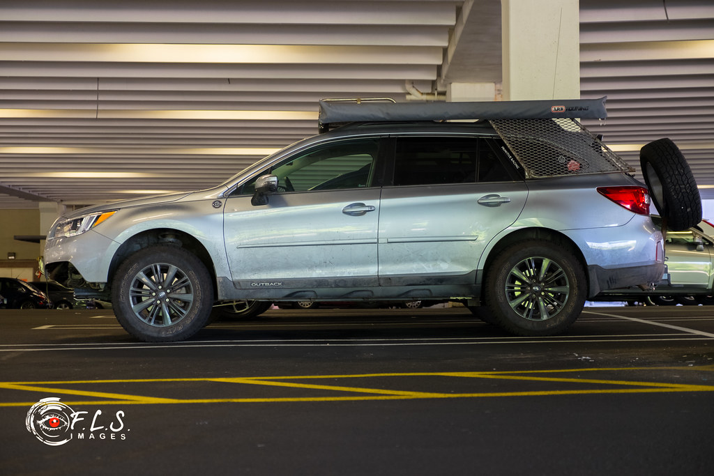

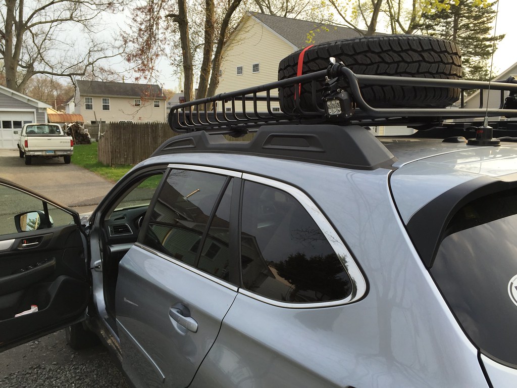

Custom made and designed roof rack - 1300
Custom winch center bumper - 700
both made by Costa Fabrications also found here
outback by Flsimages, on Flickr

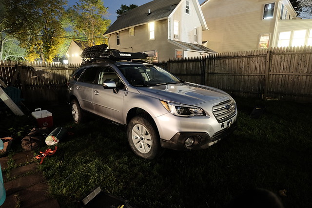

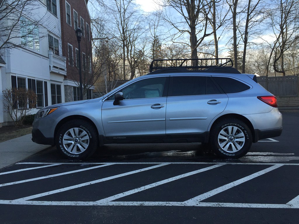

obviously. i already built a 2009,.....the first 2015 for sure

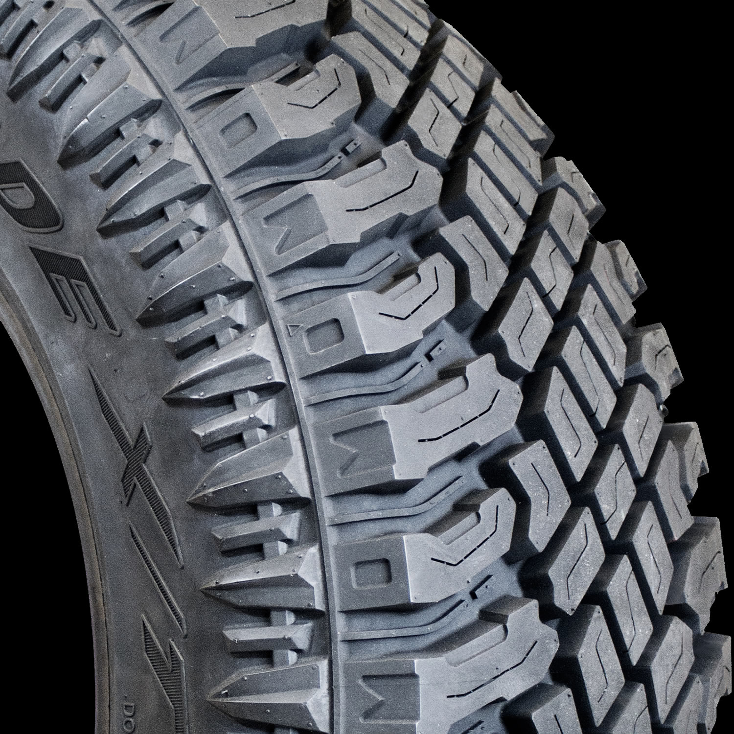

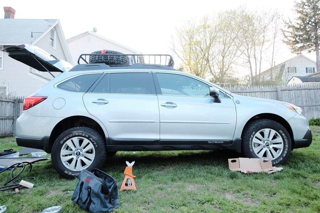

It all started with tire. Everyone has to have tires right? Decided on a 245/65-17 Cooper A/T3 mainly because of all the crazy awesome reviews i read about them. Im happy with them
Untitled by Flsimages, on Flickr
white letters out baby!

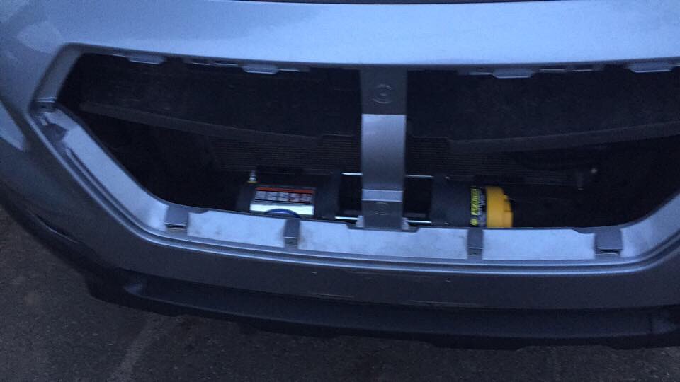

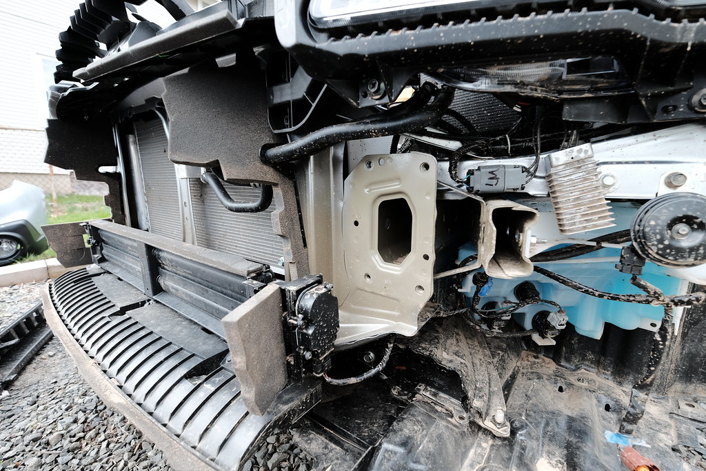

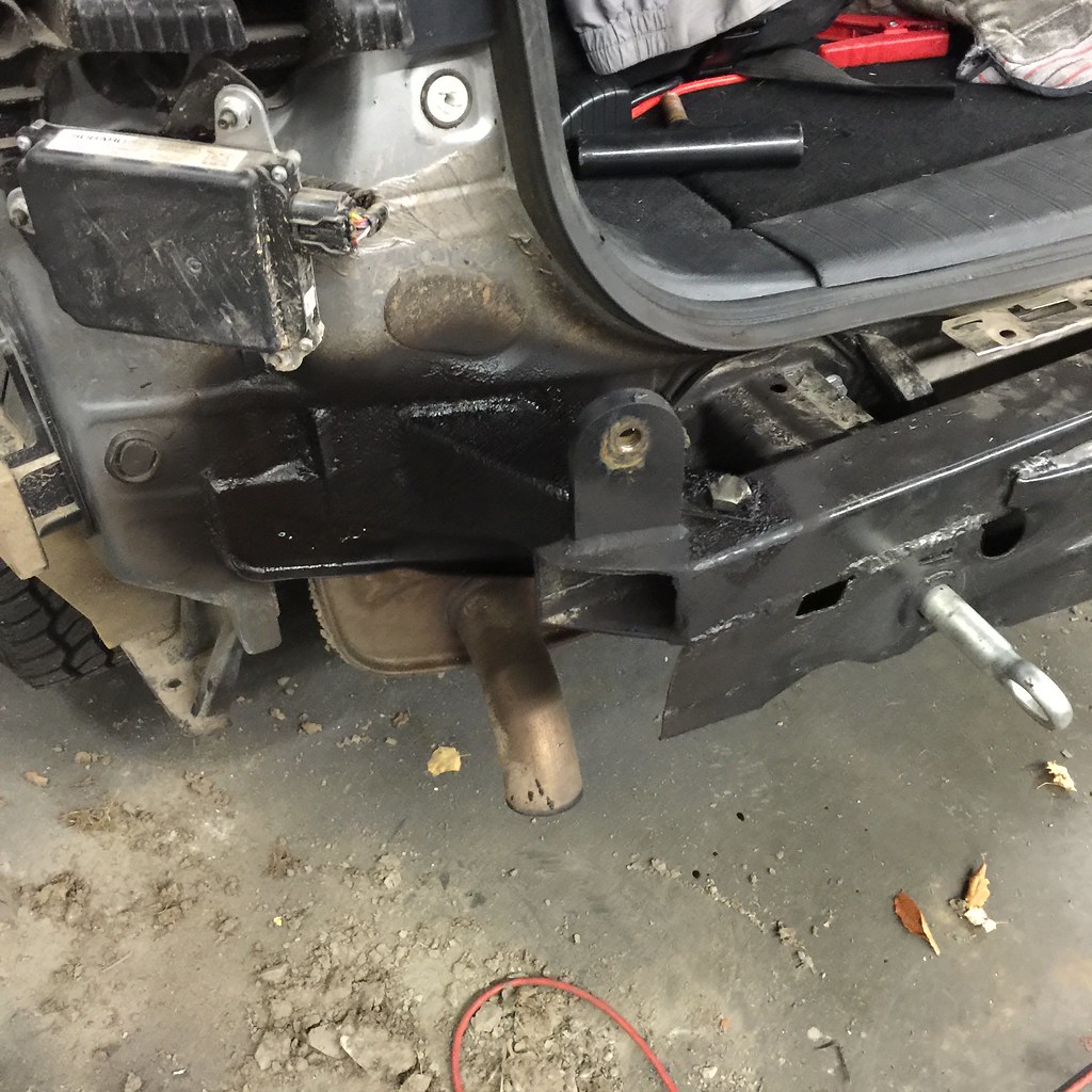

first project was to pull the bumper and core support, check if i can figure out how to mount a whinch
XT013017 by Flsimages, on Flickr
XT013037 by Flsimages, on Flickr
i figured it out. ill show you when i do it :)

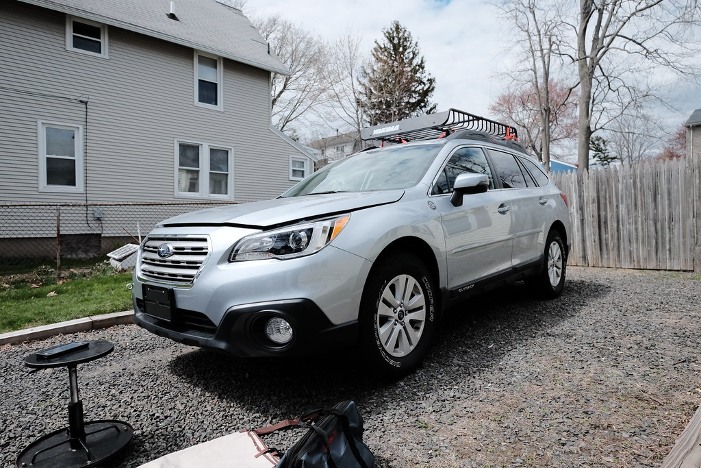

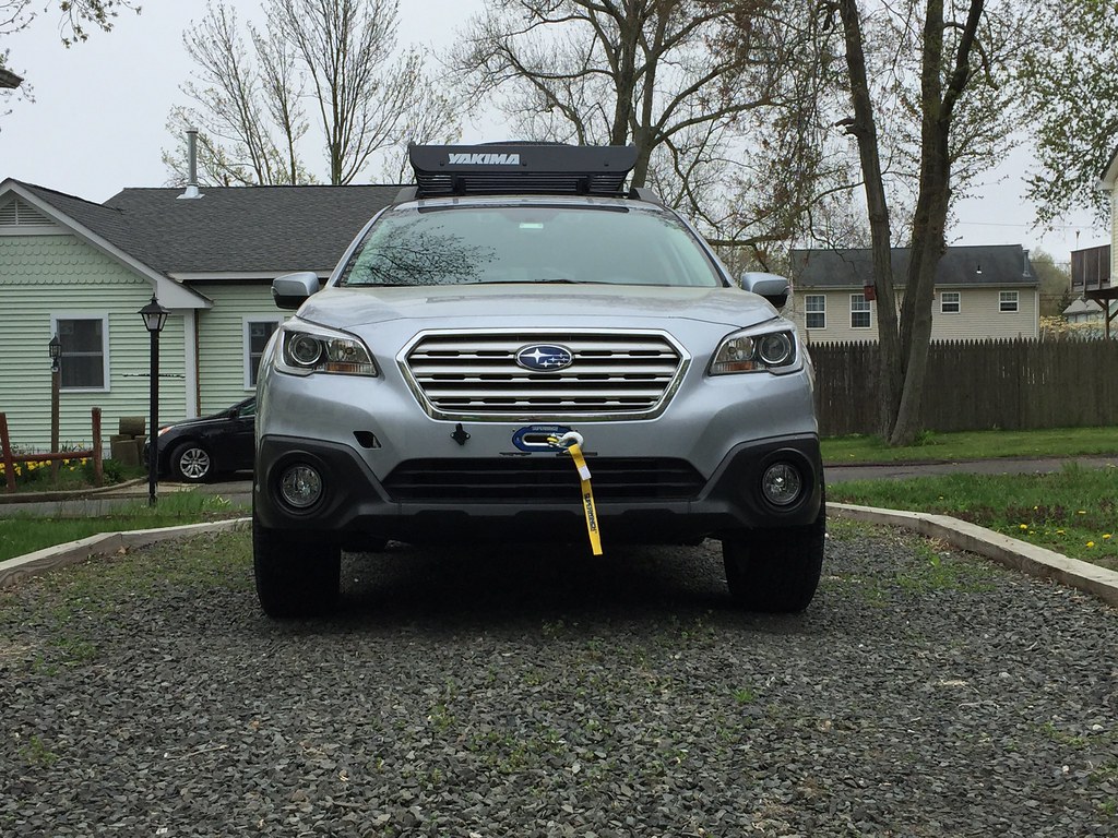

So that actually brings us to today, current times

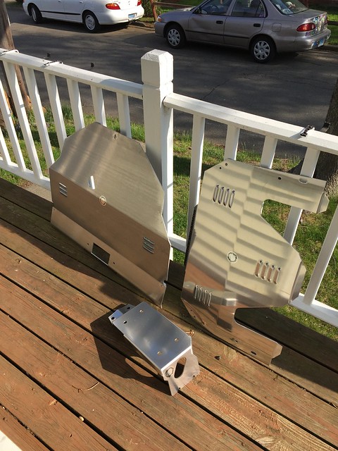

Stuff is starting to show up in the mail

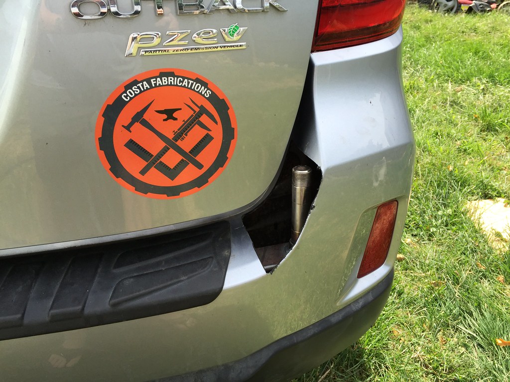

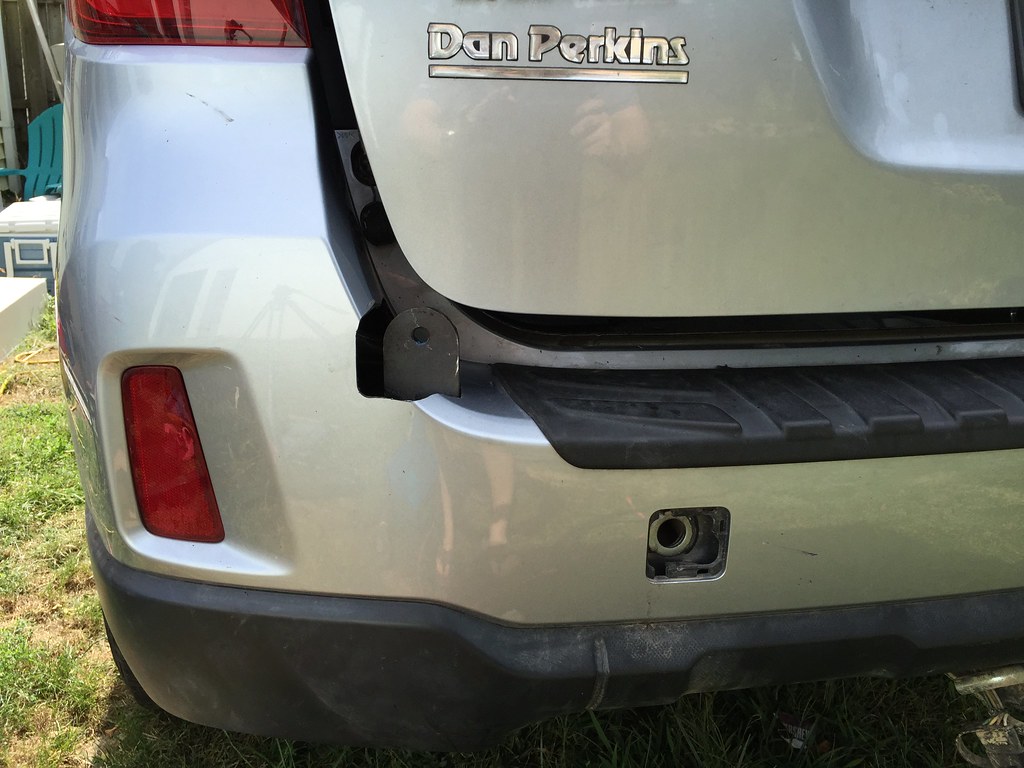

rear recovery point:

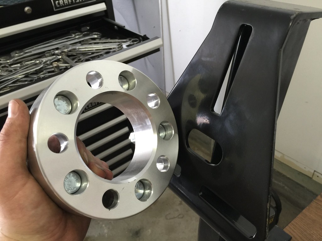

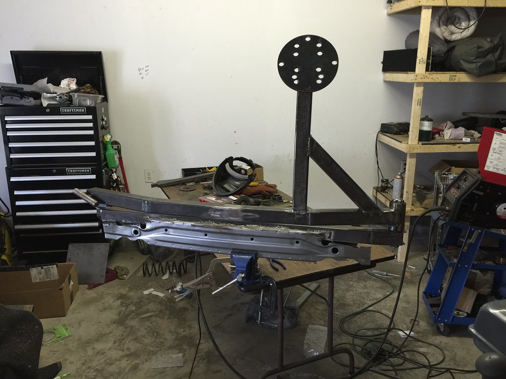

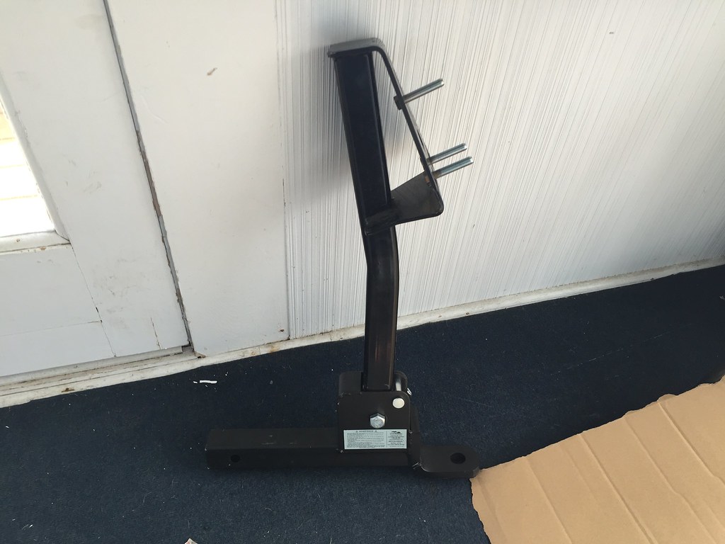

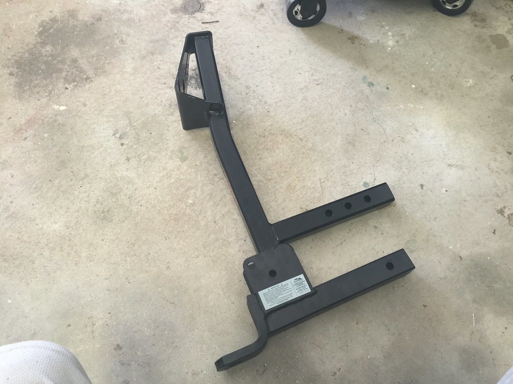

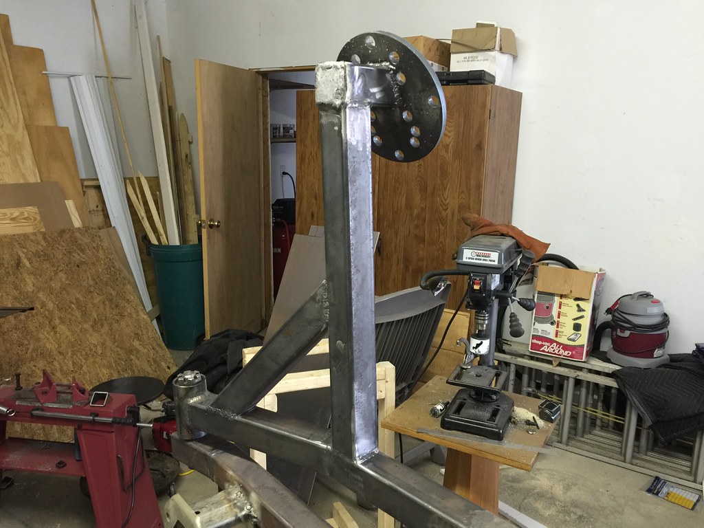

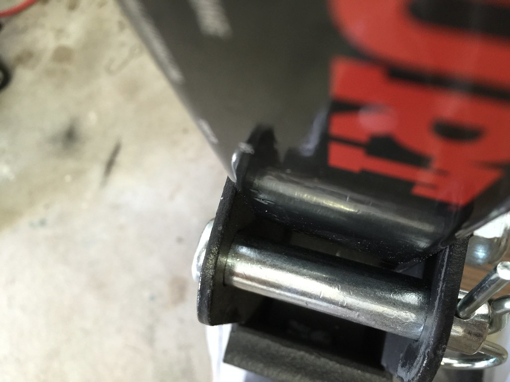

Top is the stationary rear tire carrier, bottom is the unit i have to make work with it

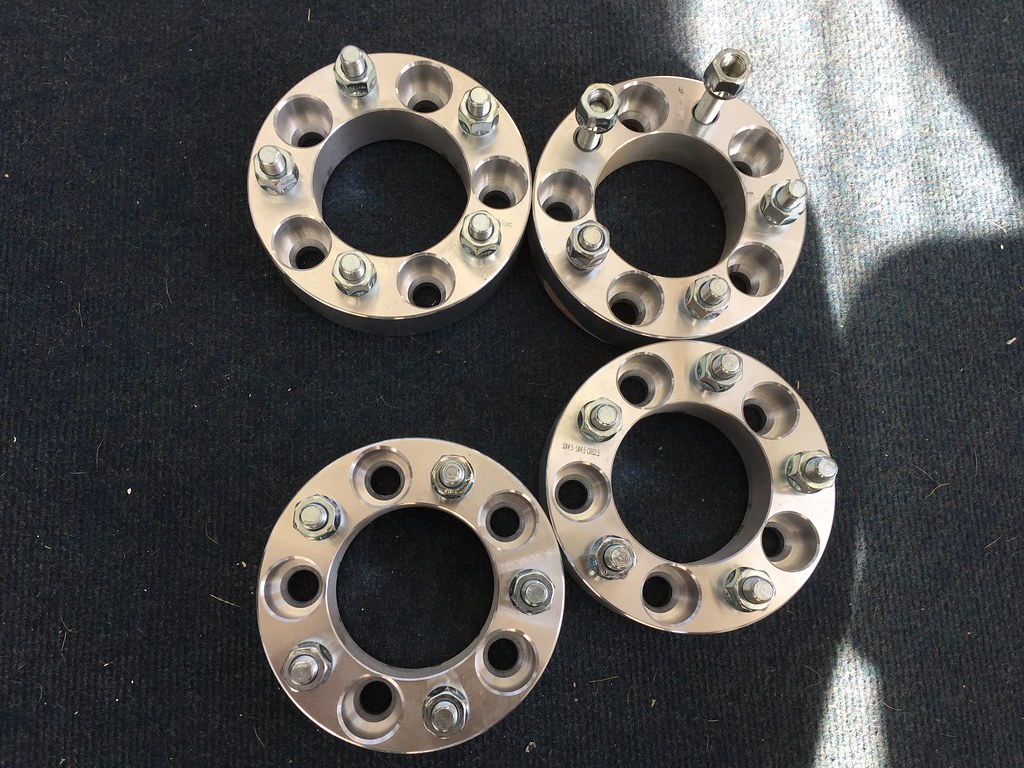

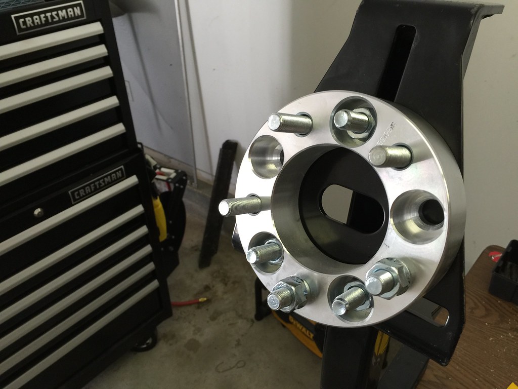

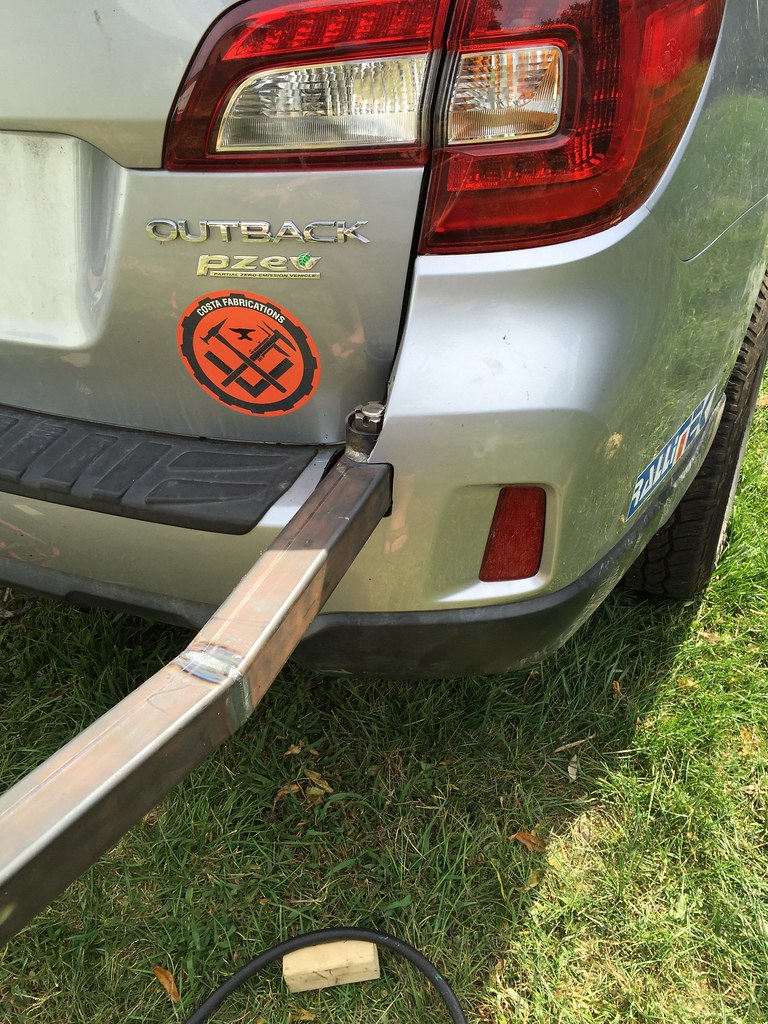

wheel spacers!!!

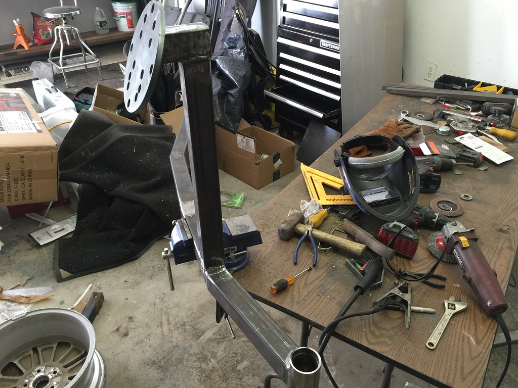

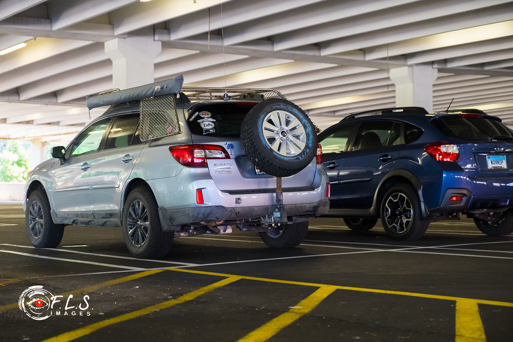

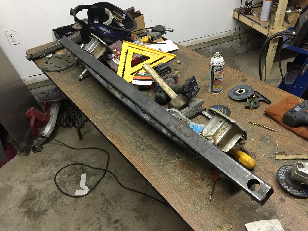

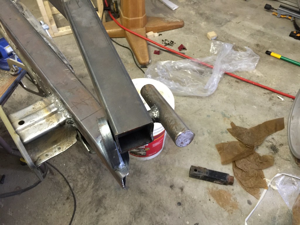

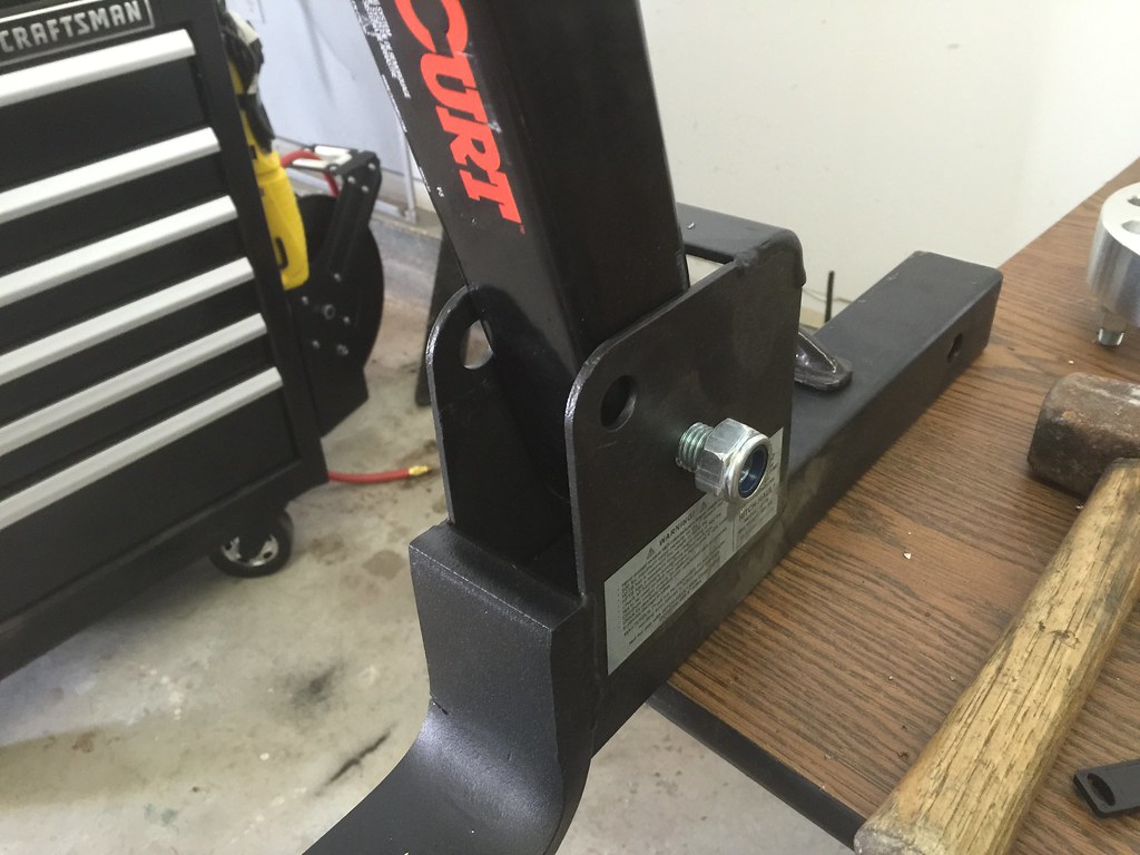

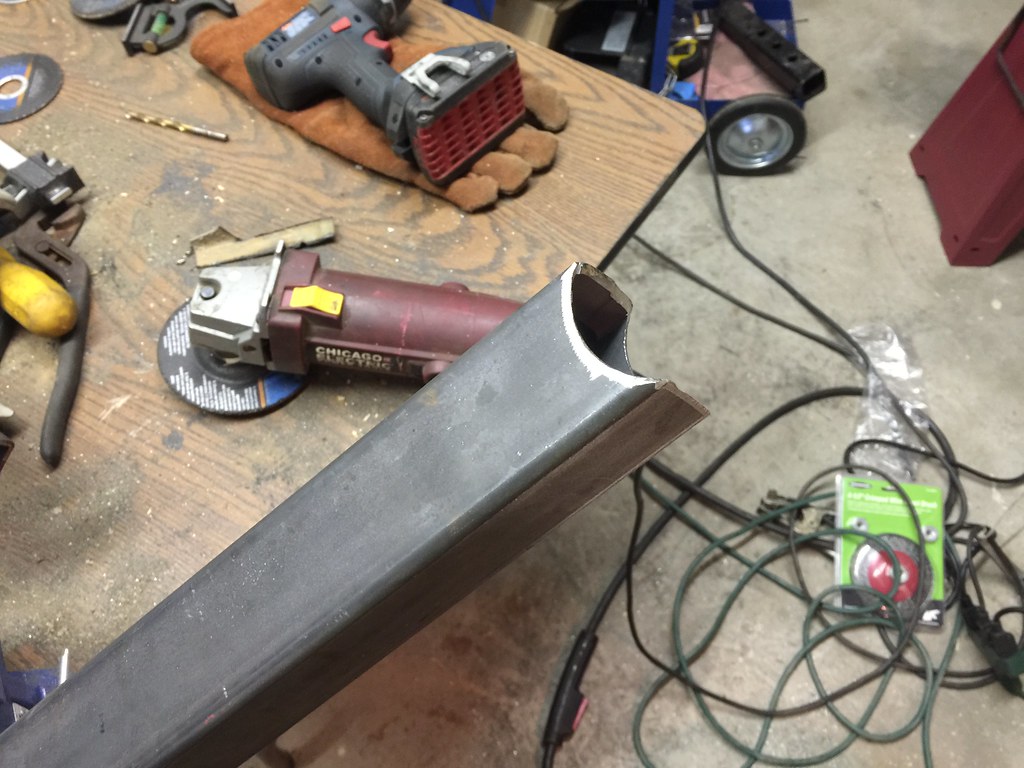

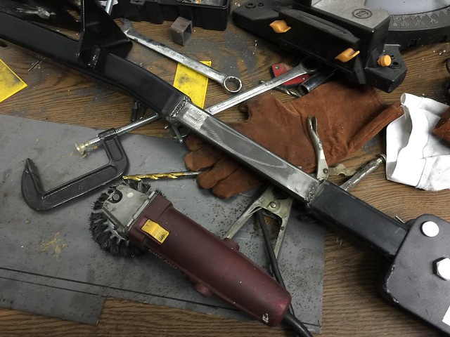

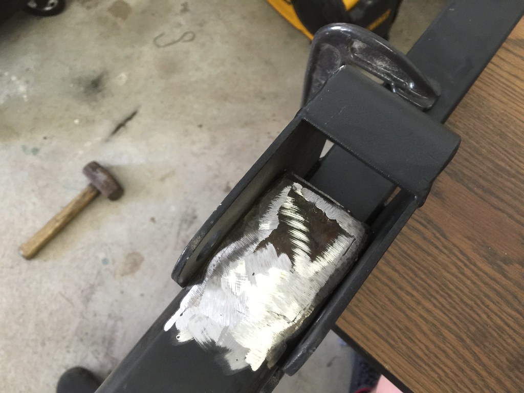

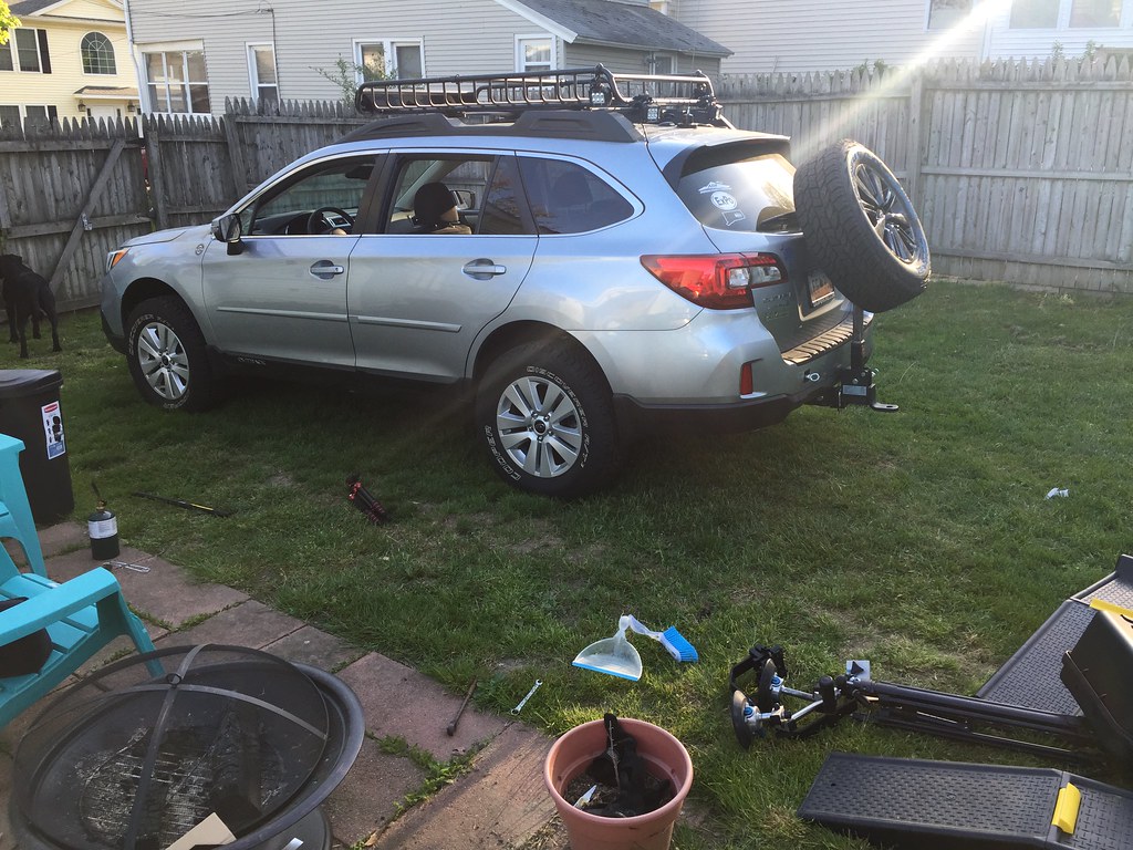

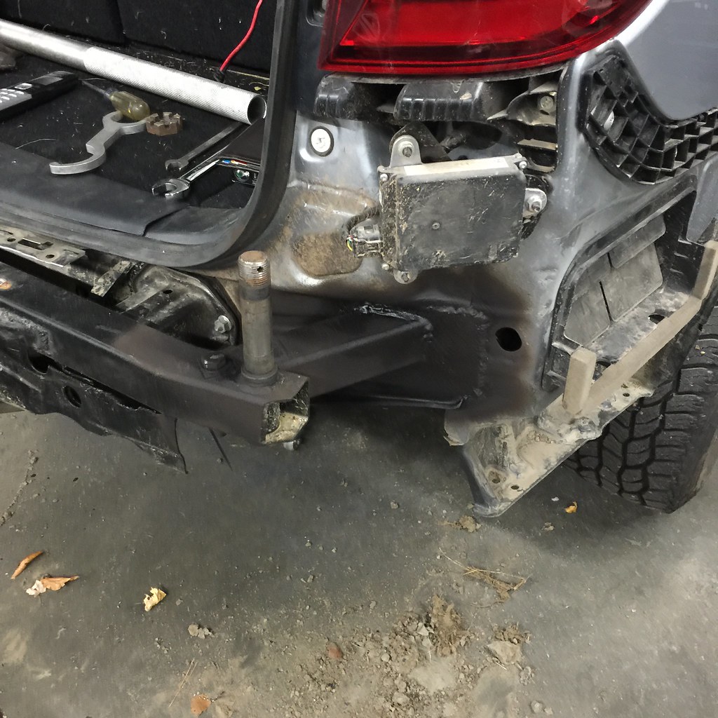

I went ahead and put together the rear tire carrier. I started with what you saw above and got to work
cut off the part that would slide into the hitch
and make it nice and smooth
slide into the area the rear rack would normally go.
grantwilson
2,886
St. augustine, Fl
1616

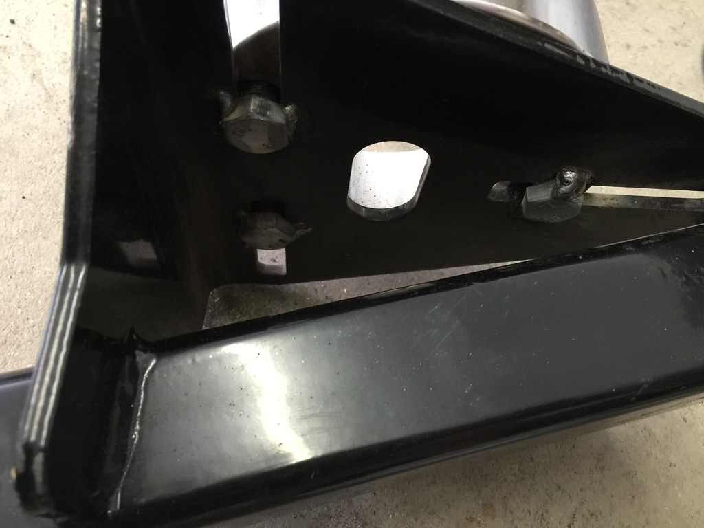

make some holes and throw it in
Ill be covering the pin in maybe a rubber hose to snug it up?
used a wheel spacer to set up the studs
bolted it down to position all the bolts in the slots

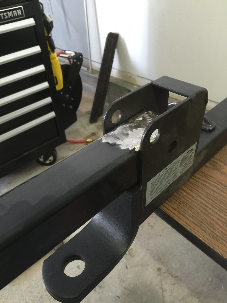

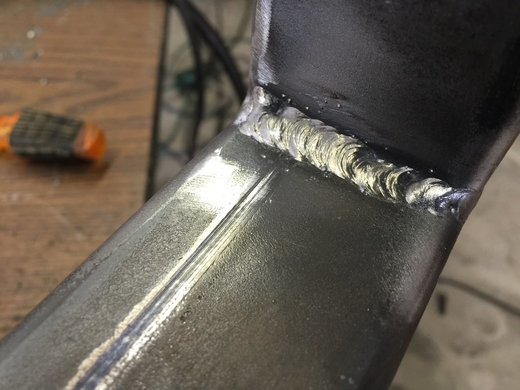

lay down some ugly welds (dont have gas yet :/)
and its done

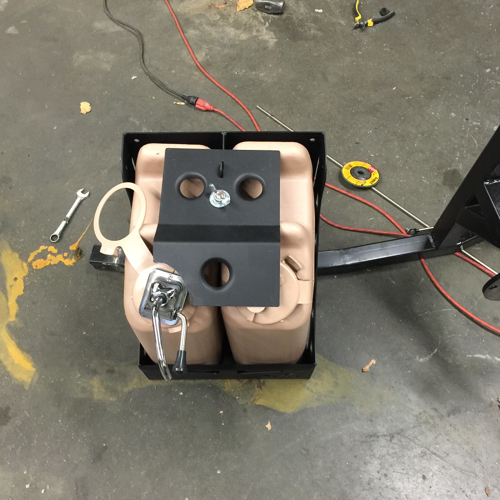

waiting on my torklift hitch and i can put it on
grantwilson
2,886
St. augustine, Fl
1616

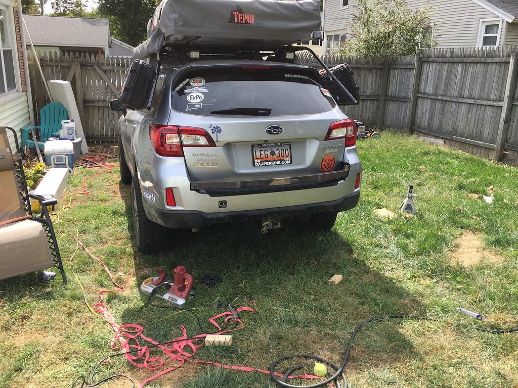

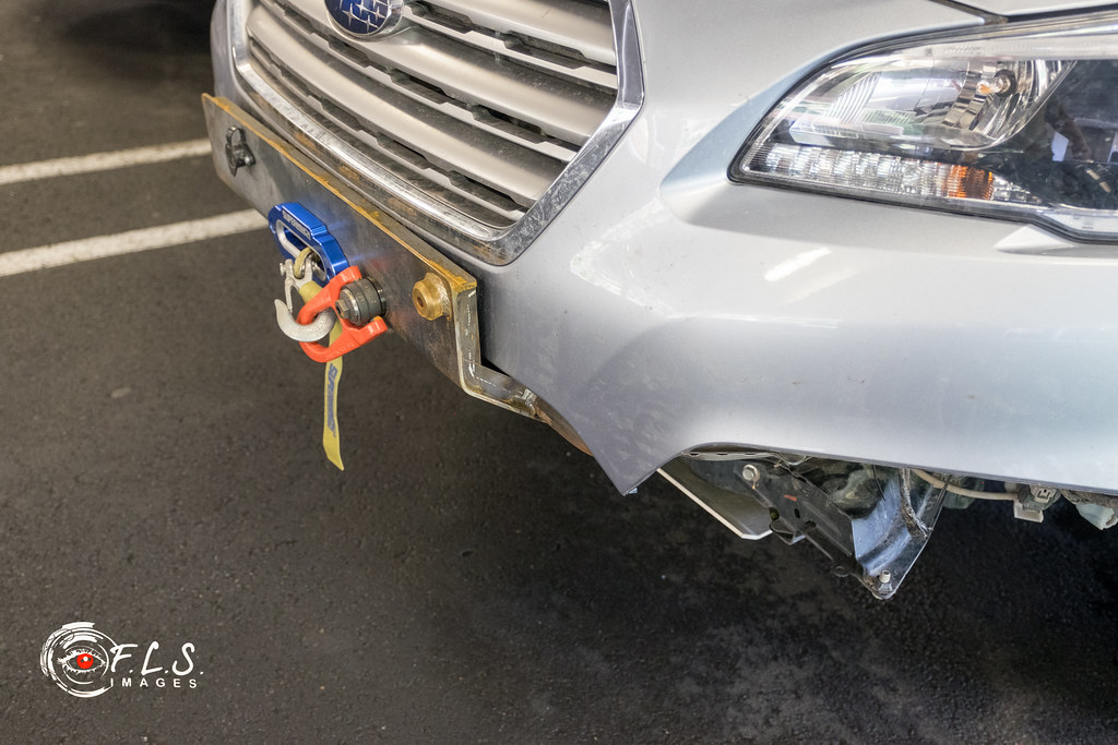

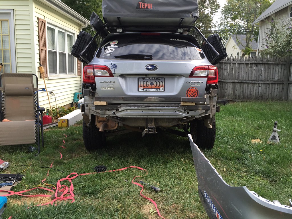

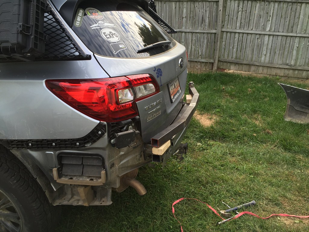

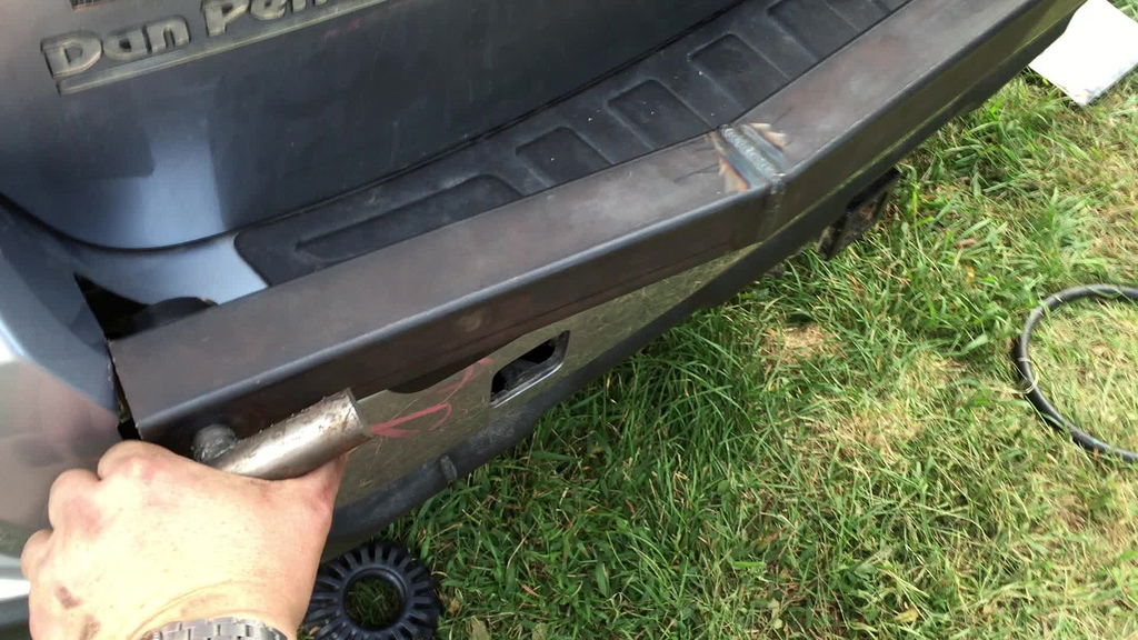

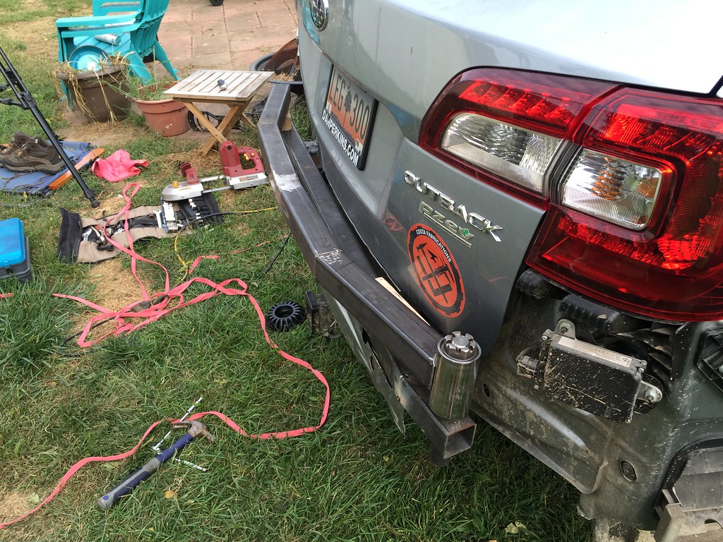

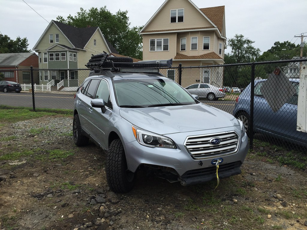

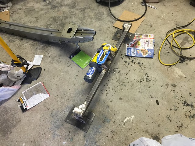

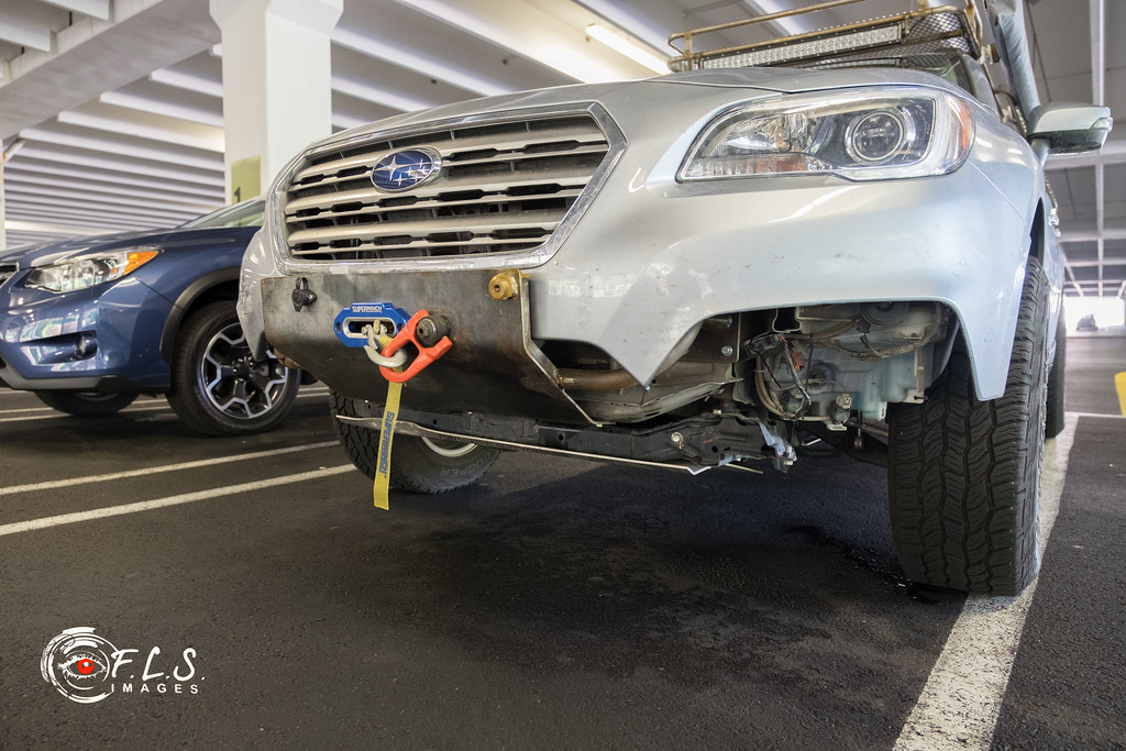

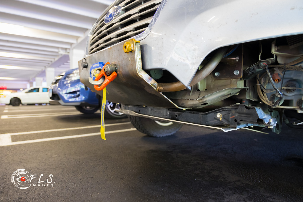

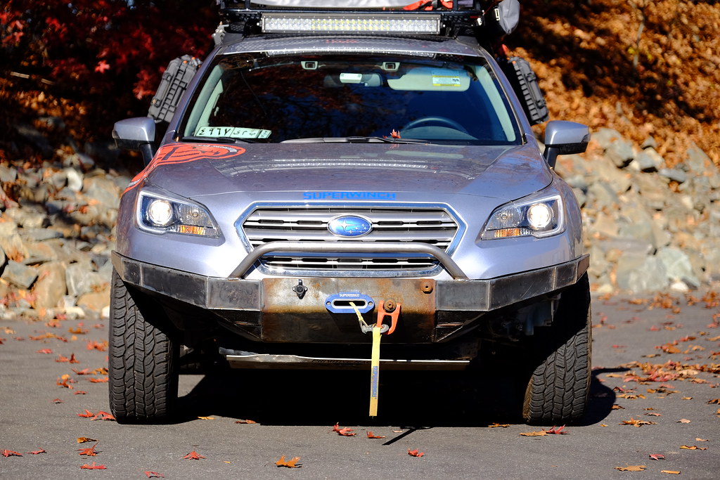

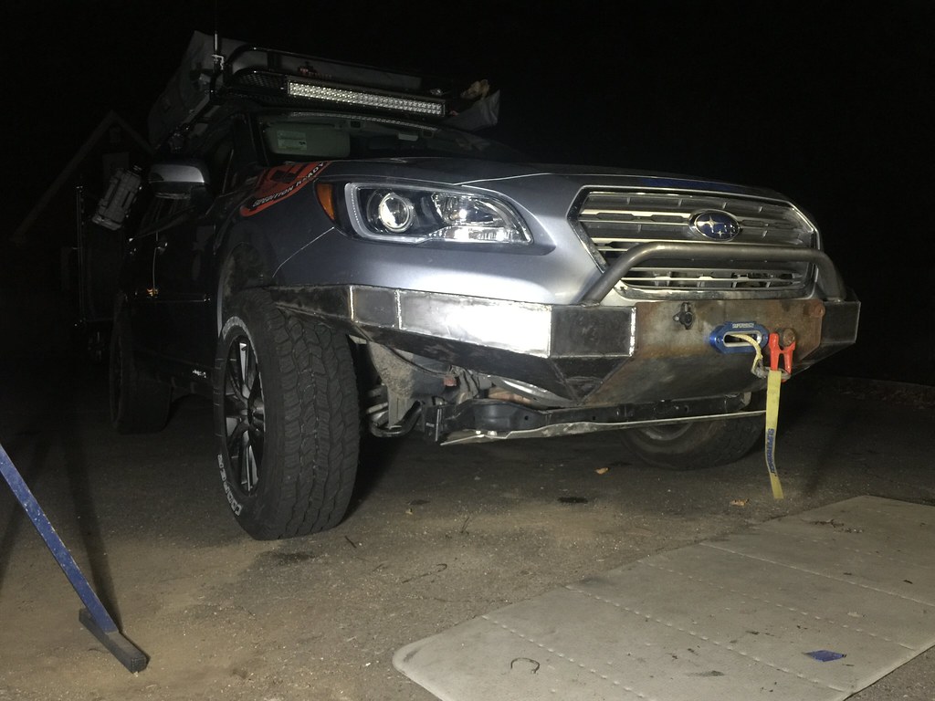

hitch is installed. the rest of the welding on the winch mount is done, had to raise the hitch mount tire carrier to look right, welded that all up. i have a bunch of welded bare metal stuff. but whatever. i threw this car together in like a week and a half
Untitled by Grant Wilson, on Flickr

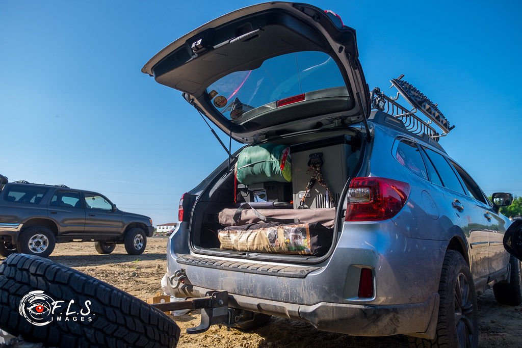

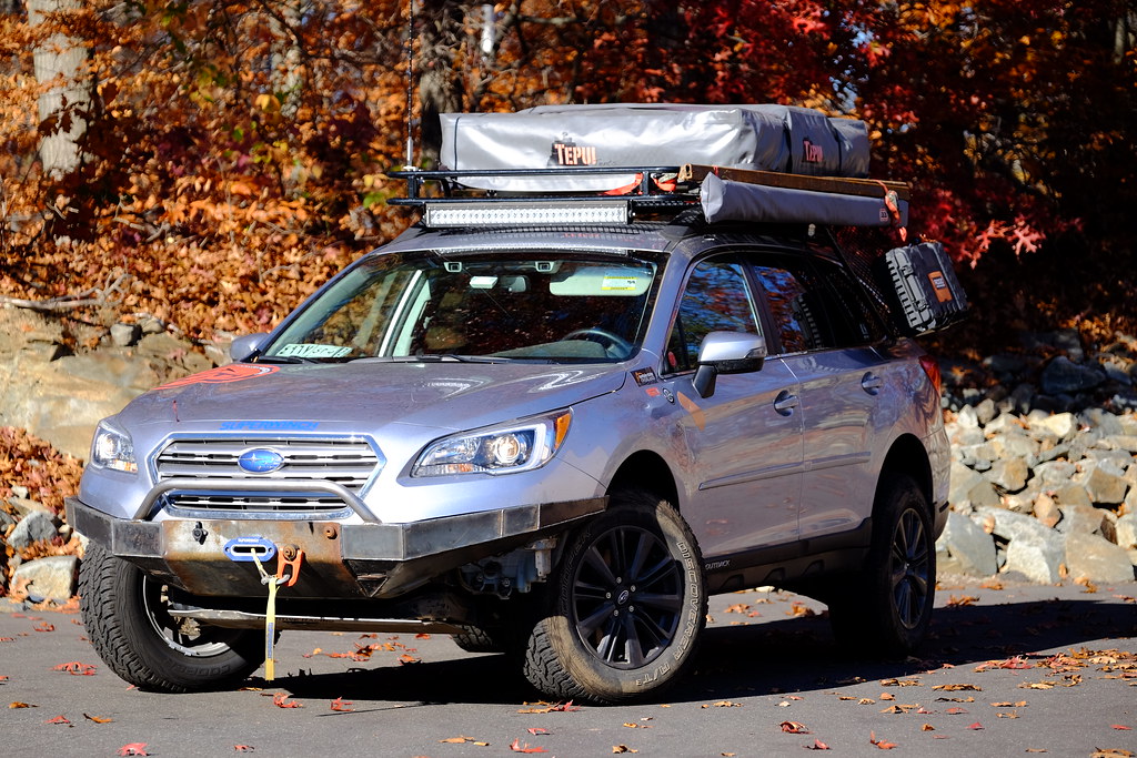

so i have a TON of video to go through. Onboard, from behind via trailing and ahead via lead car. give me time to sort and edit.
until then, here are a few pictures:)
2015 Subaru Outback Expo by Grant Wilson, on Flickr

moutned my matrax

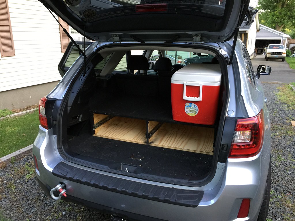

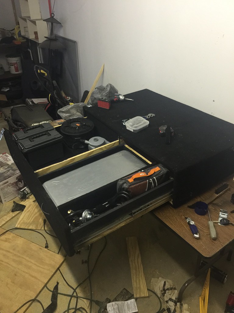

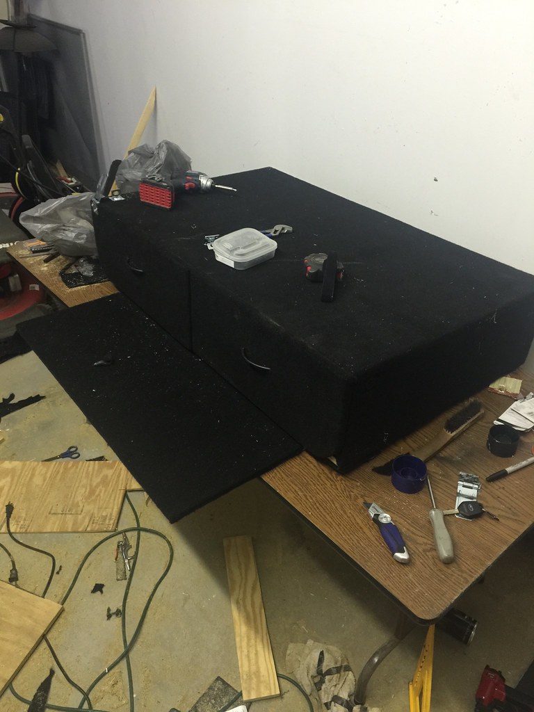

installed train horns and almost finished with my rear drawers
fit perfect. gotta cover hte drawer faces and done
led bar installed
drawers are done
they are just high enough to fit the harbor freight ammo boxes for stuff like stakes and batteries and such
the black part with the drawers closed, actually finishes covering the spare tire well and allows access to the tools and recovery gear that is stored there.
i DO need ot make one more set of dividers to hold hte ammo cans from sliding back, but other than that, im done

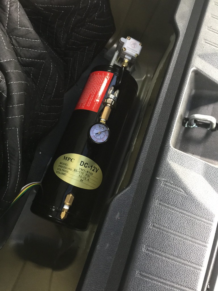

water tank is sitting there. ill wire it up tomorrow

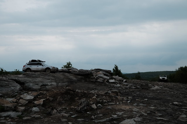

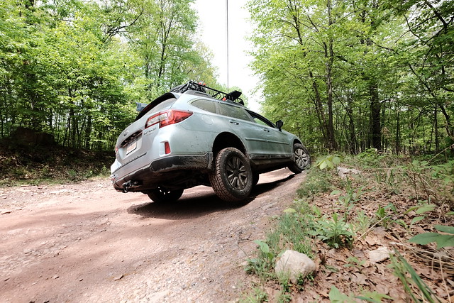

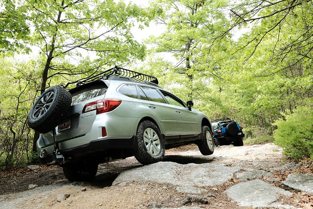

havent forgotten about you. went wheeling this weekend
ill get you more info the coming days
(click that one, its a video on flickr)

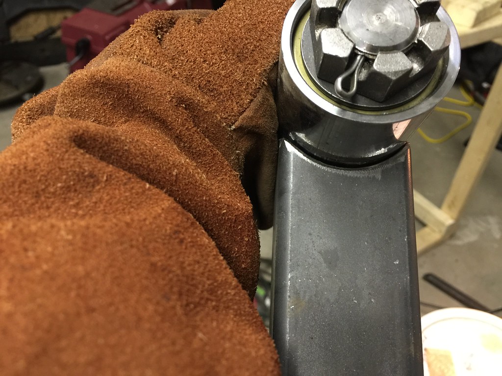

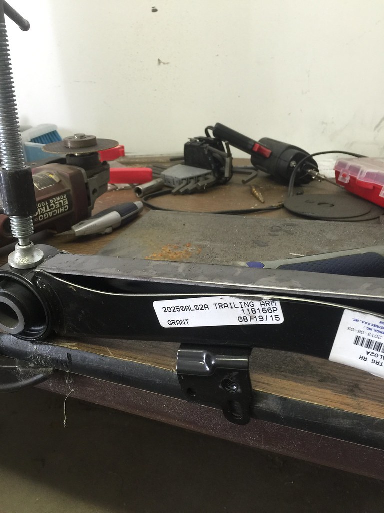

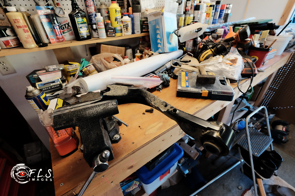

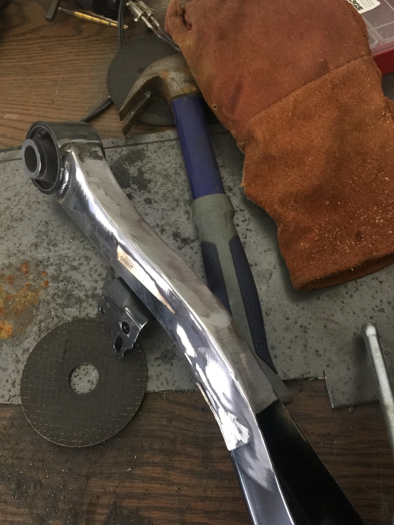

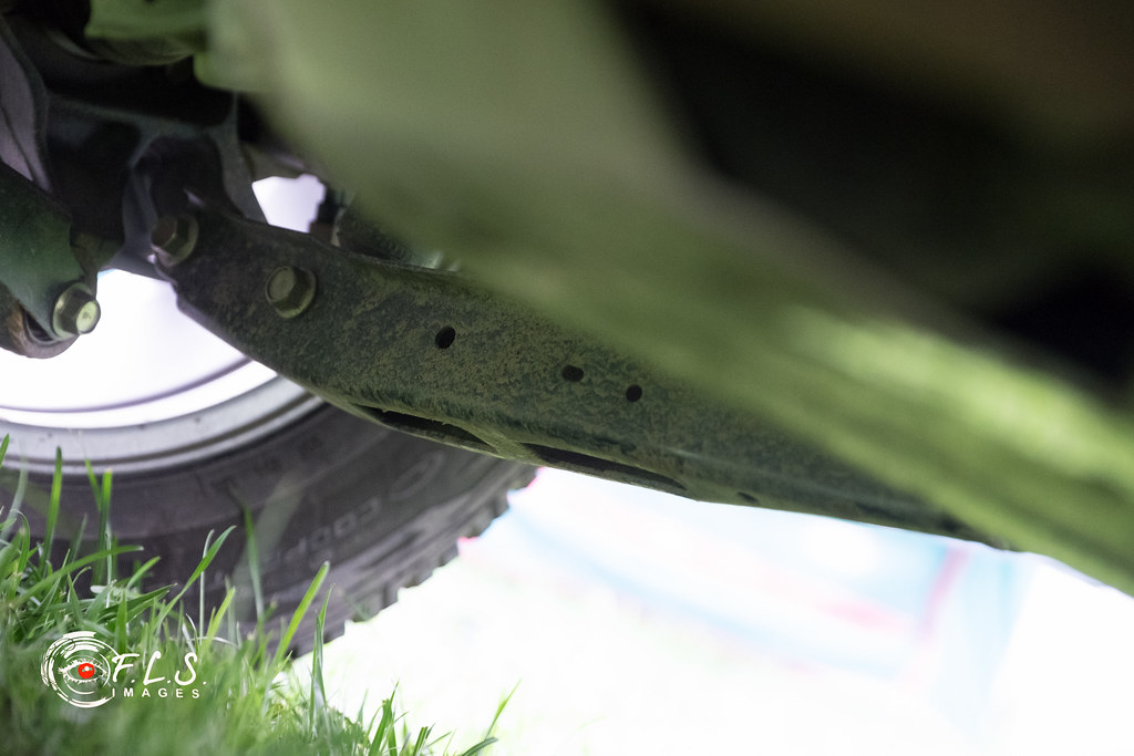

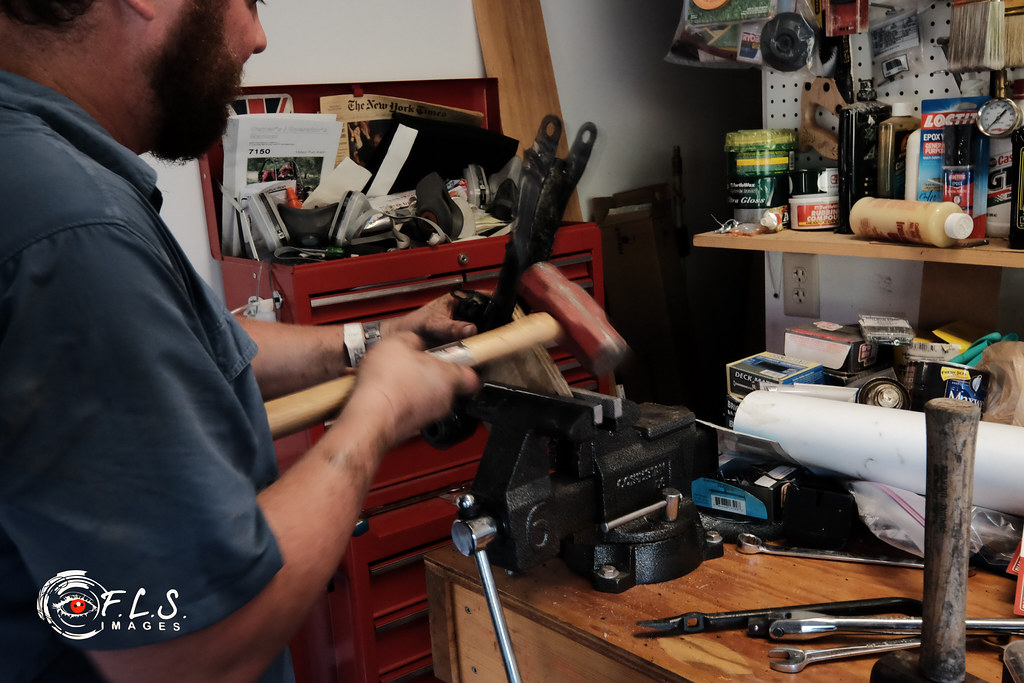

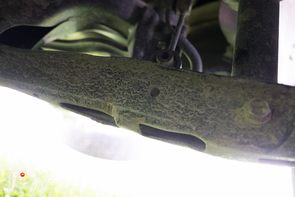

some wear and tear
good control arm by Grant Wilson, on Flickr
good side
dented control arm by Grant Wilson, on Flickr
not so good side

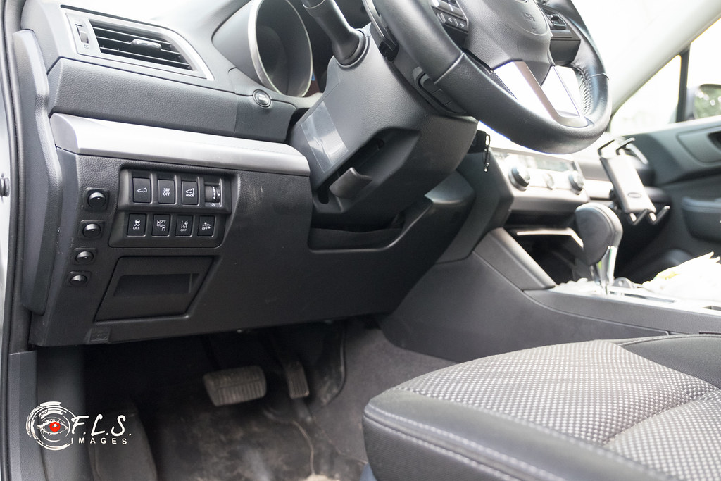

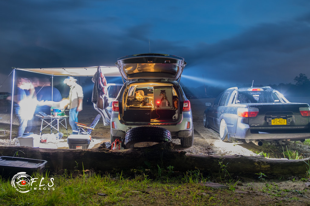

Subaru Outback Switches by Grant Wilson, on Flickr
switches
Subaru Outback Packed up by Grant Wilson, on Flickr
all packed up
camping out by Grant Wilson, on Flickr
cooking some grub

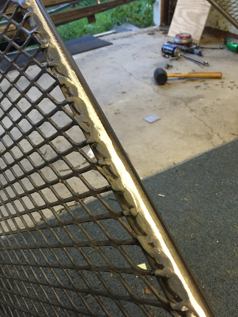

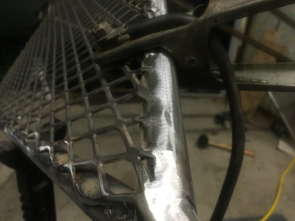

Taking Care of some Pretty finishing work before i get it powdercoated.
welding every single edge of the expanded steel, then wire wheel, then flapper wheel. Since im powdercoating, should flow in well.
The devil is in the details i truly believe. Small things like this set it apart from off the shelf things.

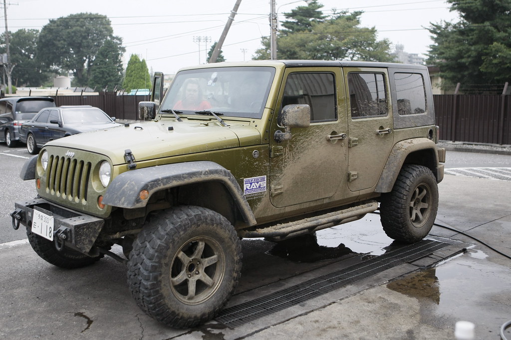

So. youve seen the jalopnik so you know i had a 4dr wrangler
You will note i never said i was TRYING to go where they do....just that it is able to. Plan for what you want, build for worst case.
IMG_9277 by Grant Wilson, on Flickr
thats Mt Fuji in the background.
_97T5620 by Grant Wilson, on Flickr
And i also had an outback:
Camping Nov 7 by Grant Wilson, on Flickr
you can see it there behind hte jeep a bit.

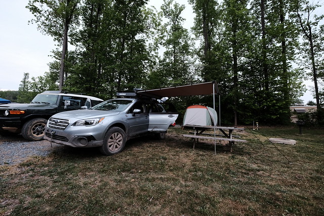

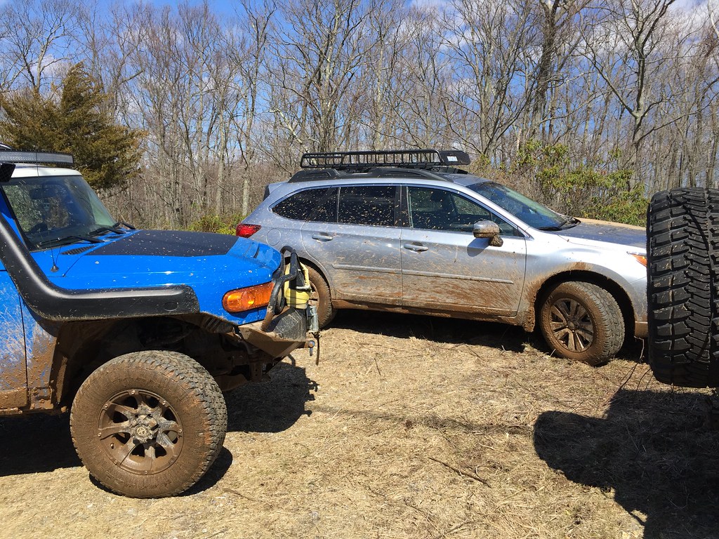

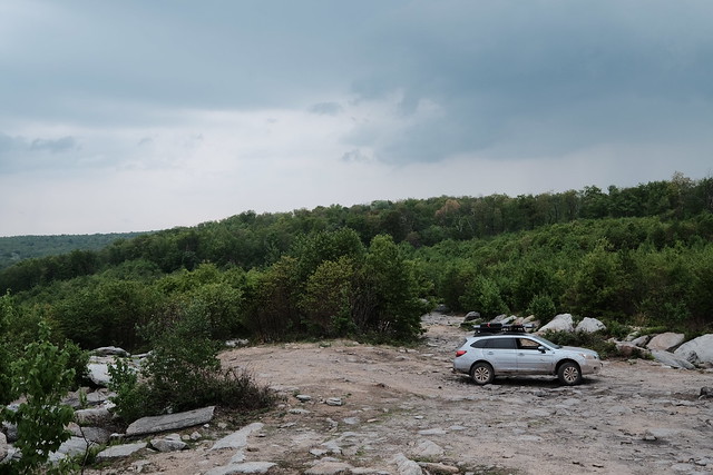

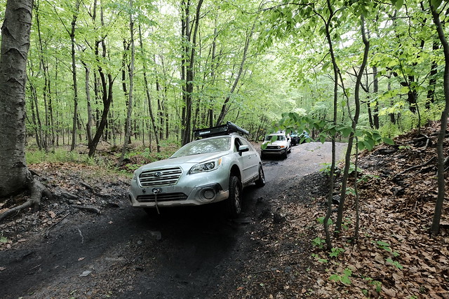

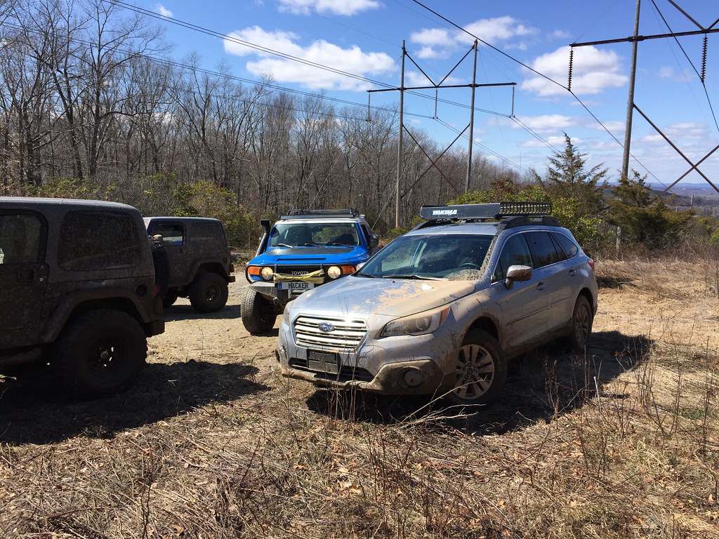

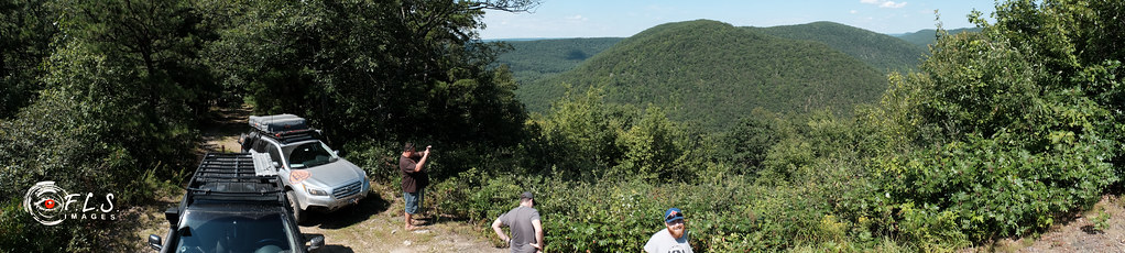

I went up with the Exploring NH guys this weekend. Did an "easy" trail with them, found ONE spot where it took a little effort because not having a REAL low range. it happens. thats why i have a winch if i need it. My car is currently overloaded (springs havent came yet) and my rear control arms were dragging a rock not letting me get a running start. I already knew the limit, and opted to bail out on the harder stuff later in the day.
I have nothing to prove on the trail. Im out to have a good time, hang out with people, and camp. wheeling isn't even required. Im super happy just poppin a spot next to the ocean or a lake or a waterfall and hiking.
I have been through rausch twice (and you didn't even see the ****ty stuff honestly. it was almost 4 hours of wheeling) and a few other runs and have never gotten stuck or had ot pull line so far. Its more than i can so for guys on the same runs that ive been on.
I dont see the lack of a REAL transfer a case to be a HUGE issue, but it is one that has to be considered. It does pretty well. Like i mentioned above, i hit a rough spot this weekend at about a 35-40% grade and rocks. Pretty much the worst case for this car. It took about 5-8 minutes, but found a line that worked and pulled it over without pulling line.
To be honest. If Toyota, Jeep, and MAYBE nissan were up to snuff on technology, i would have prolly gotten a 4 runner, or an xterra. I really wanted adaptive cruise control, and neither offered, or planned ot in the next few years. I need to buy a car at THAT time (just moved back from the desert, and needed a car in the US). I had a 35k cash budget, and this was the best overall bang for buck for what i felt at the time are my requirements. I knew i would be doing all this stuff, just as i knew i would with my jeep.
as for possibility of damage...isnt that any vehicle? We all put thousands of dollars in rock rails, skid plates, control arms etc on our trucks to deal with rocks right? FJ IFS drags over damn near everything. ive seen it. Its just part of playing with rocks.

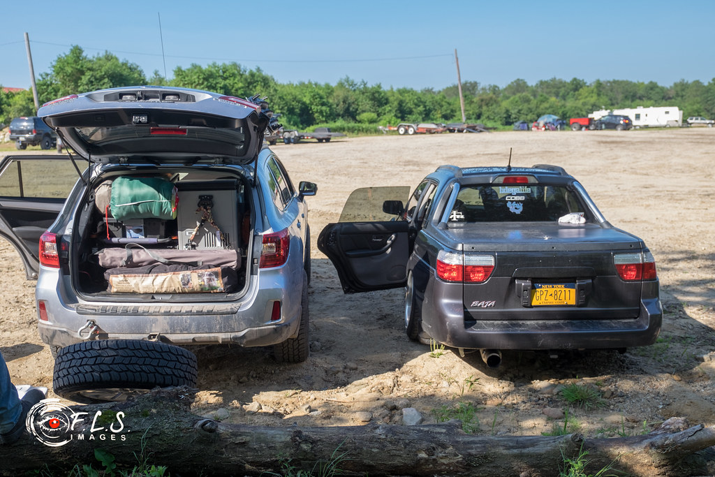

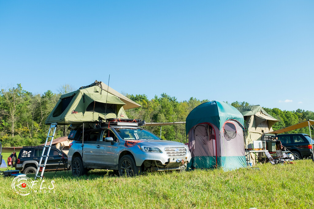

holy crap what a weekend
Mid Atlantic Overland Fest by Grant Wilson, on Flickr

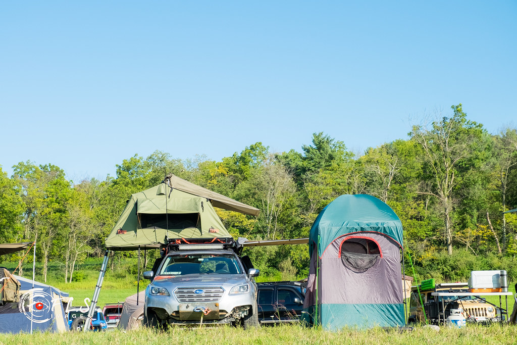

bent a trailing arm on an offcamber backing down and just sitting wrong. weight of the whole car went on the back right wheel. crush. was able to straighten it and get home
overall it was a great weekend. good times and reat people at the MAOF
star trail maof by Grant Wilson, on Flickr

so after i tacod a trailing arm, i ordered a new one. 40.00 with bushing
not gonna ****ing taco again is it...

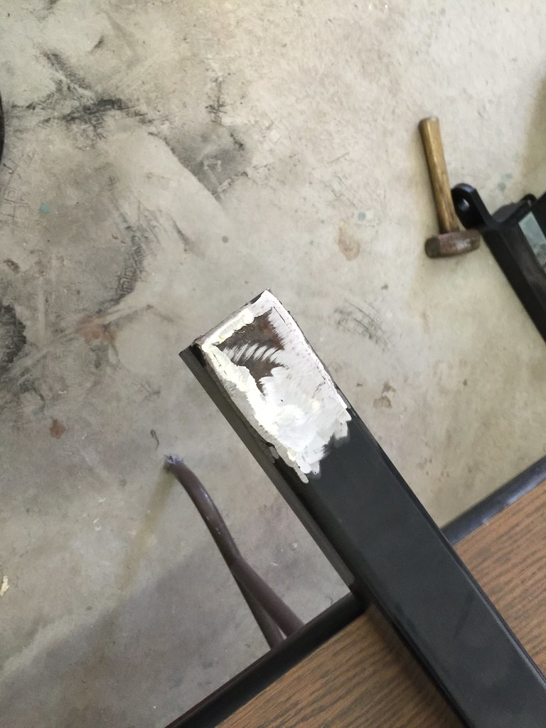

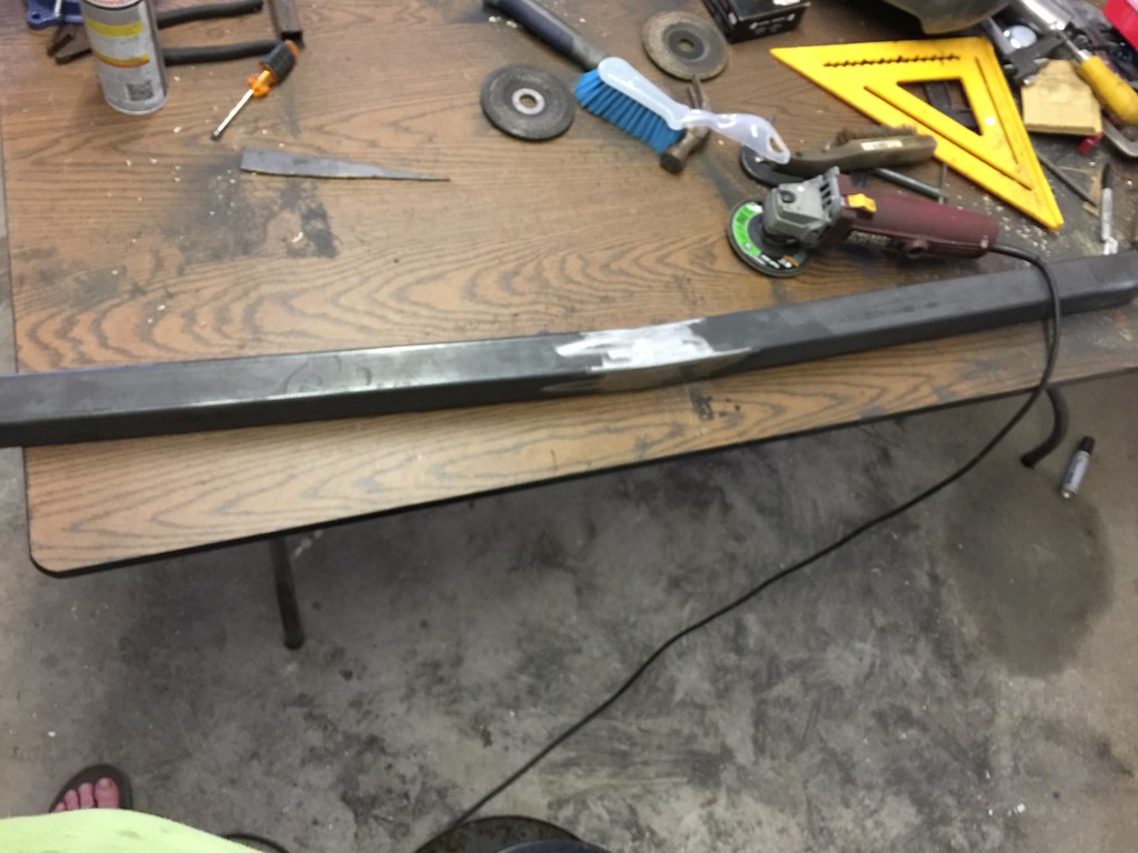

started the bumper swingout for the rear.
doesnt seem like much. this is the bar that will run behind the hatch that the tire and cans will be attached to. about a 10* sweep to match roughly the hatch. ill work on the tire mount and bearing mount tomorrow

working on the tire carrier. this will be the bar with all the stuff mounted to it
and then the main support bar nestled into the bumper support
soooo i did some more things
getting the heavy welding done at work for all the joints, bearings and bearing post then i can build out the spare tire holder and water can portion hopefully in time for Overland expo east
grantwilson
2,886
St. augustine, Fl
1616
So. swingout is done MINUS the water can holder. just need 3 bolts to mount the wheel and its all done. I still need to figure out what im going to do about a water carrier. Anyone wanna contribute a two can idea?
After VT ill have it powdercoated. ill just spraypaint it for that.
proposed mock up
im no pro, but it will work id say
click for video

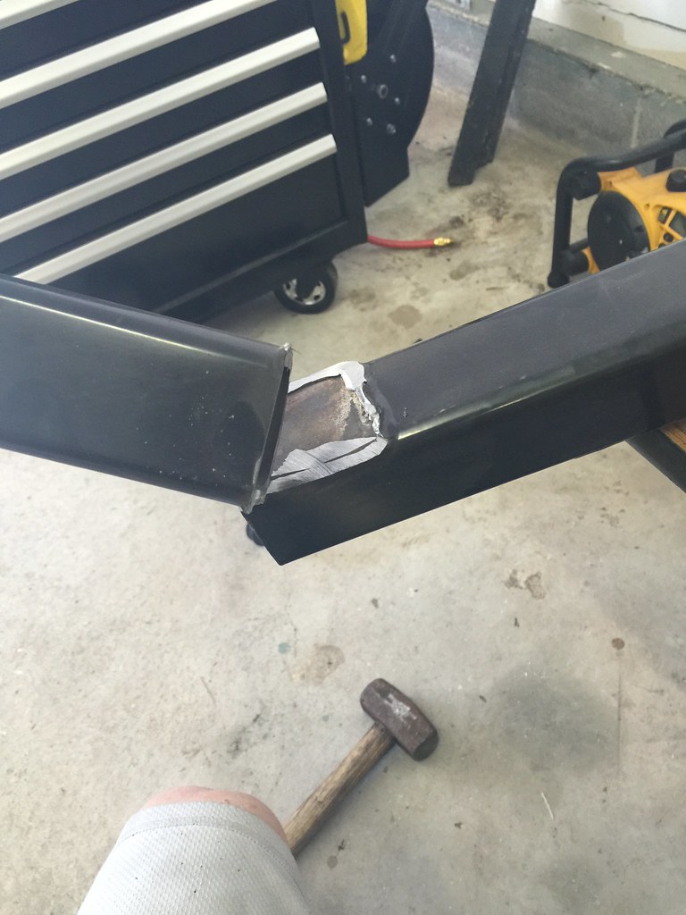

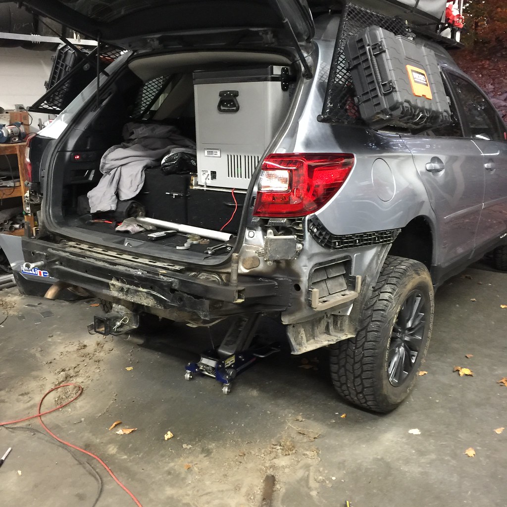

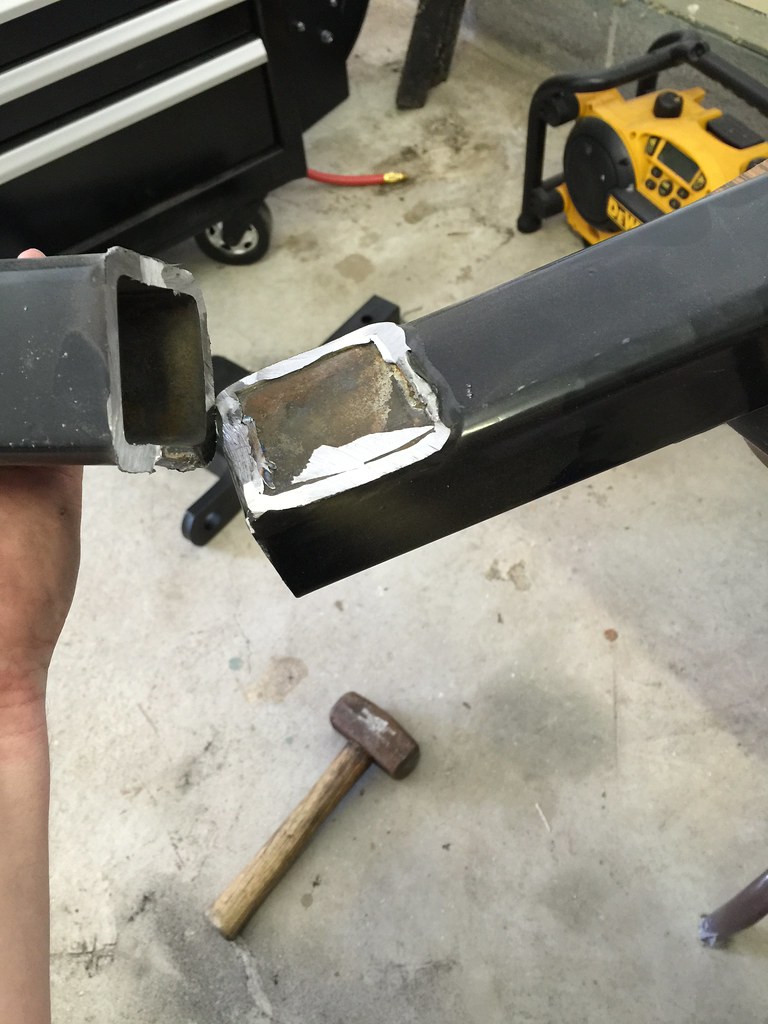

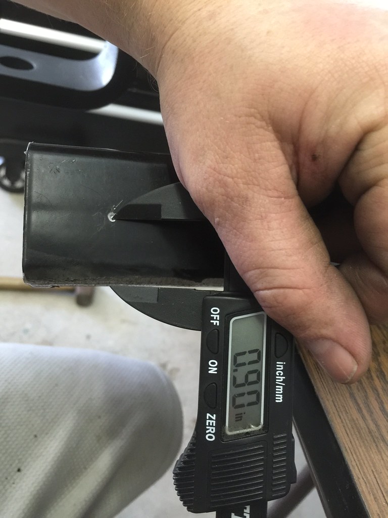

SO i have made the first irreversible modification to the subaru
I had issues with the tire carrier moving fore and aft in relation to the car, and it annoyed the **** out of me. So I decided to beef it up a bit
I used 1/4 plate, with 2x2 1/4 wall tube and some 1/8 strips for bolt tabs
The main assembly slides into the braces and bolts in. Fixed everything and zero issues now
Oh and i notched for my pump spout
Headed up to boston this weekend to have the front bumper finished up.
A little sneak peak before I get it all done and jazz.
Finished up the front bumper. Still need a little finish work though. ILl work on it
Overland-Indiana
3,316
Kokomo
0750
Cool rig, you don't see very many of these being heavily modded like yours, nice work!
