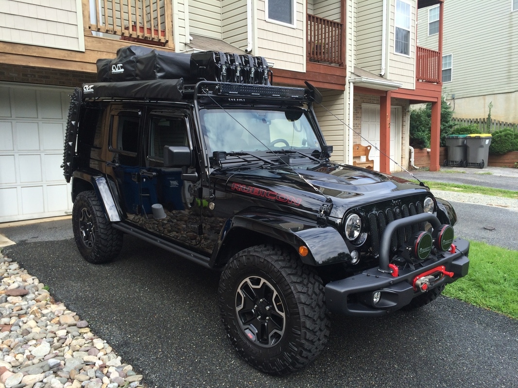

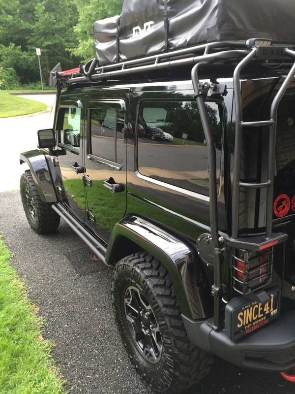

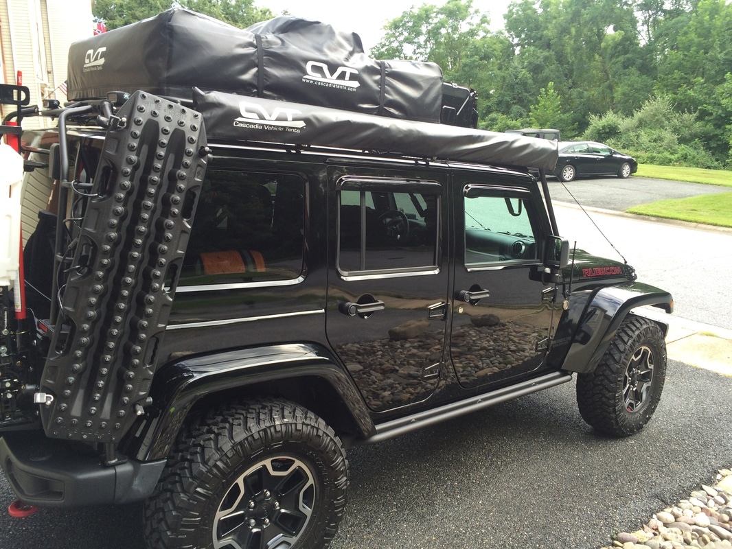

A few pics from a recent camping trip to Cape Henlopen State Park. In a few weeks, I'll put the full overland gear set on (jerry cans, Max Trax, limb risers) and head to MAOF. Fun fact, limb risers also make grab wet clothes hangers. Should get some decent shots on/offroad there. I'm curious how it will ride with all of the weight in and on top. I also think I need/want a trailer.
I took the day off to get the JK ready for the Mid-Atlantic Overland Festival next week and added some new items and took some shots of her after a much-needed bath.

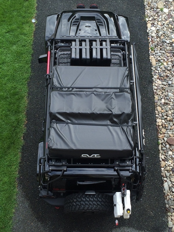

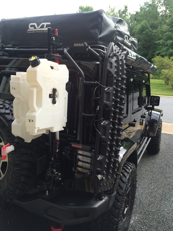

I decided that my previous location for mounting the MaxTrax wasn't going to work for stability and I didn't like them up there where I'd have to move them to unfold the tent. So I mounted them to the rear passenger side support arm of the Gobi rack. I LOVE this new spot. It's solid and stable and secure. (And it looks kinda cool.) That's my BOLT lock going through them and then two master locks on the top and bottom locking pins.
Then I finally added the four Jerry cans in their Front Runner racks. I also added a shovel to the Gobi rack on the drivers side. Yes, it's red and black to match the Jeep. That was on purpose. :P

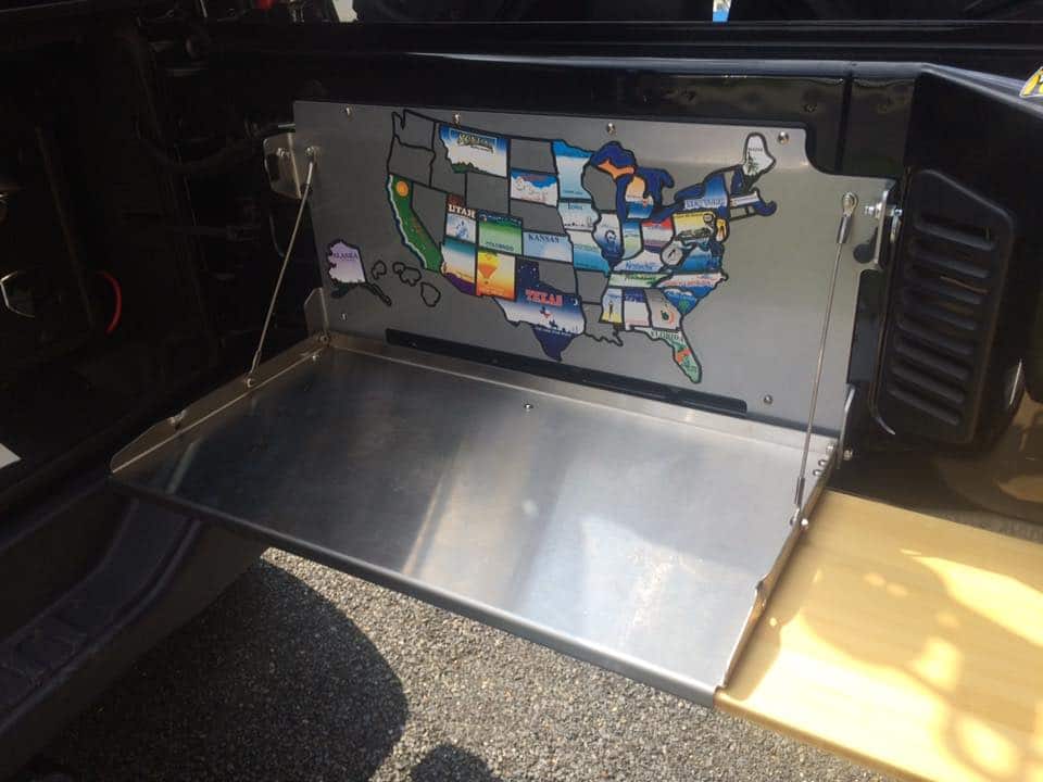

@Arkaden Where did you get that map, Chad? That is so cool with the state's license plate image on each one. I'd love to get one of those for our travels!

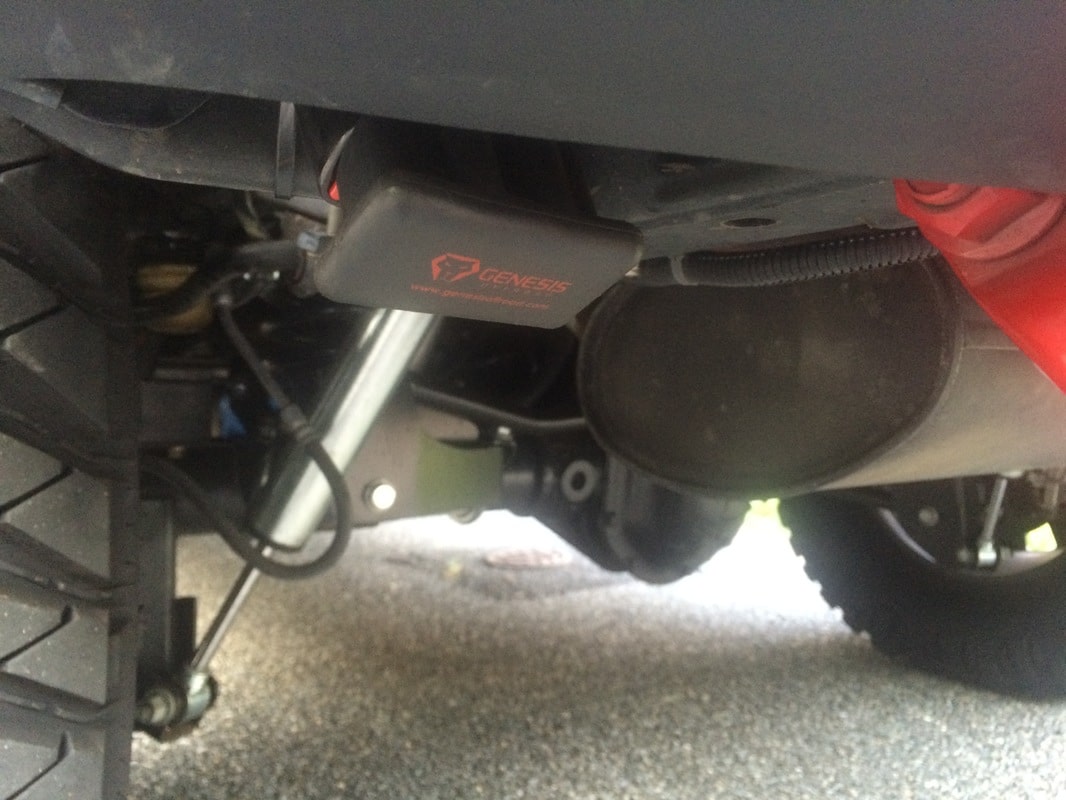

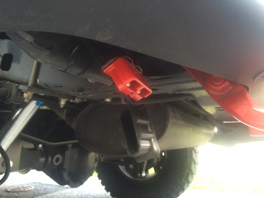

One last mod before MAOF. Added a rear 12v battery connection point from Genesis Offroad. Ran it back and brought it out the driver's side rear opposite the tailpipe. I'm not sure I'm going to keep it there as I don't like the idea of it getting submerged during water crossings, so I might re-engineer that to go inside. With the new line run, I picked up the set of cables to go with it.
Here's without and with the cover.

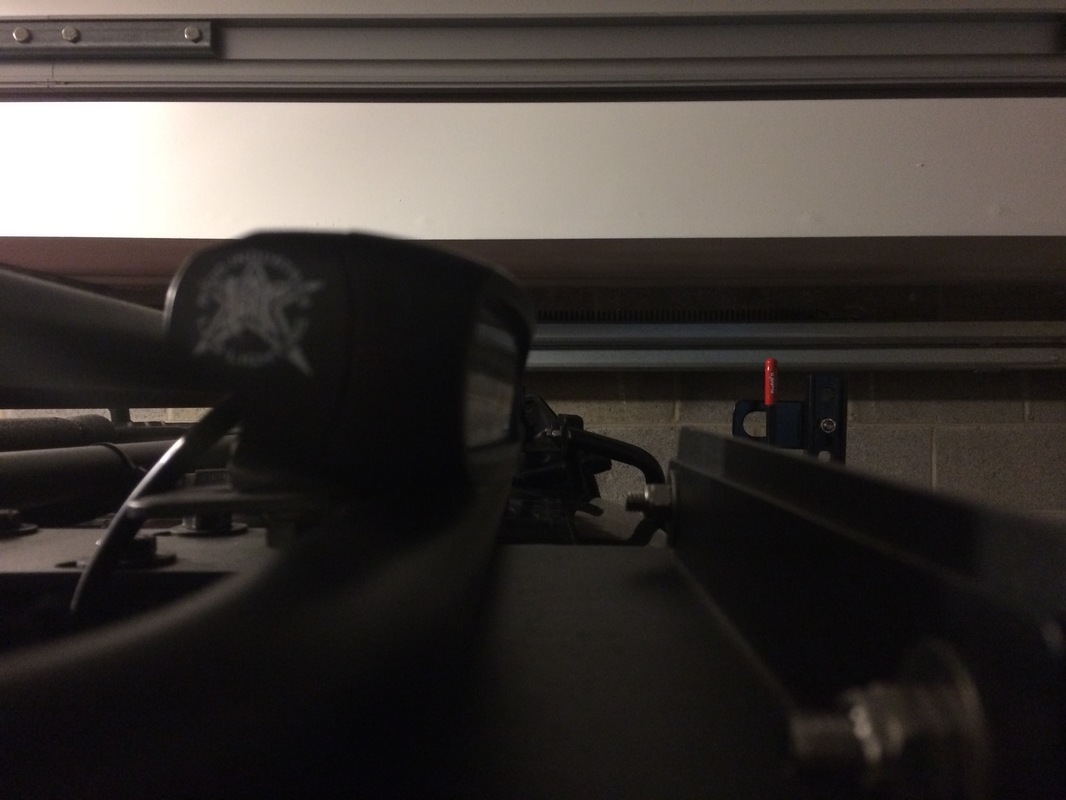

Great build tread, I am basically looking to do almost the same build as yours with my white 2015 JKUR HR. I am ordering the Gobi Stealth rack this spring and have picked up 3 sets of rigid SR-Ms for the sides (3 each side) and a set of SR-Qs for the back. I noticed the ladder mount sticks out further than the back of the rack and the light mounts are semi-recessed, so my question is, how is the light pattern/shadow off the back, I am looking to have enough downward light for camp/night wheeling, not just straight back and have a dark shadow on the back end. Do you have any night shots of the read lights on as you currently have them set up? thanks, and again great build and I love my Hard Rock!
Thanks! You're exactly right, the rear light mounts don't give you the downward clearance with the out of the box light setups. If you wanted to mount lights there and use them in a downward manner - say to light up a tailgate cook area, you'd be hard pressed to do that. You'd have to rig up something that pushed the lights up higher in the air so they could tilt down. Unfortunately I don't have any night shots, but I'm heading back out in a few weekends and I could take some. Right now, for me, the rear lights do shine on the underside of my rear awning when it's deployed but they are designed to illuminate the back up area. For my rear gate cooking area, I actually strapped an LED worklight to the rear rollbar. Because of the way the light is designed it works perfect AND allows me to take it down and move it when needed. I liked the light so much I bought three of them at Home Depot. Best $29 I've ever spent.
This image shows the rear light from the side and you can see, even with it pointed downward the rear ladder mount blocks about half of the beam. You would need to get that elevated using a longer bolt or higher mount.

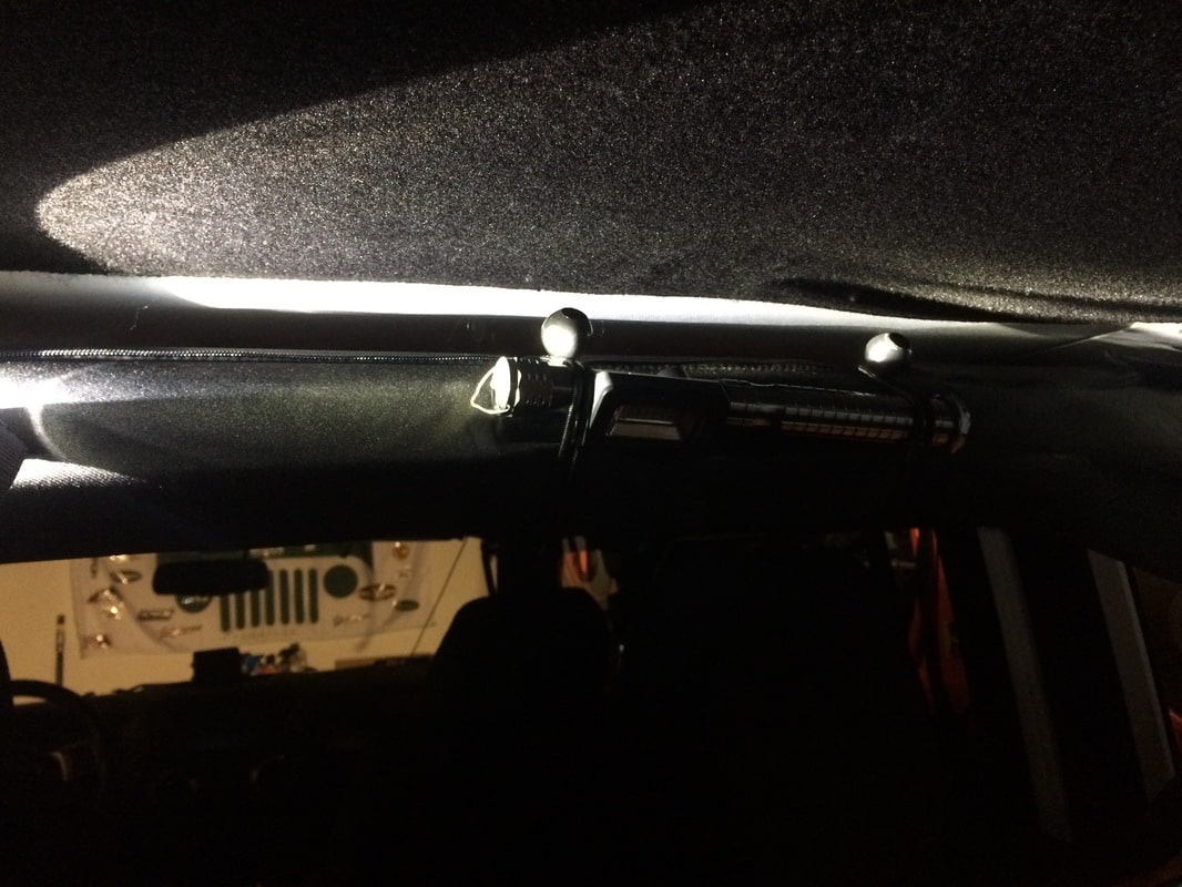

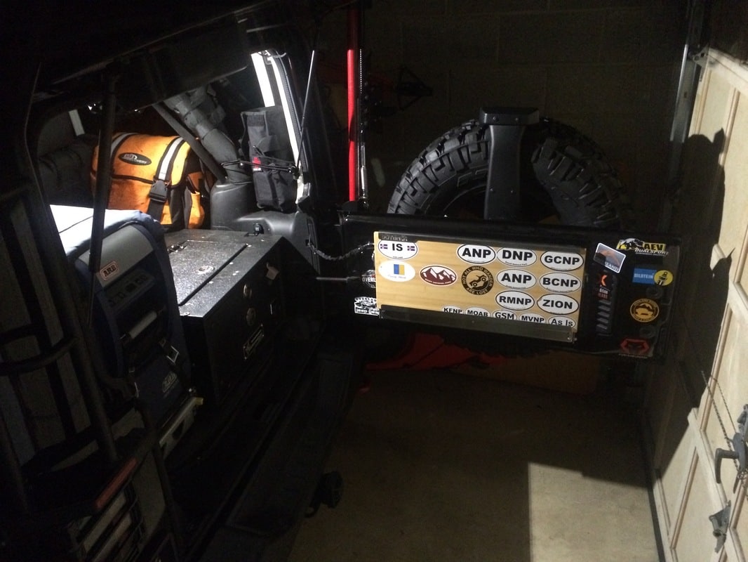

Here's the LED torch I was talking about. I just bungie balled it up there so it's secure, has a perfect angle and is easily removable. It's also magnetic in several places so I can move it to the rear tailgate if I want. Or even better, under the hood if I'm working on the engine at night.
Here's a shot of it in my garage with all of the lights off. You can see how much light it throws to light up the tailgate area.

Thanks for the pics and clarification. I love how helpful the overland and Jeep communities are with set up and questions. That angle is perfect to show the rear light and confirm what I bought, thanks! That is my only worry other than when I have the soft top on and want to use the sun rider option, which I've heard you can't do, just up or down. But I may fab some block type pieces to raise the back of the rack up from the rear supports since it looks like the whole top sits on top of it, basicsally a 1"spacer, unless Gobi ever emails me back about a custom rack with supports that are about 1" taller. I will definitely get the rack, just would suck losing the quick flip back of the soft top without having to unzip all the windows and put the top completely down. I also ordered some wiring quick disconnects as well to run my left, right, and rear lights to the spod. One day I'll upgrade my lighting spod to the 8 switch SE and keep the current 6 switch unit for the air compressor, fridge, winch, and other powered items.
