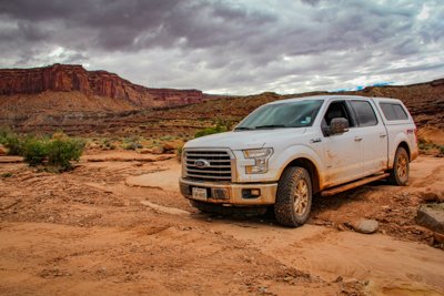

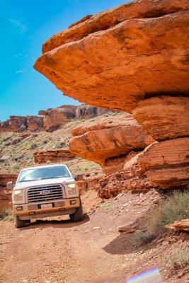

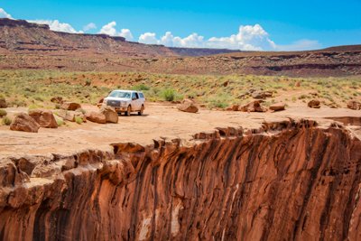

White Rim was fantastic. The only area we got close to having a problem was climbing Murphy Hogback. That was because a large bolder had fallen on the trail and it covered more than half the trail. We had to stack rocks to get over it since we could not go around it. Everything else was pretty easy, especially with a spotter in some areas. We stayed at White Crack Campsite because we only stayed on the trail for two days and that is half way. It was great, with some good hiking but no river access. It would have been nice to have our mountain bikes at camp with us.
View attachment 63491 White Crack Campsite
Looks like an awesome campsite [emoji106]

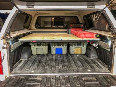

Love that 80/20 Aluminum. I made a bedrack and a rear seat delete platform out of it.
I agree. I had two lengths left from another project that were already the correct length. It did not take me long to decide to use them for the bed rails to support the deck. Strong and light weight, the two big requirements.

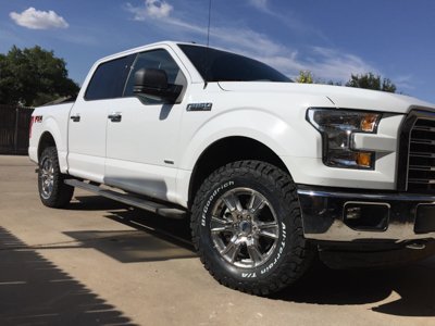

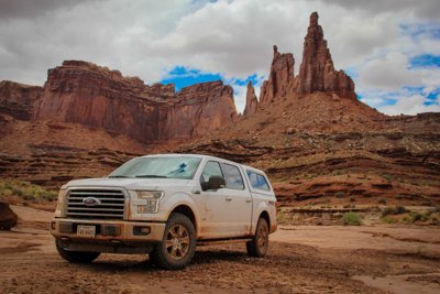

I installed the 2.5 in lift back in December. I planned to add a winch bumper so I went with the extra 1/2 inch to allow for the weight of the new bumper. I have now decided to hold off on the bumper so the extra height is not necessary. That being said, a 2" lift would have been better since the top A-arm now touches the shock when fully extended and the truck is a little higher in front than the rear. It has given me the clearance I wanted and I like the look better.

Nice trip overview thanks for sharing. Also your truck looks better with the front lift for sure!
I'm working on getting a set of wheels for mine in the next couple weeks. Just debating 17s or 18s as I have newish 33 inch tires already on my stock 18s... but could do 17s and have a more aggressive looking setup and sell my stock wheels/tire combo to recoup some cash. Tough decision.

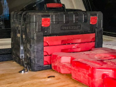

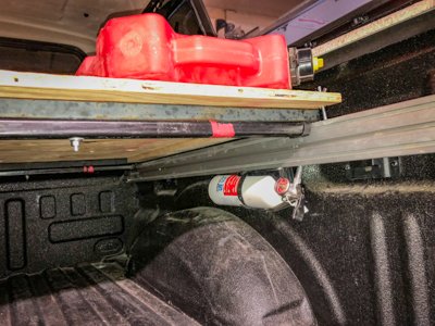

I am leaving to do the first half of the NMBDR in Thursday morning with my 12 yr son. In prepping I mounted the ax and shovel under the shelf...
I also remounted the Hi-Lift and got an attachment that jacks from the wheel. I tested the wheel attachment and it works great. No damage to the truck and lifts it without a problem. I would not crawl under the truck with just the Hi-Loft holding it but it will give me room to get another support under if I need.
I used Quick Fist Mounting hardware.
