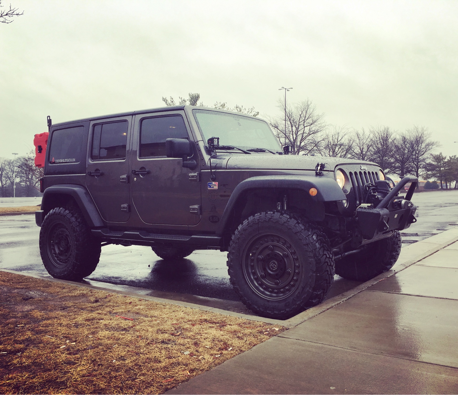

Have you connected an S-POD or other accessory controller to the Genesis dual battery system? Can you show how you powered the winch from the unit?
Thanks in advance!

Hey Dan,
I have some additional photo's on my Instagram and I think they show where the winch is connected. @GhettoGunfighter213 I'm not sure what the S-Pod is?

Here's how I did it dan. Connected the power cable to the main post. Mines not through a switch. The winch is powered all the time. Only my fridge, lights and compressor is through the spod. Hope this helps. 20151012_223353.jpg
