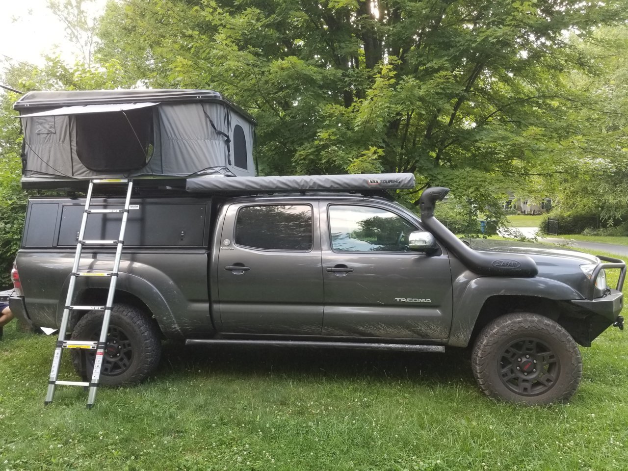

I added a Prinsu Designs Cabrac and finalized plans to changeover to the Alu Cab Explorer Canopy and hard shell RTT. The ARB 2000 Awning was my latest addition in this pic. Pisgah National Forest was pretty cool and Asheville an interesting place.

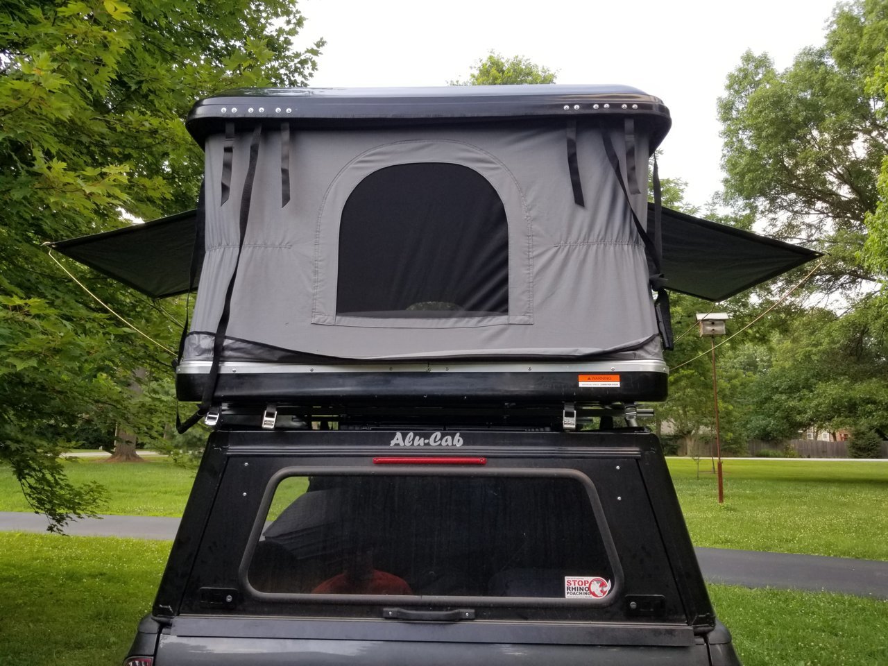

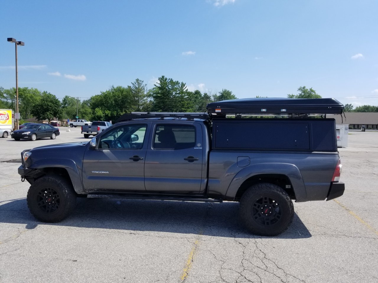

Newest additions. Alu Cab Explorer Canopy and COE Vehicle Solutions Large RTT
The RTT is sitting a bit back and offset due to the awning brackets. The awning will be changing position and mounting hardware completely which will move the tent a bit forward and make it equidistant from the sides. There's really not a lot of overhang and this RTT is larger than most other hard shell models offered. It opens and closes VERY easily and I was able to fit my Exped Megamat Duo 10 inside as my mattress. The narrower RTT's won't fit that and it's FAR warmer and more comfortable than anything I've seen inside of a RTT.
