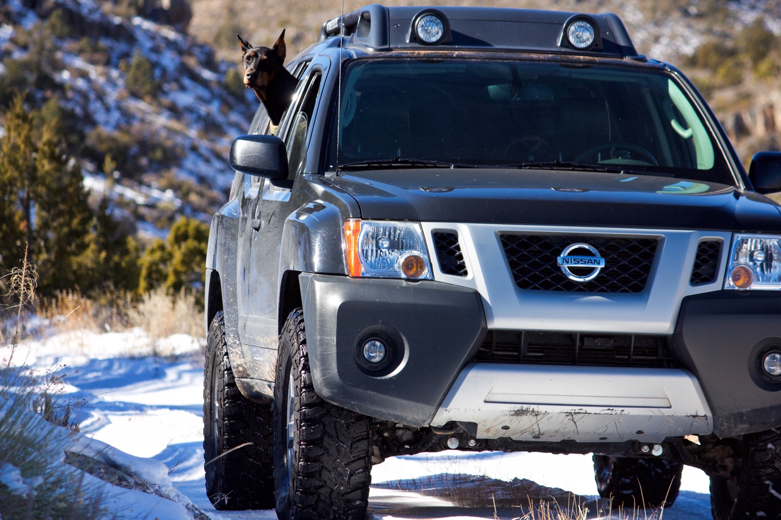

So I picked up the Xterra bone stock on January of 2016 w/42k at a price that was too good to pass up.
Almost immediately after I removed side steps and mud flaps and did melt mod
I spent some time with the Xterra in this form for a while to figure out where the weak links were and to understand it's capabilities.
With that said... I purchased some 285's about 3 months into owning it
Next came the radflo extended coilovers, spc arms, rear Bilsteins with a dual aal. With my stock leaf springs having plenty of life left I opted out of going full leaf replacement.
After tires and a 3" lift I opted for self recovery adding a PRG winch mount and smittybilt winch and full size spare.
fit in stock location!!
Also with recovery I have
- 20' tree saver
- 30' static strap
- 30x1" kinteic rope
- d ring shackles, and snatch blocks and chains
- maxtrac recovery boards x2
Next on the list is sliders and Gobi ladder and Cb radio set up.
I'm sure there will be much more to come....

I really like your X. I just bought a 2015 Pro-4X after my 2006 bit the dust. I read you did the melt mod ... did you have to do the melt mod for the 285s to fit?
Yeah I had to a little bit but nothing extreme like I've heard from others online

Liking this setup! :) Planning nearly the same suspension kit myself. As PM'ed, would love to see closeups of that winch mount setup. Which model Smittybilt is it?

Thanks, much appreciated! My finger is hovering over the "Order" button on PRG's website waiting for these pics as you're the only user of the PRG winch mount I've found! :D
What's your plan for the stiffness of the Alcan pack? Softer, closer to stock? Same as your current 2AAL? Stiffer?

I recently purchased the PRG mount. I went with the PRG because of cost and weight. I have been spending the weekend installing things and took a few pics. Note that the PRG mount comes bare metal, so you have to have it powder coated or painted. I didn't realize that until I received it. It is clearly noted on the PRG website, however. In terms of weight, there is definitely a net gain, but you are removing the stock steel bumper which is not light. I went with the Smittybilt 10,000 H20 winch with synthetic rope and it fits. I am not quite finished; I still need to figure out how to remount the front skid plate. It would have been nice if the winch mount came with instructions. Anyway, it seems to be a solid quality piece. I will know more when I get a chance to actually use it.
