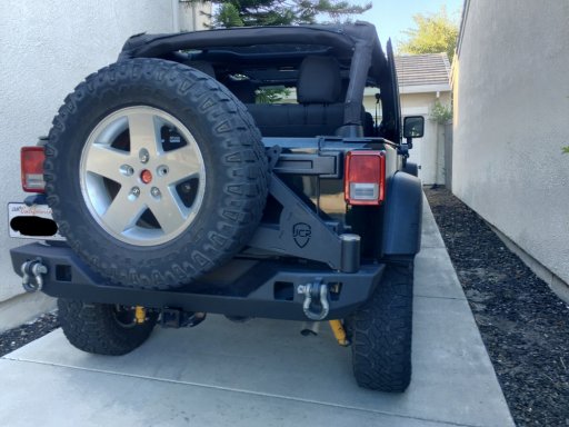

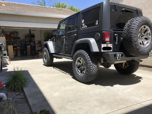

I'm pretty new around here but figure I might as well toss up some info about my rig so far. Just going to start off with pics of where it's at now and talk about the mods instead of trying to dig up pics of progress over the last few years. The 3rd pic with the better view of the tire carrier still has my old wheels/tires on it. Stock alloy with 265/70r17 Duratrac that I ran for 5 years.
So yes, my Jeep is actually green. It's the 2012 black forest green pearlcoat that depending on the angle and how much sun is out either looks a dark metallic green or a lot of times especially if it's dirty and unpolished like it has been the last year or so it usually looks black.
External mods:
Ace sliders (body bolt mounted)
Rubicon sliders (in garage going on soon between Ace and the pinch seam)
Metalcloak Dual Rate ARB edition 2.5" lift kit with lower control arms added in (comes with uppers and trackbar)
Teraflex exhaust spacers
Quadratec 9500is Stealth edition winch
Rockhard 4x4 winch plate for stock bumper
VDP stubby endcaps on front bumper
JCR Offroad Crusader mid-width rear bumper with Shield tire carrier (attaches to swing gate for all-in-one opening)
JCR Offroad replacement transmission crossmember
JCR 3rd brake light relocation
Quadratec hardrock style wheels 17x8.5 with 5.2" backspace
Nitto Ridge Grappler 285/75r17 load C (note the 75 not 70 profile)

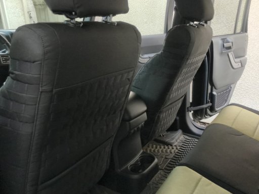

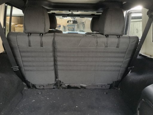

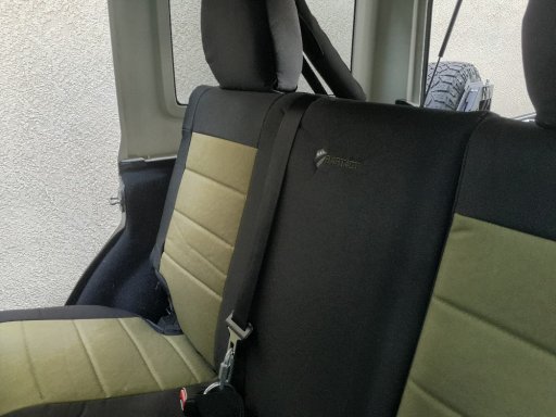

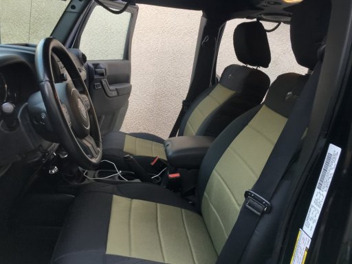

Don't have pics of everything but did want to show the seat covers
Bartact molle system seat covers on all seats. I needed something that could resist Boxer hair. It comes right off these vs being heavily embedded like the OEM fabric.

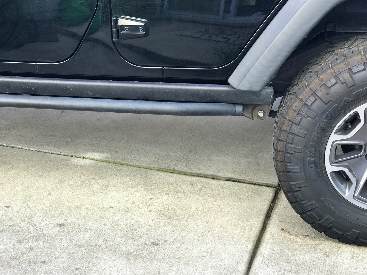

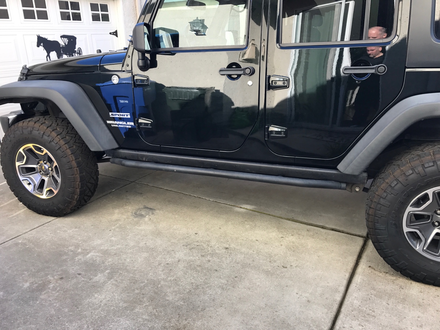

Got my factory Rubicon sliders on finally. Should offer some extra rocker panel protection from branches etc. I've somehow managed to get a dimple in the rocker panel right behind the front driver tire even with my Ace rock sliders/steps and can only assume it was a branch.
The Ace sliders also like to flex into the pinch seam if hit hard enough. Apparently they were actually designed to work with the factory ones when I inquired about it. $50 off Craigslist not bad. Just had to get a few missing bolts and washers.

Looks good ,that color is awesome. I like that tire carrier.
Thanks! Yeah I wanted a carrier that integrated to open with the rear gate but would put the weight on the bumper/frame not just reinforce the factory hinges.
