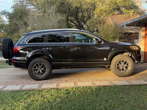

This is where I'm at on my 2012 Audi 3.0 Diesel.
3"lift with a 1" subframe drop. New BBS wheels, and 33's. (275/70-18)
winchmount front bumper with a bullbar going in as well.
Wilco Offroad swingout rear tirecarrier for the spare.
Probably be building a DIY, 8020 rack, as well.
Rear lift and subframe drop complete, front subframe drop done, waiting on some suspension level sensor parts to arrive, and 28mm spacers and 90mm studs to finish up the lift.
So far, it looks like we'll have around 14" clearance on the lowest point, which I think is the gas tank skid plate. We might add rock rails, and some underbody protection. Not sure yet. This will likely just be a Glamper. No locking diffs, so it isn't a Cayenne.
After we finish this, we'll be starting one on our 2023 Ford Lightning, Likely with a 3" lift and with some sort of Trailer with extra batteries, and a foldout flexible solar panel system with somewhere around 3kw of production. We have a single axle trailer, that we'll likely lift, and that currently has a 2000lb load rating, I think.

Howdy,

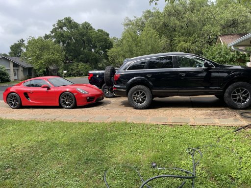

Keepin' moving but slow. Had to do a bunch of work to my autocross car(see pic, lower and hopefully faster with Ohlins), but after this weekend, could possibly finish the basic build.

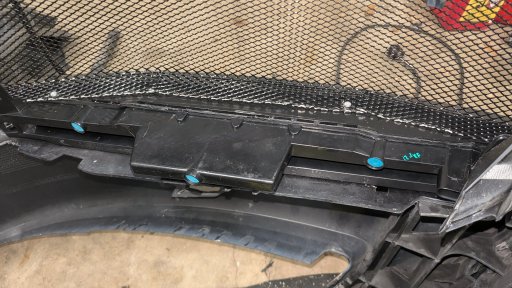

Some trimming around the intercoolers, then some aluminum mesh on the lower turn signal vents, and some modification to the turnsignals themselves since this is a 2008 S Line bumper, as my original parts won't fit quite right, but this year bumper had the parking sensors on the lower part of the bumper, clearing the Bull/Light bar.

Mesh screen actually came out OK. The parts that aren't ok, should be covered mostly by the Eurowise bull bar. Which still needs to be ordered. It's a good 10 footer.
Probably be some lead time on that, as they are moving warehouses, and as my options are raised version that clears the parking sensors, and light bar tabs on top to clear the fairlead.
I'm guessing a couple weeks to a month on the bullbar. Then lighting decisions and wiring.
The correct piece for the turnsignal gap is hard to find anywhere other than Lithuania.
I may buy them eventually, but $160 for a couple pieces of plastic that will take weeks to get here, made me DIY for $12.00 Hopefully it won't block too much airflow.
Turn signals aren't the correct ones for this year bumper, so they fit less than perfect as well.

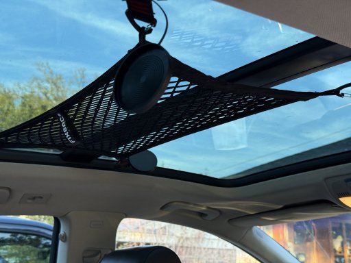

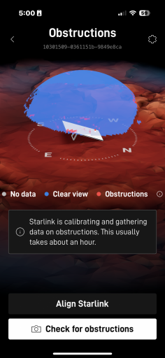

It's finishing up pretty well. Taking a 1500 mile trip to Angel Fire to test it out.
Starlink Hammock is working pretty good, getting 65mb/s+ while moving.
