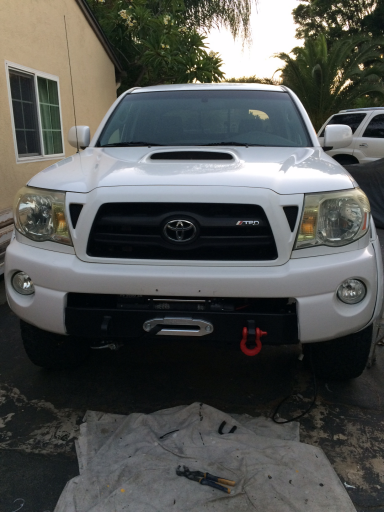

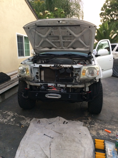

Just got back this past week from the 1st Annual Feed the Vets Event and Toyota of Huntington Beach, CA. Wow! Great rigs and ideas out of the show. Brian and Matt got it going on at Goose gear.
So, I got my behind in gear after the show and got to work. Just installed a US Offroad Hidden Winch Bumper and a SuperWinch Tiger Shark 9500. Things are coming together. I have some front recovery hooks now and a non-aggressive front end. Digging it!
Comms and ditch lights are next.
