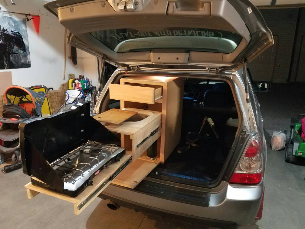

I started with building my own overland kitchen, which is almost completed..
I will try to post the details of the kitchen a bit later.

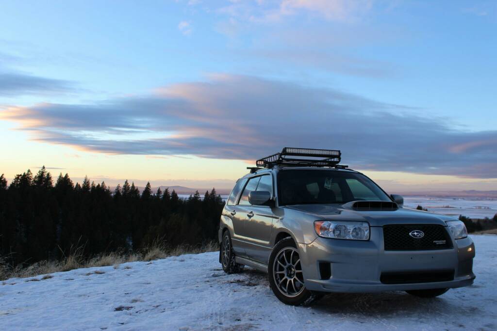

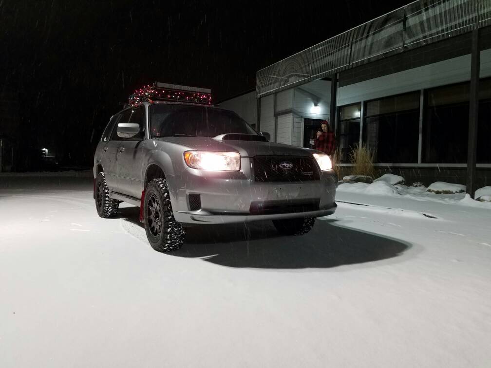

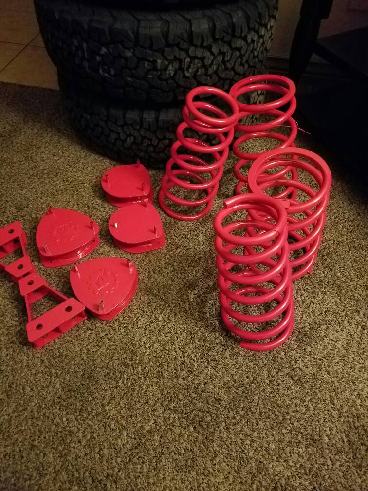

A few weeks ago I got my 2 inch lift kit from Anderson Design and Fabrication. I installed it in my garage, which went smoother than expected haha! I went with standard height king springs, as well as upgraded to Method Race Wheels and BFG all terrain tires.
Here is how it sat before the lift..
And here is after..

Welcome Tyler! Good to see more fellow subies on here! How do you like your light bar up high on your cargo basket? Any glare from your hood?
tyleromyah
Thanks! I like it. It works the best when driving in the trees. I don't experience much hood glare on this one because of the color. I had the same setup on my old obs, and that car was white so i did get a glare on that subi. Let me know if you have an instagram so I can give you a follow!

This is AWESOME! So glad to help inspire your build it means a lot! glad to see people starting to take action and see the real capabilities of these vehicles. Love the kitchen build!!
tyleromyah
Hopefully we can wheel someday! Forester Nation! But seriously, these vehicles aren't given the time of day. They are so capable. Hopefully I can finish up the kitchen before spring time!

Absolutely loving the kitchen build dude great job!! Oh and the foz is looking awesome as well! Go ADF!

Looking great @tyleromyah! Reminds me that I really need to get started on my drawer setup.
