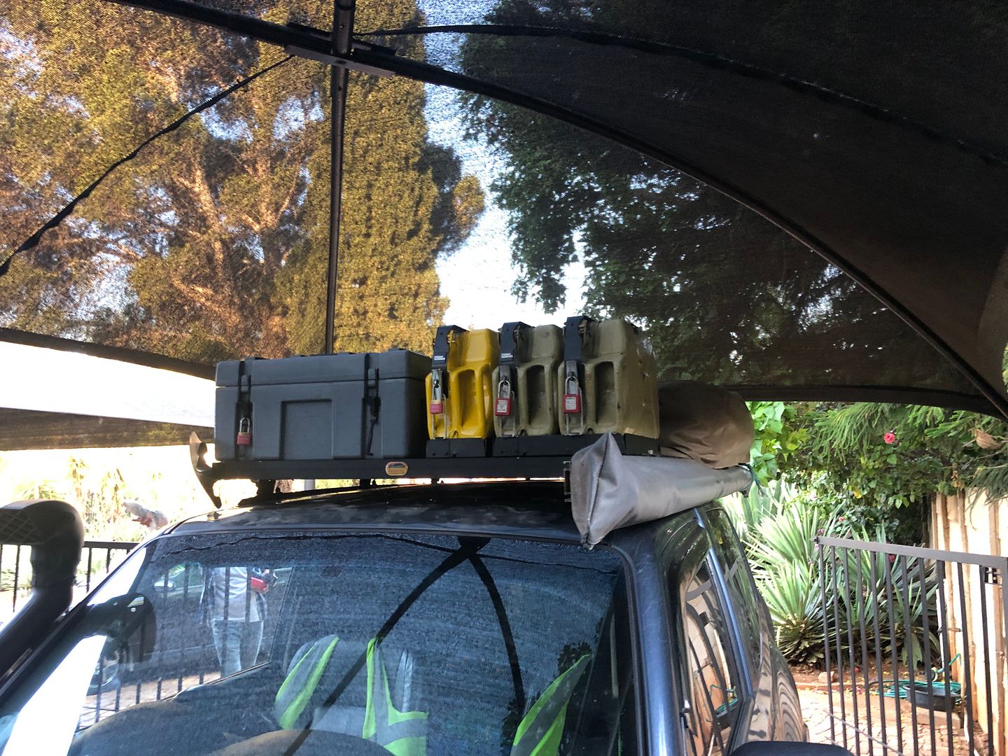

Morning, I figured I would post up a build thread for people interested in ideas for there own rig. The vehicle is currently in use. I have a couple more mods planned to make use of the little room I have available. and as always trying to shave weight.
Vehicle run down:
2007 Mitsubishi pajero
3.2L DID diesel
5 speed auto
factory rear air locker - not hooked up yet
full load/leather and such

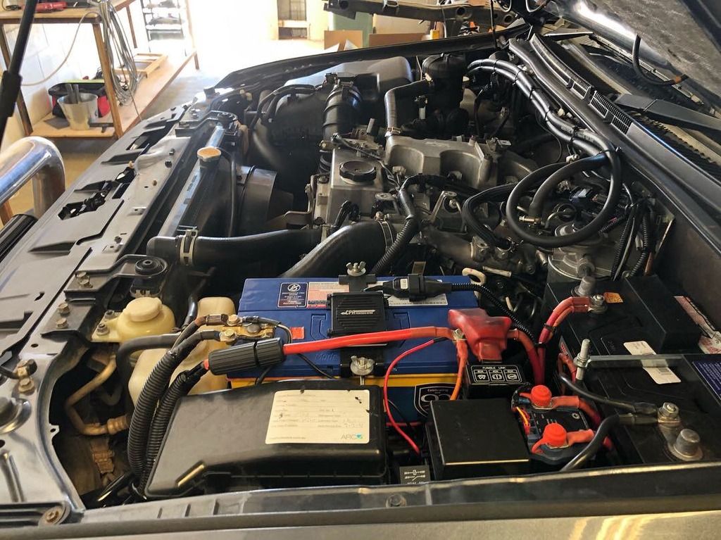

Engine/trans mods:
egr delete
provent catch can
extra diesel filter
dpf delete
3" exhuast
plug and play chip
dual battery system
Fuel rail pressure relief block
lock up kit

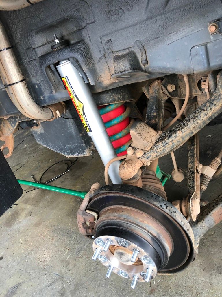

Suspension:
40mm dobinson springs
41mm foam cell tough dog shocks
lovells strut in the front
poly air air bags
new bushes/sterring components/ bearings
Outside:
ARB sahara bar

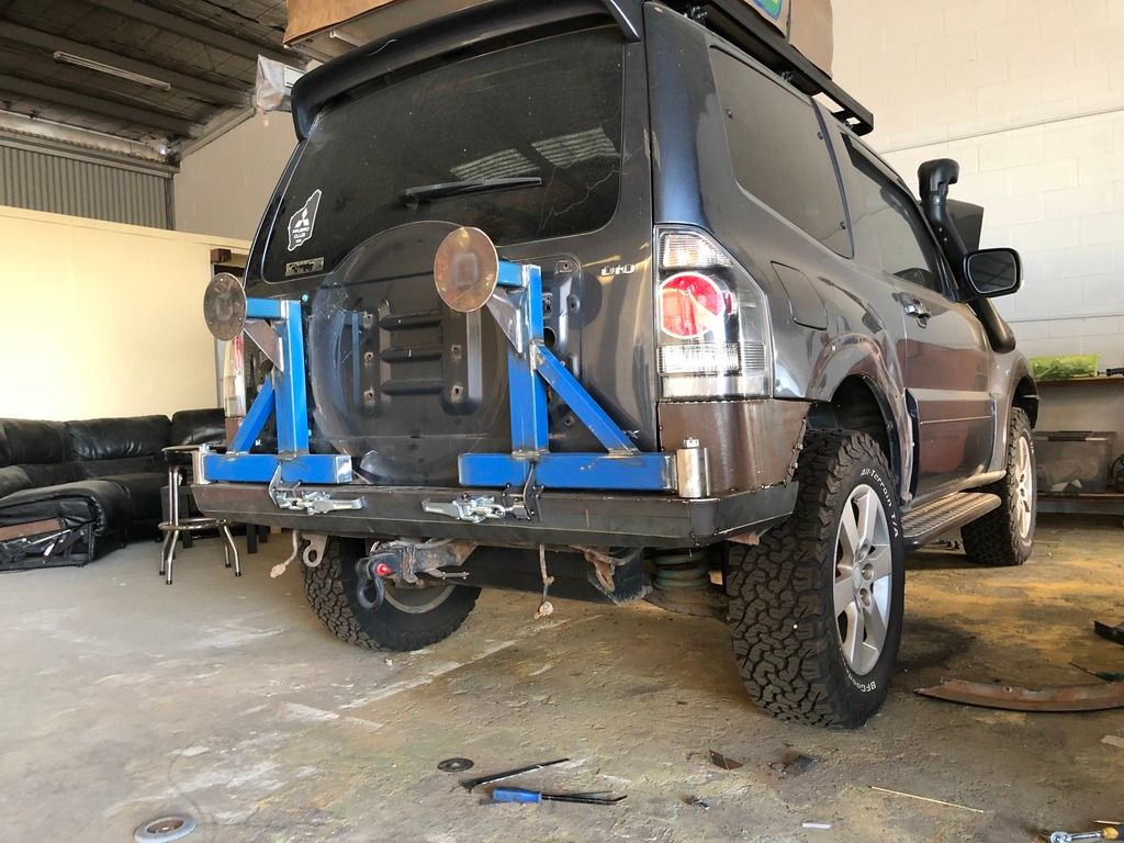

Home built rear dual carrier
bush skinz bash plates
safari snorkel
roof rack
2.5M awning
howling moon RTT
20" led light bar
12000lb winch
a stuffed giraffe
58L AUX fuel tank

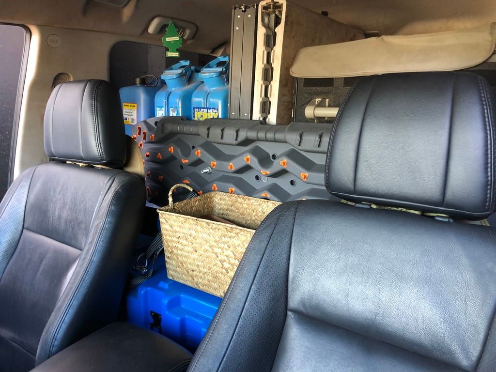

Inside:

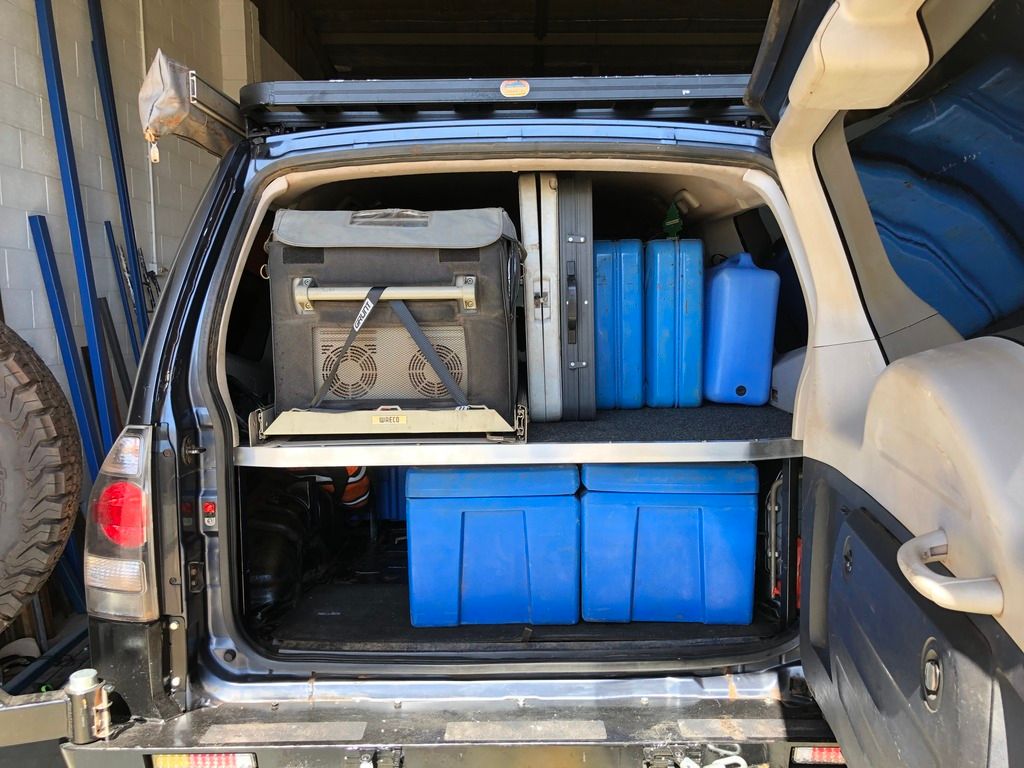

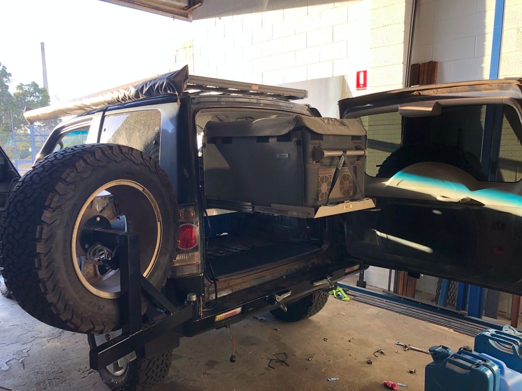

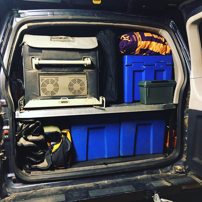

Custom rear storage system
usb plugs everywhere
ARB single pump compressor
Drone charger hard wired in
red arc trailer controller pro
aftermarket stereo
Anyways onto photos:
Outside:
Inside:
Fully packed:
Engine and related:
More will be added a little upgrades get done ot make life more liveable out of the wagon, right now we are at a 15 minute setup time, not rushing till beer in hand, or a gin and tonic. with proper packing we can do 10 days unsupported water being our main issue. Fuel only becomes a concern if its constant soft sand and dunes.
