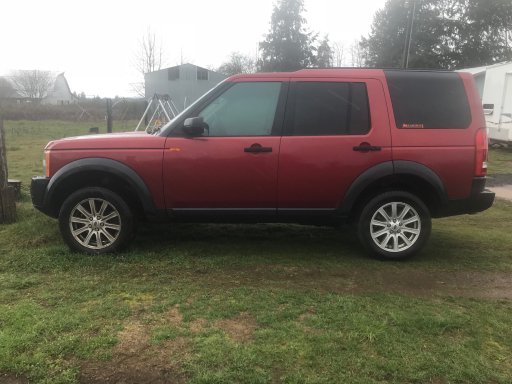

So there's basically a stock Rimini Red LR3. In the above picture, it's sporting a 2" lift via the GAP IID Tool. For those of you not familiar, the IID Tool is an ODB2 interface specific to Land Rovers. This tool can log into the various computers of the LR3 and you can manipulate a plethora of settings, including the air suspension. I had raised the suspension to get an idea of sway because the day after this picture was taken, I added 275/65r18 BFG KO2's.
To me, it looks so much better than the old factory size tires, (255/55r18). The truck came with 19" wheels when new, but thankfully the previous owner swapped them out for the 18". As you may know, finding AT or MT tires for a 19" wheel can be a chore. All fine and good, except the original owner neglected to replace the full size spare while he/she was at it. So I have been stuck with a 19" wheel for a spare for quite some time. The good news, as many LR3/4 owners would have guessed by now, having a full size spare is indicative of having the HD version. I looked visually and with my IID Tool and sure enough, I have the HD version. Happy dance. The HD version basically includes an electronic rear locker.

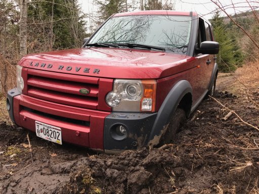

PS, KO2's obviously are not good mud tires. That hole snuck up on me. It definitely looked more solid than it was.
