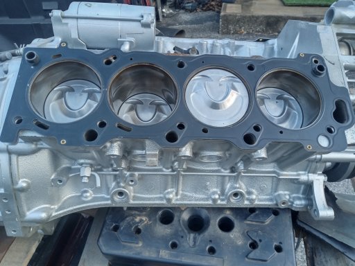

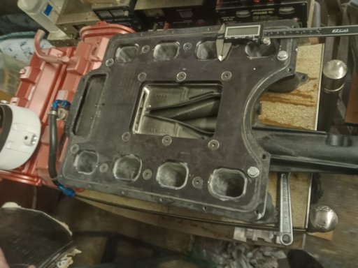

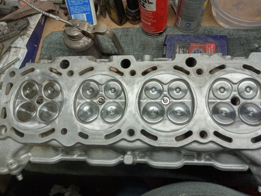

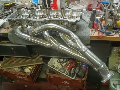

Well I got my long block together now with the LF4 pistons in. Ther were no clearance issues but it will be an interference engine. Even after polishing the combustion chamber to a mirror finish and un shrouding the valves it is making 11:1 compression with a cold engine compression test pressure of 210 to 220 psi. Hope I can manage 6 psi boost with the TRD supercharger without detonation issues . Right now I am adding a water to air intercooler to the TRD supercharger which is a lot of machine work. The heads ported nicely but 32 valves took me a while LOL! I am trying to see how big of injectors I need to go with for the power this will produce. My Audi RS6 with a Biturbo 4.2 liter V8 uses 78 lb injectors. What I am really trying to make is a high torque low rpm engine that will be more fuel efficient so I want the high compression ratio and low friction these coated pistons provided.IMG_20230403_185402433.jpgIMG_20230402_190750370.jpgIMG_20230402_190944780.jpgIMG_20230402_191128327.jpg
