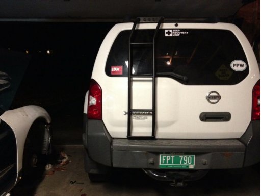

First change was putting on 285/70/17's.
Next was the addition of an Xoskel light cage and KC Daylighters, and a Gobi ladder. (Disregard the Jeep decal, was a joke between myself and a buddy of mine who had a Jeep at the time lol)
