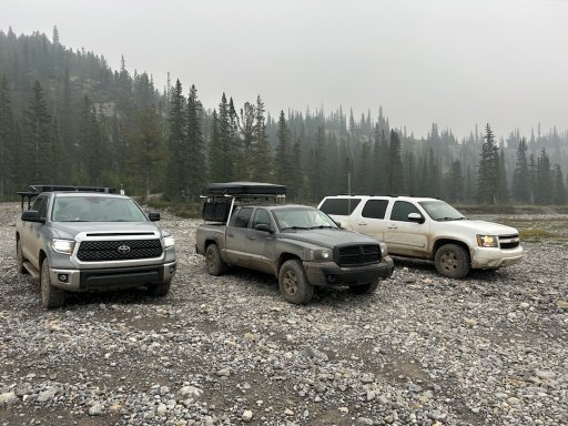

Updated photo showing the repaired body damange. Pic taken on our expedition to the Rockies Sept 2023:
Far from body shop perfect, but it's way less noticeable and won't rust away now.
