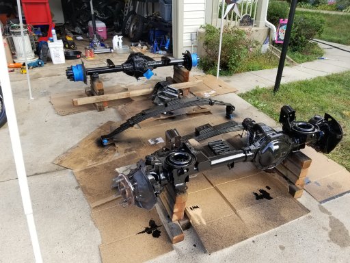

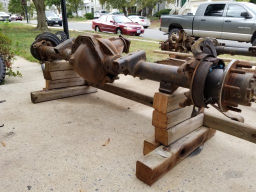

Power wagon axles and leafs for one hell of deal in NC, 6 hour drive down and a chat with a nice lady that parts out dodges and i got my new set up. PW axles come with 4.56 gears and electric lockers, so super cheap off road goodness for me, like i mentioned my truck uses all 2500 suspension and drive train components. so this is a bolt in swap
Shes driving through the woods to pull the axles out of the bushes they've been sitting in for 3 years or so.
rear AAM 10.5
front AAM 9.25
they've been sitting in the garage for over a year at this point and i've finally got all i need to do the swap so i wire wheeled them down and got ready to por 15 them

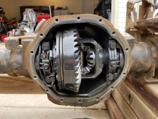

front looks good, time to blast them with some parts cleaner and clean all the magnets off
rear locker
so much over spray, i am not a professional painter by any means, but its tough stuff and looks legit.

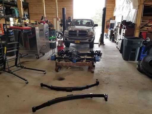

all loaded up and off to my buddys shop to put them in
forgot to mention i got the PW leafs as well, these will lift the rear 2" over stock, so its the same height as the 2500 version but the load limit is lower since the are PW leafs.

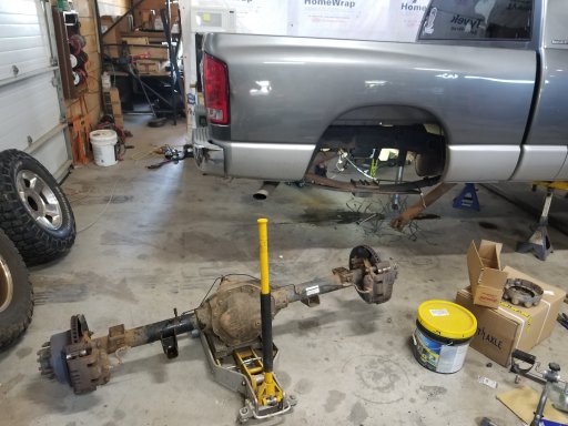

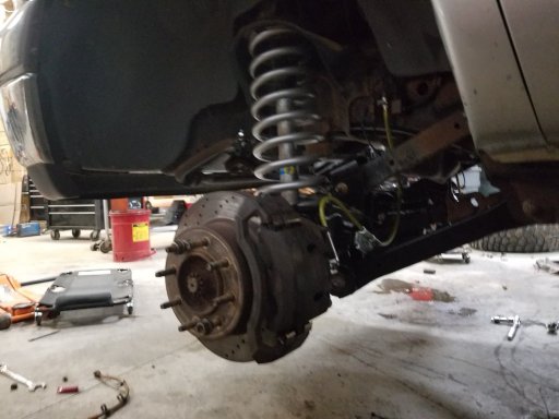

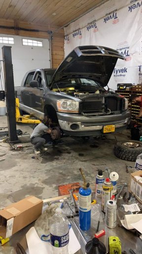

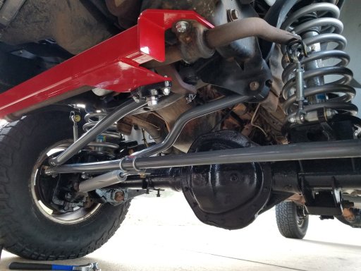

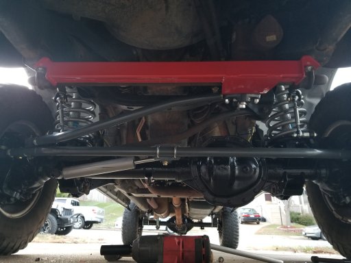

hey that was easy, pulled and prepping the new axle by swapping on the brakes and making sure everything else is good. Note how small the 1500 springs are.
new axle in with my best friend and shop supplier Cam, if it wasn't for him i would've been doing this in the driveway and would've been screwed! always have good friends on your side
putting my brother in law to work, 18years old and trying to get in the diesel mechanic field, after today he's not as excited about doing it full time. I'm trying to convince him to become an electrician instead, I was a heavy diesel mechanic in the air force for 7 years and even though im only 28, I'm in pain a lot of the time and constantly having to watch my posture and lifting techniques.
klm steel braided brake lines

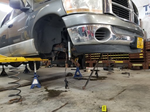

see how much bigger the springs are? they're 2" lift springs for the diesel version, no one makes lift springs for the gas so it might sit a little nose high. i might get a synergey 1" rear raising shackle later on. but for now it'll be fine. DO NOT USE THESE COILS!!!! Ok so I thought I would be able to use these on they would work alright, turns out rough country coils have the flex of an I beam and since these are for the cummins model it made it even worse. i thought this would work because synergy mfg said on their site that if you have a gasoline mega cab, you need to use their diesel lift springs. So i thought it would be the same here, it was not, they gave me 3.5" of lift and wrecked my shocks. I'm convinced these also cause some mechanical problems since the control arms couldn't cycle properly and the ride was too stiff. stock control arms are good to 3" of lift, past that and a long arm kit, or longer control arms are needed. So instead of cycling, they just kept jamming into the frame like a stabbing motion, couple that with the little to no flex and it was a bad ride. Go with thuren fab instead, their xs coils lifted it 2.5" over stock and were a huge improvement. and i used their overland shocks as well and they are great for what they are and the price.

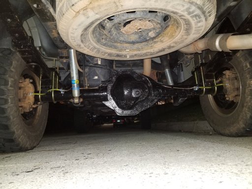

rear pulled, some may be asking how i'm using the same shocks with the 2"lift? i bought billstein shocks that are able to work with 0-2.5" lift kits.
running out of time sunday night, couldn't take picks of the install, but thats the new one in there.

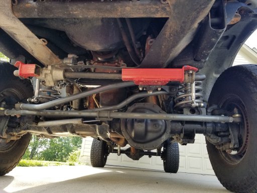

the alignment shops attempt at setting up the steering, i gave them a great set of instruction right off the website for the synergey mfg heavy duty steering. but i guess they didn't want to read it and i was promptly told that "its aftermarke, thats not our fault"
the proper way the steering should be, you can see where my steering stabilizer was binding on the bar. heim joints for my sway bar are a little cock eyed. i actually have a power wagon disconnecting sway bar im going to be installing. just trying to find a way to remove the computer with the electronic disengagement device. i'm going to try a rubricons smart bar delete and see if i can get it to work with the pw bar, or use it as a template to have a machinist i know make me a custom one.
rear end, we couldn't get the old brake line from frame to axle off yet and i had to drive this to work so we are going back at it at a later date. we'll also weld on some bolts so we can bolt the lines from caliper to axles up higher. Rancho sent me the wrong U bolts so thats why theres a stack of washers under each nut. new ones just got here today so should be a quick swap. (Check out the original 06 spare tire, might have to swap that out soon lol)

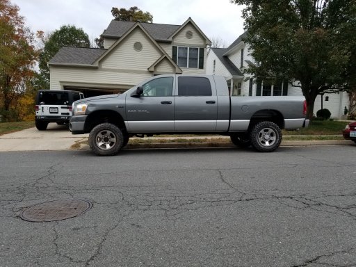

So i got my tires mounted, 35x12.50r17, on my stock wheels. They rub the control arms just a hair at full lock. I planned on getting different wheels in the future anyways, but if you're fine with that then you shouldn't have to worry if your doing a build like this. Tires are falken wildpeak at3w and i gotta say they're like driving on velvet. It might be that I'm coming off a set of bfg mud terrains but this tire feels awesome. I'm not sure how my mpg will be affected yet so I'll post up about it after a month or so.
Mpg stock: 10.7
Axle swap: 9.8
Axle swap/superchips 87 oct performance tune: 10.8
My buddies machines where way undersized but we made it work. We traded off who was mounting tires but i let him do all the balancing, he was having to get them spun up on the balancer then turn it on.
Tires fit great, definitely thinking I'll go with a thuren lift shackle in the rear to help with the rake. That way I'm not squatting like crazy when I'm loaded with dirt bikes and gear.

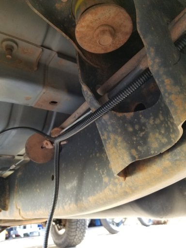

Did some simple stuff, an ARB diff breather kit, i spent some good money on the axles so i wanted to do what i could to protect them skid plates for them are coming soon. And i also did a synergey adjustable drag link because the truck was really dog legged after just a 2.5" lift.
Just made a coupler from the oem rubber breather line, black rtv and shrink wrap, also added hose clamps as a just incase but it is water tight.
Also used a ton of chafe guard, its super cheap and easy insurance

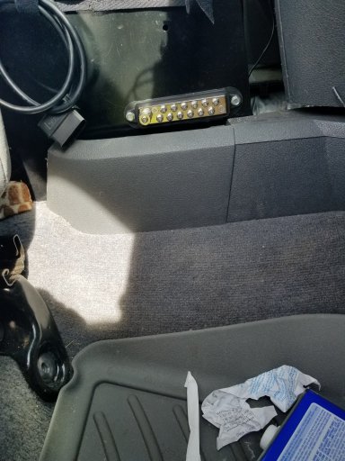

also started building a relay block to power lockers and lights and if it works out well enough I'll do another for on board air an extra stuff.

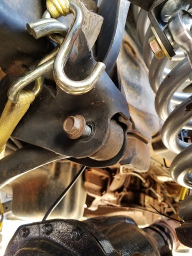

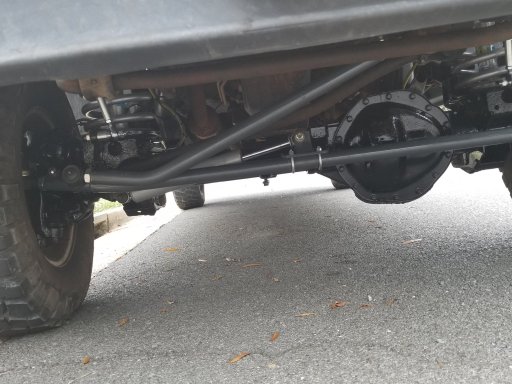

my truck was running super dog legged, it was off by almost 2", so to get it inline i went to an adjustable drag link and got it within 1/8" i know that trucks usually run a little out of line, but my passenger tire is rubbing on the trailing arm and my alignment sheet shows a lot of red due to just being to far out. new trucks aren't as dog legged as old trucks and i know i didn't get it perfect so i'm taking it to a different alignment shop than before and letting them try it. if its not done right i'm not accepting it, i'm tired of giving shops thorough instructions from the parts manufacturer and them giving me crap work in return. Now if you ever have to remove a stubborn drag link, a ratchet strap made my life super easy.
Bolt stuck and wont come out since the draglink is too tight? bring the link in with a ratchet strap to get it together. couple clicks and the bolt came out with fingers, no prying or trying to walk it out with spinning a wrench.

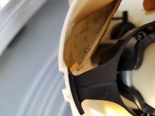

Ok so its been a while since i've posted but a lot of stuff went wrong on the truck over christmas. First thing that showed up, and i should've known and taken care of it but I had a full plate and was trying to hold out, ball joints... The PW axles had 170k miles on them, and i had ball joints for them waiting to go in, but i didn't do it, and i drove all the way from Virginia, to Georgia, then to Texas, then back up to Virginia. It wasn't anything overland worthy but i wanted to see my folks for Christmas and i wanted to take a cherry picker and engine stand to my dad and visit my brother in GA. So ball joints were shaking like crazy over hard bumps but were manageable, i took a needle grease fitting and stabbed through the boot of the oem joint and pumped it with more than enough grease and it actually helped a lot with noise and feel. Those were replaced shortly after i got back, sadly it was a week night and we were in a hurry and i forgot to get pictures. second and third one happened pretty close to each other, the TIPM which is my trucks fuse and relay block failed, and we think it sent weird voltage to the fuel pump and took it out to. Both of these parts were 14 years old so its not surprising, when tipm failed it started messing with head lights, radio, and fuel pump, and made it seem like there were hundreds of shorts in the truck and my battery was going bad. So in Texas i replaced the tipm and fuel pump on christmas eve and had it up and driving, but the fuel gauge would not work now. it took three different pumps to finally get one that would work and get the gauge to read correctly. first 2 would just throw a check engine light and read empty, all dodge forums say delphie fuel pumps suck and its a common issue, just put in a new one and it'll work, after trouble shooting the gauge and wiring we replaced pump and it works correctly now.
old tipm
old pump, pic doesn't do it justice about how full of crap that 14 year old filter was

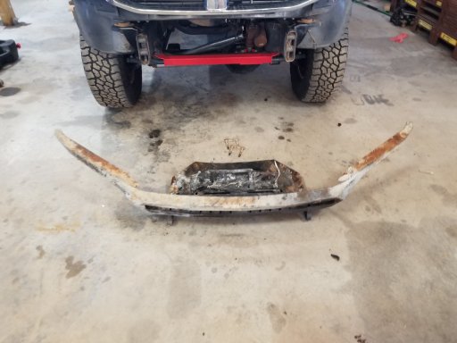

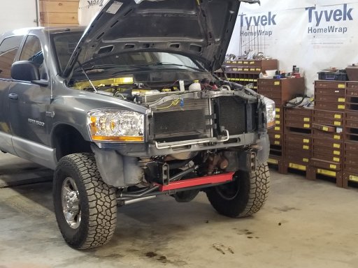

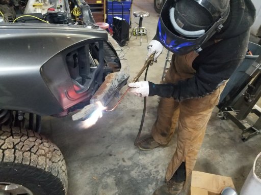

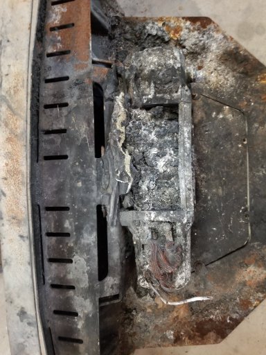

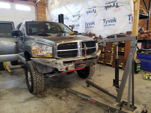

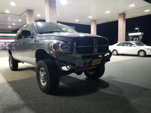

Ok long time, no update, but i have been working on it. So the bumper.
I removed the stock bumper and worked on fitting an addictive desert designs bumper from a 2019 for raptor onto my truck.
The bumper had been in a fire, but wasn't really damaged
The winch and light bar that were in it however were toasted.
Its a little wide but looks pretty good
Using a torch with a rose bud tip to fold the "ears" in
View attachment 146002View attachment 146003
We welded all the relief cuts made back together, and even added a couple gussets. Even though it is a winch bumper, i think I'm gonna put in a reciever hitch and have the winch as a hitch mount. So i can move it from front to back and store it when its not in use.

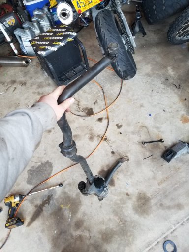

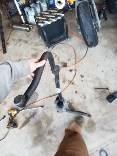

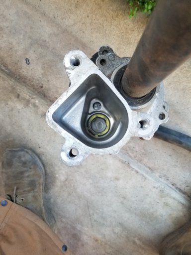

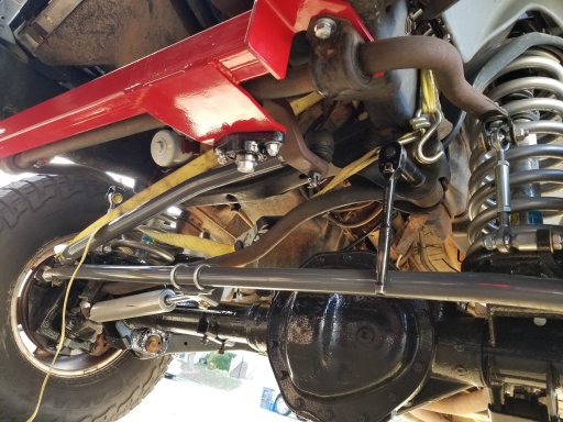

Next thing i did was play with the power wagon sway bar i have. I figured since dodge and jeep are owned by the same parent company, the factory smart bars were probably pretty close to each other for the PW and rubricon jk. View attachment 146009
They look a lot alike, what happens is you spin in the knob clockwise, and the spring on the other side pushes a pin that frees the bar.
These things get loaded up with mud and crap so its nice to see its clean in hear. I'll tear it down completely and clean and pack it with grease before i install it
Now it fits perfectly, but if you don't have these washers in it to space it out it keeps the bar unlocked. What I'm going to do is have another .5" of threads added to the part that threads in and out. So i can spin it another .5 out and let the bar "lock" for on road driving.
Locked
Unlocked.
Now I've been trying to find this online for awhile but couldn't find any info on it. So I'm gonna share some of the search terms so if someone else needs this info they can find this write up.
Powerwagon sway bar swap
Manual disconnect power wagon smart bar
Jeep sway bar disconnect on power wagon sway bar
Can a jeep swaybar disconnect work on a power wagon
This manual disconnect is made by EVO and is for the 2007 jeep jk rubricon, if you email them they'll tell you they don't make one for the power wagons. Its just sheer luck Chrysler decided to use the same smartbar on both vehicles.

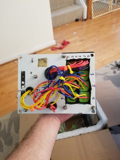

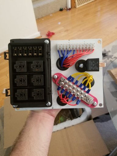

So while i wait for covid to run its course and machine shops to open up and add the threads to the swaybar disconnect, i decided to work on my wiring for my lockers and fans. I decided to start from scratch and put it all on one plate and make it where i just land a wire from the switches in the cab, when flipped it allows the coil side of the relay to have a ground and close for 12vdc to go to the controlled device. This means one wire landed on the board for coil ground, then one out for device. Device is grounded to chassis, and other side of switch in cab is connected to ground on chassis to.
Didn't have my angle grinder so used a sawzall and some uni bits to make the holes and big square openings. Also used rivnuts to secure parts to the board.
Buss bar will be power to power side of relay coil, and power side of relay for devices. Big relay on the side is an 80amp relay that comes on when ignition is on to allow 12vdc to biss bar.
Blue is from switch, red is out to device.
Super simple pimple.
Where to put? Meh just put it on the side of the air box with some rubber idolaters so it doesn't shake too bad.
Moved the electric fan relay into the new relay box.
This will be the ground for the switches inside.
So i dont have a pic, but an 8awg wire goes from that bolt to the buss bar.
So lockers and fan are wired up and working correctly through the relay block. I still gotta remove all the old fan wiring.

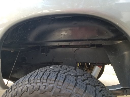

Ok so i haven't posted in awhile and i'm sorry, i didn't want to ghost a build thread and thats what i ended up doing. I bought a house, luckily wasn't affected too bad by covid since i have a state job i could do remote. so let me fill yall in on everything else i did and why i'm going to end up putting it up for sell.
So i think at this point i ended up paint ing the frame and inner wheel wells on the bed, i love this stuff. its been on for awhile in salt and sand and it still looks new, you don't have to be good at painting or even paint prep. spray it on all blotchy and uneven, drys smooth and looks perfect. and the prep is to spray it with a degreaser and pressure wash it clean and let it dry.

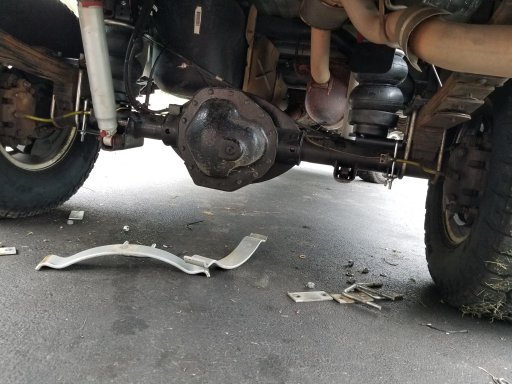

next i added some cheap load springs, again my suspension ideas were bad and since i used power wagon springs on the back, they could not keep up and started sagging. so i added a cheap autzone addaleaf kit ant it worked out great.

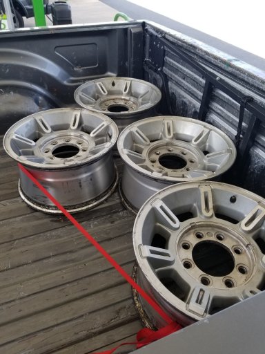

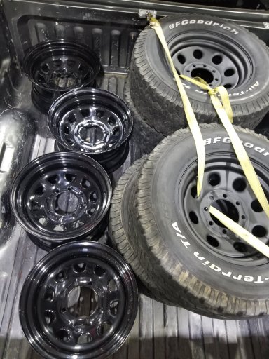

I got some H2 wheels for the truck, traded my stock 3rd gen wheels and $45 to get them, they were already bord out and fit over my trucks hubs and didn't need hub centric rings.
dang h2 wheels are perfect

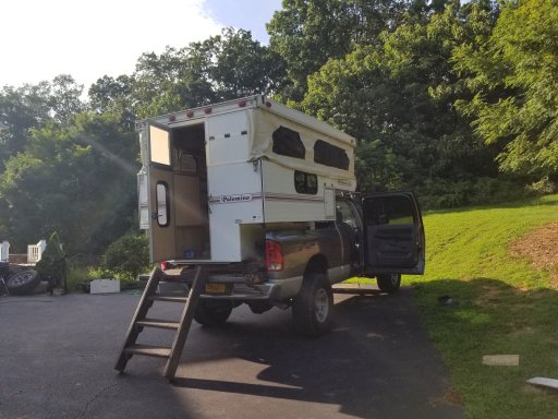

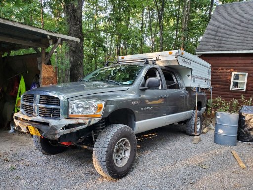

next we found a cheap palomino pop up camper in west virginia for $1200, its in great shape and we love the look, its actually for a long bed ranger or toyota t100
next, it was time to get rid of the helper springs and move on to riderite 5000lb air bags, with daystar cradles of course. don't want to rip the bags apart when im out some light trails.
View attachment 186611View attachment 186612
the bags working with the rancho adjustable shocks worked like a dream with the camper in the bed, but i think my next set up will be some good shocks with a rear sway bar.

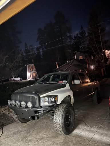

and this is the last pic i have to post of it. this pic shows the truck with thurens front coils, the rough country coils lifted the truck 3.5" over stock and were way too stiff and wrecked some stuff. these lifted the truck 2.5" over stock and look and feel so much better, still kinda harsh, but coupled with thurens overland shocks these coils felt great. you can also sorta see my free spin hubs up front, i swapped out the unit bearing for a new lock out hub from the ram man inc. they're f250 front hubs that are re drilled the 8x6.5, and they give you a new d60 stub shaft to replace the oem stub shaft. so i put those on and brand new u joints in the front axle shafts.
So I'm gonna put it up for sell. We love the camper so we will keep it, but we're gonna move to a diesel, i just picked up a 7.3 powerstroke and we're looking forward to using that truck instead. the mega cab is nice, and the back seating area is awesome for storage, but the 5.7 gas cant keep up with us. We plan on doing long camper trips and i plan to take the camper and a dirtbike out into the woods to, in this configuration we were pulling in 9.5mpg and the rpm was over 3k rpm for our whole trip. We don't want that kinda fuel bill and since our wants are so heavy, we are just moving to an engine that can work better with the weight. If you are considering getting a 5.7 mega cab i will say they're great and easy to work on, you have to buy mopar replacement parts but other than that they're pretty cheap, with a dirt bike and all my gear i was getting 12.5mpg with 35/12.50r17s after all my mods. the mods i couldn't post because my phone that had all the pics took a crap are mbrp 3" catback exhaust, 5" solid aluminum drive shaft, and free spin front hubs.
