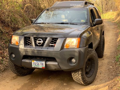

Make: Nissan
Year: 2005
Model: Xterra
Trim: SE 4x4 5AT
Color: Night Armor (K26)
Wheels/Tires:
-Pro Comp 89 17x8 -12 offset
-BF Goodrich TA KO2 285/70/17
-Melt Mod/minor trimming

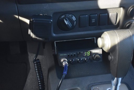

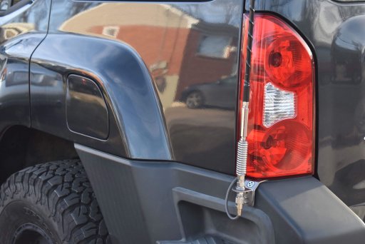

-Uniden Pro 520 XL
-4' Firestik FS CB Antenna
-18' Premium RG8X CB Coax Cable
-Heavy Duty CB Antenna Spring
-Firestik CB Antenna Quick Disconnect

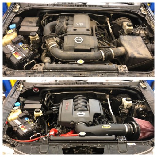

VK56 SWAP PARTS
2010 Titan Engine under 120k miles
2010 Titan 4wd Transmission under 120k miles
2007-12 Titan Engine Harness (Used, Converted)
2007-12 Titan Engine Control Module
UpRev Tune
Titan Motor Mount Brackets
Titan Powersteering Pump (Used)
Titan AC Compressor (Used)
Titan AC Compressor to Condenser Line
Pathfinder V8 Low Suction AC Line
Titan Powersteering Pressure Line
Titan Engine to Transmission Bolts
Titan Flexplate (Used)
Titan Clutch Fan - upgraded to electric fan
Serpentine Belt
Titan Fan Blade (Used)
Heather Core Fitting
Titan Lower Radiator Hose
Titan Upper Radiator Hose
Pathfinder V8 Radiator Shroud
Pathfinder V8 AC Fan
Titan Coilpacks
Titan Transmission Dip Stick
Titan Starter
PRG Polyureathane Titan Motor Mounts
PRG Polyureathane Titan Transmission Mount
Titan Engine Cover
Airraid Air Intake
JBA Headers
Cajun Titan Resonated B Pipes 2.5"
Cajun Titan Y Pipe 2.5"
OEM Exhaust Gaskets
JBA Catback Exhaust
Red Silicone Coolant Hose Set
