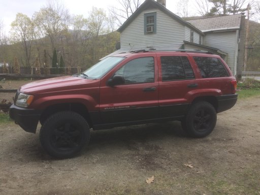

Got a little jump on the work and managed to get the front lift installed between rain showers today.

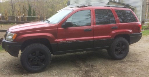

Man, what a day. replaced rear control arms while I was doing the rear lift. That upper was a bear with everything rusted up. Got it done, but now there's no part of me that doesn't hurt... Finished it up in the dark so maybe seeing it done in the light tomorrow will help shake off the sore muscles.
