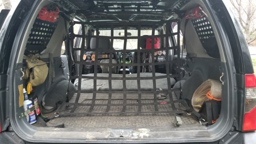

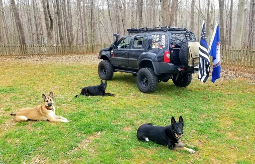

Picked this thing up in December 2014 and started playing around with upgrades that could support the goals of camping. Long story short, I discovered a wide range of off-road type recreation and have been building this thing since. I love this thing.
Top picture 31 December 2014. Bottom picture is 11 April 2019.
93145

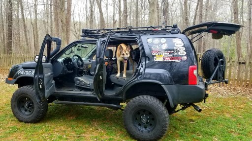

Modifications:
P&P rock sliders
Goodyear Wrangler MTR Kevlar 285/75R16
American Racing Baja 16x8

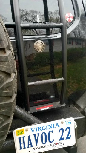

Gobi Stealth rack w/ladder
3" lift (Rancho RS9000s, upgraded torsion bars, add-a-leaf, articulating leaf shackles, UCAs)
3" body lift
Rugged Rocks 2" wheel spacers
Warn manual locking hubs (pending install)
Grassroots 4x4 upgraded steering center link
Upgraded/new LCAs, idler arm brace, CVs, upper and lower ball joints, tie-rods ends and sleeves
Hardcore Off-road rear tire swing out and bumper
Various lights (to include 1 inch caution amber strobes front and rear)
Smittybilt MOLLE seat-back covers
Midland CB and two-way LMRs with three foot Firestik
DepHep fabricated steel MOLLE window panels
The forward post is a Rota-pax mount for outboard FAK while on trail. The rear posts are Hi-Lift mounts.
(Camping gear omitted from this post at this time)
WIP:
Aftermarket electrical build (harness, switch panel, etc)
Vented hood
Possible repaint to Tan 686A
Possible winch
Additional pics as of 11APR19
93146
93147
93148
And I love my dogs above all else. Gotta show them in here haha
93153
93154
Feedback, constructive criticism, advice is welcome. Thank you!
