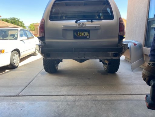

I’ve installed my ARB bull bar and the coastal Offroad rear bumper. I opted to save some cash and design and weld up my own swing arms/tire carrier. It’s rock solid with not noise or rattles. Used DOM tube with oil impregnated high strength bushings for the hinges, using 3/4” grade 8 bolts as the pivot.
